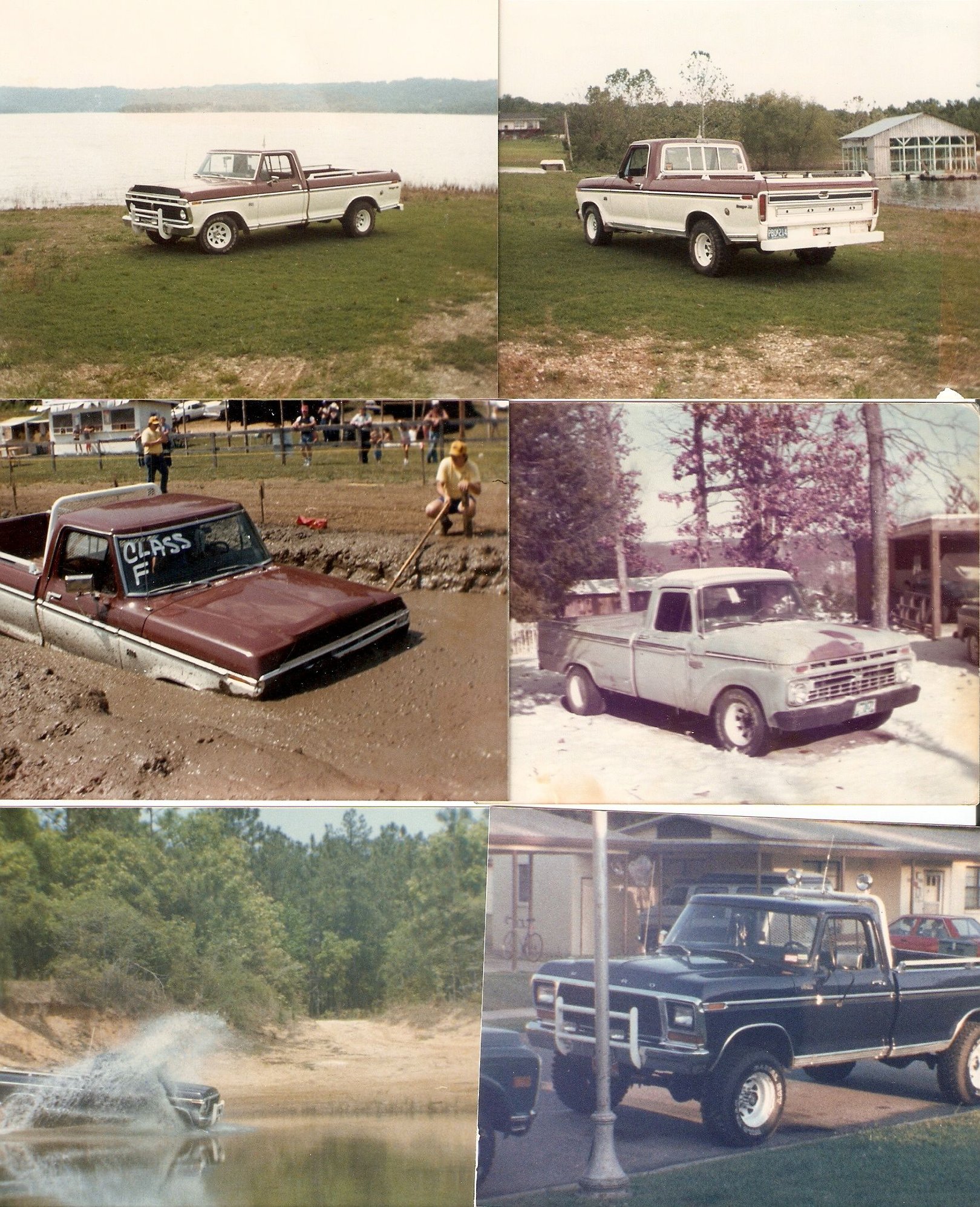

When I use to take the ol 73 2wd 6 cly 3 on the tree in the mud pit, I would put tall skinny's on the front and put in 2 sets of those twist in spacers and hammer down. Sorry for the photo conglomeration, I scanned those pictures that were taken with an actual camera.
