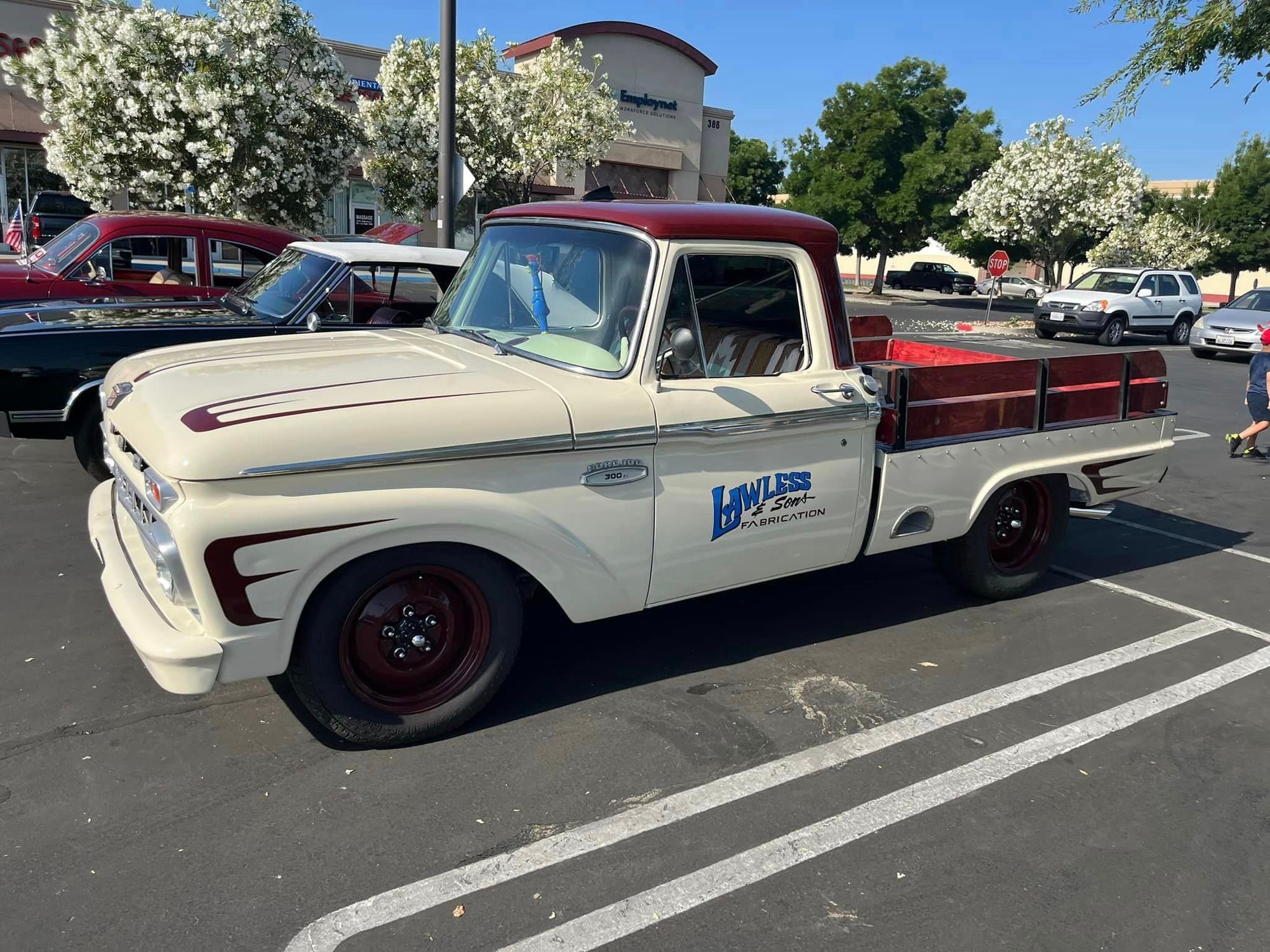

These are Wheel Vintiques 17 X 7 with 4" backspacing in front, 225/65 tires. Rears are 17 X 8 with 4" backspace and 255/65 tires. 4" drop all around, and disc brakes up front. The fronts fit perfect. Perfect size, perfect offset, at least for my tastes. I coulda went 17 X 9 in back, and maybe a 275 X 60 tire. There is a lot of room. I've seen people go 10" in back, and with the right offset, I think it would be OK. Most I've seen have too much offset to the outside and close really close to the fender lip or even stick out. I've also seen people with 8 inch wheels up front that stick out.
It's a matter of pleasing yourself. The photos can give you an idea of fit with these particular wheels. May not be your style, but it's an example

Thanks for the advice. That atleast gives me a starting point for my pickup. Kinda hard to figure out what will fit without trial and error. Your pickup looks sharp.
