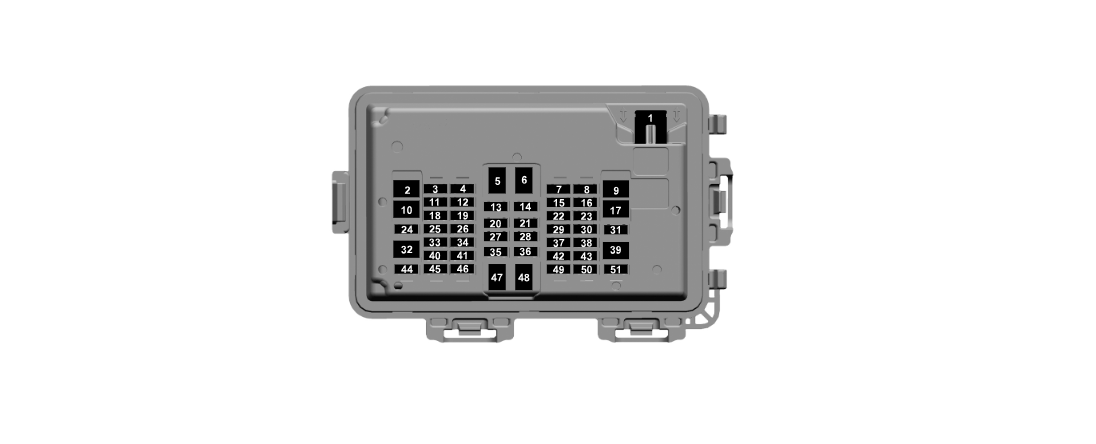

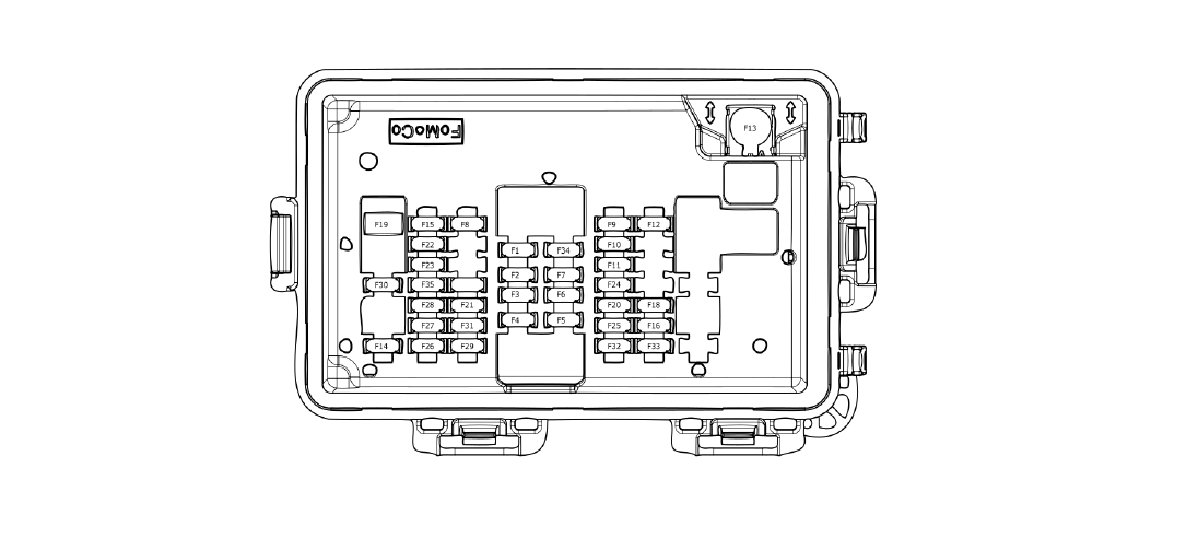

While trying to trace the user access wiring for the PTO wiring bundle, I found out that the fuse panel and the fuses shown in the owners manual (OM), both on the truck and online, did not match what is on the truck. I checked with my Ford service manual to verify that it was correct, which it is.
Here is what is in the OM
Here is the actual Panel
And none of the fuse #s are same.
This may be the same for 24 and 25. The under hood panel fuse numbers are also wrong.
