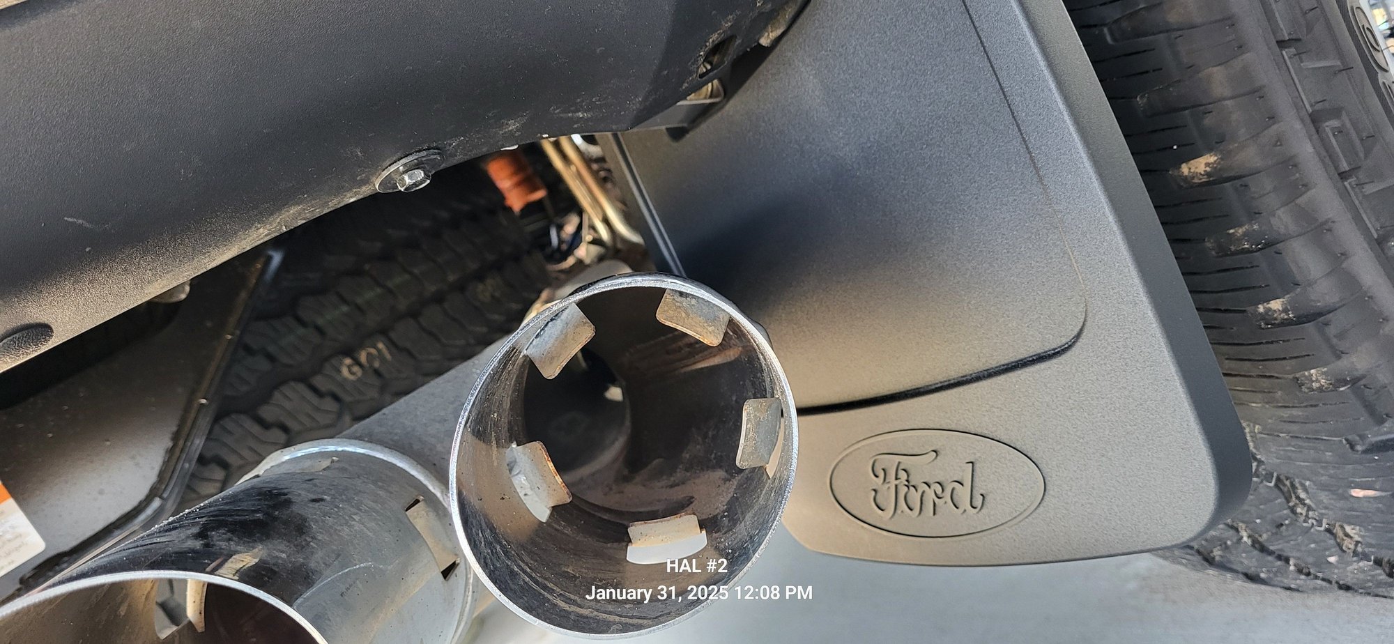

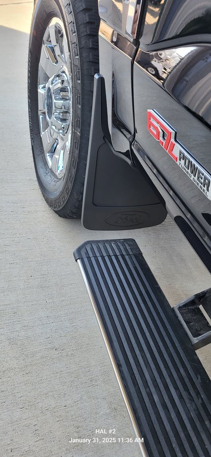

Easy addon....Ford splash guards
This is second set I have put on a f series
used to use weather techs etc
But these ford branded ones go on easy
Fit, study, yet flexible​
30 minutes Bing bang done

Those flaps are all I've used for several years on several trucks. Never an issue so far.

How do these install? Adhesive? Or screws or push pins, and if so into existing holes?
Pick up my first 250 tomorrow!
existing holes
Amd nut plates
The front get longer lower screws into nut plates already there and 2 fold over parts with a spring clip.
Easy
The rears come with push pins that are removable eith a small screw driver
and a stout bracket that connectes to truck amd inner part of flap
It also has ppm tape for the area the metal bracket touches.. it's stainless steel to.. I aslo use a 10/32 bolt and fat stainless washers on the metal straps attac point on the flap
mainly because the screw and nut plate included are sharp ...on backside
I use a thick rubber grommet on that contact area

Replace a couple screws on each and then push pins for the rest. Very simple to install and sturdy. The rears have a support bracket that goes on as well.

Yes, instructions in the package. No drilling. Remove and replace existing screws and push pins, as someone else stated.
No wheel removal required. For the front I just turn the wheels to make more room.

Unsurprisingly, those are same ones I had put on ordered truck. Can't remember what invoice was on that line item was (I paid invoice for the whole 2025 truck), but I'm pretty sure I got hosed. I am going to add a new hole to the rear's angle bracket to effectively make it shorter, pulling the inside edge away from the tire a little more. They look like they aren't square to the tire to me. Details, details...

they are square..there is a slot on the bracket thst attaches to the rear sheet metal..just for that adjustment
Also they are flexible, but not floppy
I have folded them in half on the other truck
Bounced right back, afyer log was moved
