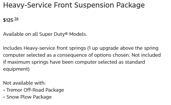

From what I was able to tell, the "camper package" consists of a heavier (+2 coil) front spring pack, a rear anti-sway bar, and a piece of paper.
When I was looking, I was having similar problems finding an F350 DRW with the camper package and the other 'features' I wanted - in my case, the XL package and 7.3L gas.
The one I did finally find didn't have the camper pkg, but it does have the "heavy service" package. Which consists of a +2 spring front spring pack... and DRW come standard with the rear anti sway bar. So all I'm missing is the slip of paper... 🤷🏼‍♂️
So maybe your dealer can find you one with *that* option package if they can't find one with the camper package.

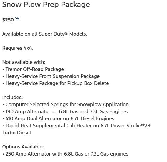

I ordered my SRW with the camper package because I'll never have another pickup truck without a rear sway bar. Since the DRW already comes with a rear sway bar - and I'm towing a trailer - I would not have added the camper package. For a slide-in camper, I would either get the camper package or plan to upgrade the front springs. Or, as @memilanuk said above, the heavy service package or even the snow plow prep.
