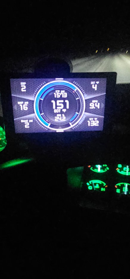

So I know there's a small boost leak from the uppipes waiting to have funds for RiffRaff set. My fuel mileage is garbage I also know winter blend can give MPGs a hit but I'm getting 10MPGA on q good day. Replaced fuel filter still no change. What could I be missing? Is the boost leak responsible?

How long does it sit and idle? Idling is effectively 0 MPG and is rarely factored into efficiency calculations.
Lots of people complain about crappy winter fuel economy and lots of people forget that they start their vehicles and let them run for 10+ minutes every morning before driving away.
Also, I wouldn't trust an aftermarket display for that calculation. The factory PCM doesn't have that data so however Edge programmed their device is going to affect that number.

I reset my tripometer everytime I fill up. I get about 400 miles out of both tanks. I know these can be off, but with the math its about right on. When its cold i let it run for about 15 20 minutes before driving off. When its warm I start it up let it run for about 5 10 minutes then take off. I kinda ignore the edge and just do the math myself. Just was for display demonstration purposes.
