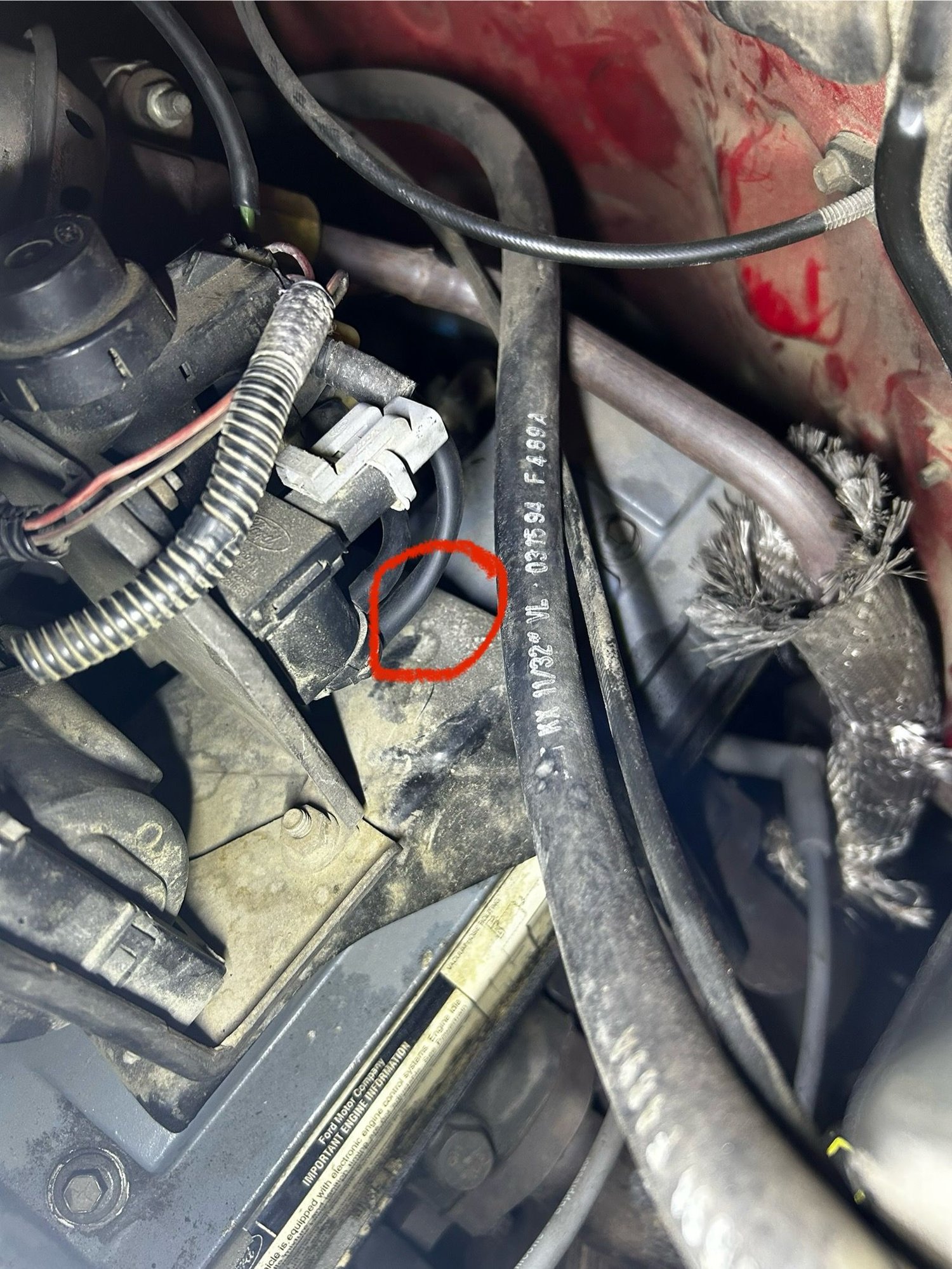

Hello. I recently replaced the vacuum lines on my 96 F350 7.5 since they were brittle and breaking. The truck seems to run and drive fine/no codes.
I was checking to make sure everything was still in place and performing properly. I noticed this one line was collapsed both engine running and off.
the original line was the hard plastic and I replaced it with rubber. Is it collapsing because of this or is there an underlying issue?

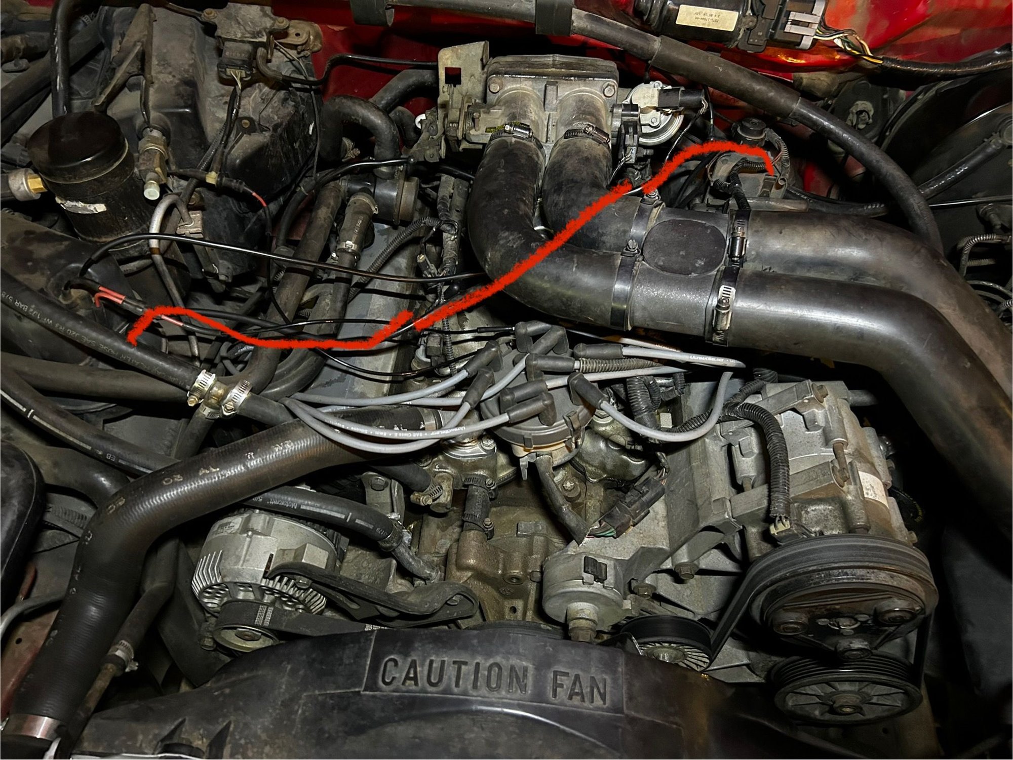

Not sure what this line is, so I highlighted it in red. It runs from the vacuum tree near the coil to vacuum reservoir? I believe.
Thank you

Ok thanks for the tip. So you think it’s an issue with the lines themselves rather than an issue somewhere else? That line in particular is much larger in diameter.

Another option is to remove this adapter, and connect the rubber line directly to the nipple on the vacuum reservoir. That would eliminate the piece that's kinking.
The purpose of the adapter is to maintain orientation of the vacuum lines.
The side marked "vac", is the outgoing connection to a vacuum solenoid.
The other side, sometimes marked "man", is the vacuum supply, from the manifold, to the reservoir.
There's a check valve inside the vacuum reservoir, behind the line coming from the manifold, to prevent variations in vacuum.
You can also make your own 90⁰ adapters if needed.

The older
The older "coffee can" reservoirs had the same adapter. The third post maintains orientation.
Since the reservoir is marked, you don't absolutely need the adapter.

Ok thanks I’ll get rid of the adapters. For what it’s worth, it’s not kinking, the hose itself is collapsing flat.
