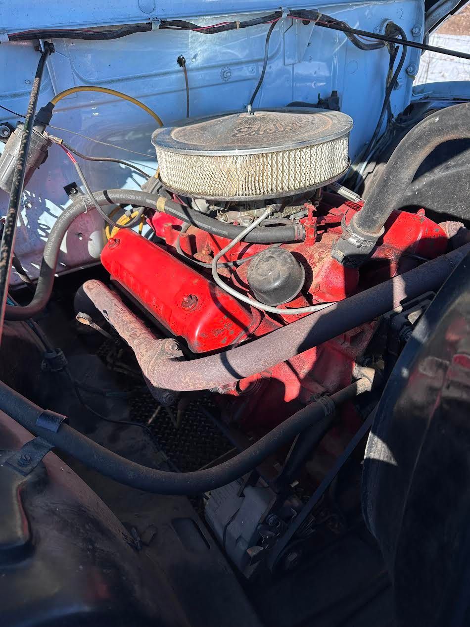

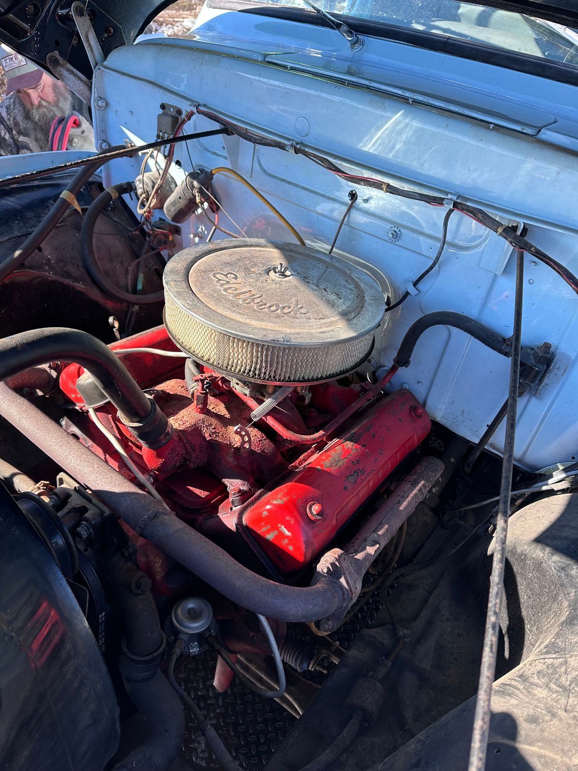

I am the proud new owner of a 1954 F600 as of today, actually about 6 hours ago. While it looks quite beautiful and has no major body or frame issues, it has things I am calling concerns. HA. I am not really prepared to ask all the questions I have, but more of an overview at this point, learn some tips and pointers, what to look for, what to avoid, etc. Be gentle, I am not only new to the forum but also new a lot of things with this truck. To start with I got rid of a 2023 Ram 3500 DRW (I know, I know, I know) and the list of problems right out of the gate were atrocious. Plus I needed a computer engineering degree to diagnose and fix anything, that's if it wasn't locked by the manufacturer. But I digress
The details; 1954 F600, 292 Y Block, 84,xxx original miles, Eaton 2 speed axle, literally a true barn find

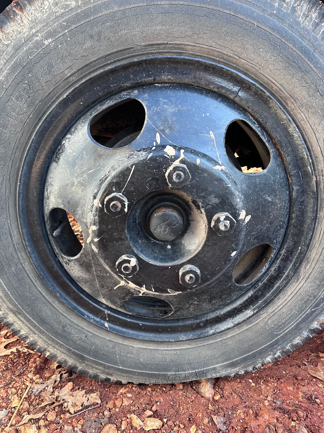

Aside from your steering problems, you also have the dreaded Firestone RH-5 true Widowmaker rims. While many unwittingly and incorrectly apply the "widowmaker" moniker to any multi-piece rim, the Firestone RH-5 is the actual real widowmaker and should be taken seriously.
RH-5 rims can fail catastrophically and split at any time, either when manipulated for service, by road conditions, or even just sitting static unprovoked due to the nature of their design.let us be reminded that OSHA, Firestone, the NHTSA, and various state bodies (such as Utah) looked at recalls/bans in the 80's and determined that the effort was ultimately unwarranted, not because there wasn't a deserving safety issue, but that because since the introduction of single piece rims decades earlier coupled with the estimated service life of 10-15 years, the remaining population was insignificant and declining and essentially self-regulated out of existence. Yes, as always, there were politics involved as well. This leaves us hobbyist to watch out for each other.
*New tires don't make RH-5 rims safe to use.
*Using a cage, chain, or whatever doesn't make RH-5 rims safe to use.
*Inspection for rust/defects does not make RH-5 rims safe to use.
*Finding a shop that will assemble RH-5 rims does not make them safe to use.
You don't want to get yourself or others injured and face any potential lawsuits that would follow.

I doubt you have the 292 Yblock unless it was put in later by someone. In 54 F600's got 239 engines. Your engine is painted the correct color for 54, red. You said you want to upgrade the valve colors? They are fine. All you need is new gaskets and to paint them the correct Argent silver and maybe put 1954 decals on.
The shaking at 45 mph? Could be a bent or crooked wheel, out of balance tire or a front end alignment is needed. But first get safe wheels like bmoran explained.
My 54 239 Yblock with oil bath air cleaner.
Side note: your heater hose is in the correct position, a long the firewall and then across the top of the manifold. But someone put your coil on the firewall.....

"I doubt you have the 292 Yblock unless it was put in later by someone." -- oh wow, no kidding. I will look at that immediately of course. It makes more sense as I was blindly believing the seller. Thank you for that

Well now I am just beyond confused. Took My Boy Blue over to the local tire shop and he says they are NOT widowmakers. He says they are lock split rings. I'd like to believe the guy but after reading all the posts on here about the widomakers, I also believe them. Thoughts? Comments? Suggestions?
Raised ridge suggests a RH5
No raised ridge
No raised ridge
See the split in the upper right
