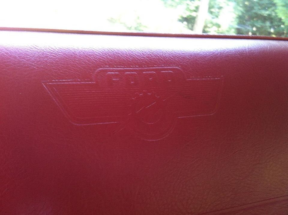

Would look like this but in a beige color. Light beige crush vinyl and medium beige ladder pattern woven plastic.
Not F100 but they had a FORD logo with gear and lightning bolt like this. SMS that iBuzzard mentioned can also emboss the logo in the material.
