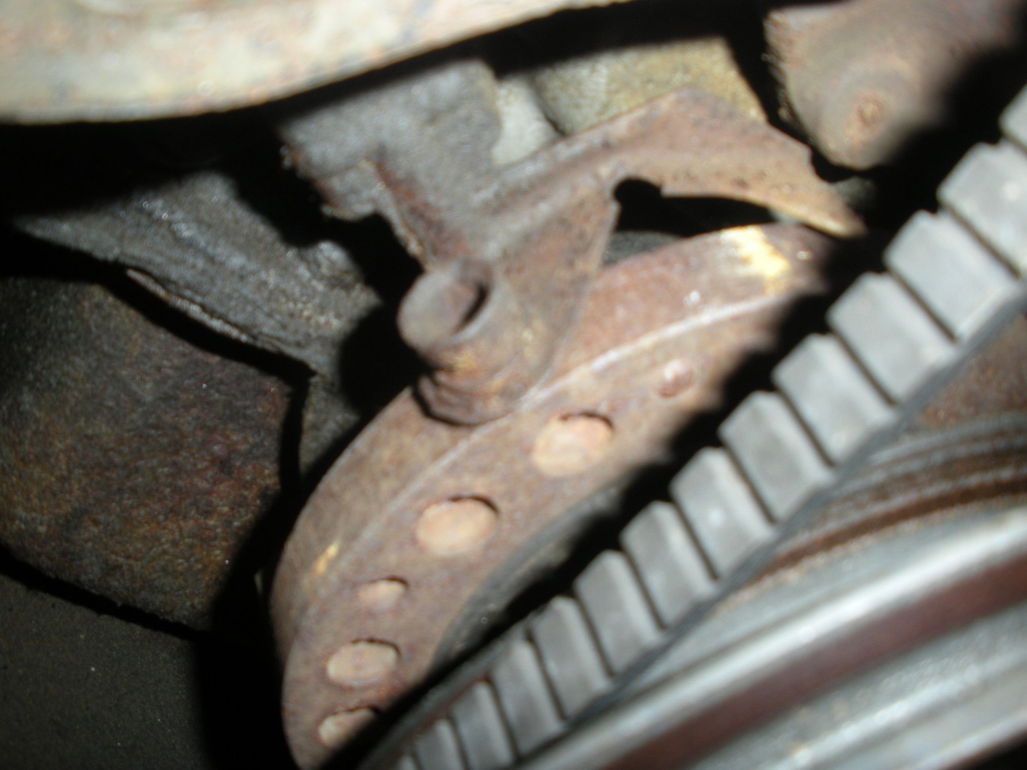

You should have something like this, do you have any parts in a box somewhere ?

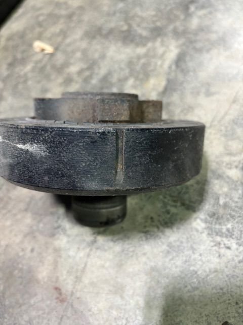

The grove shown in the picture above? That is not a timing mark. The timing marks will have several hash marks to set the degrees before and after TDC.
That's the crank shaft index. TDC #1. The timing marks are on the engine showing degrees. On the plate above the crank. Looks like the numbers are not visible.

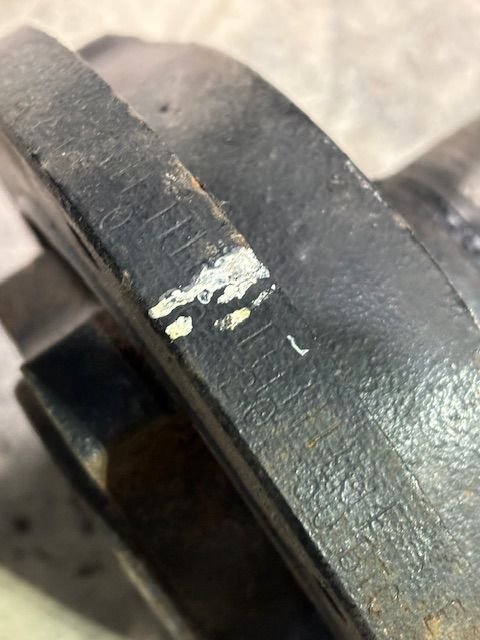

Not on my balancers.

Kind of my point was, hoping the OP would show us what he's working with, as we realize things are different for different engines and years. Mine is an 86 302EFI. I just grabbed a photo that I took some time ago. In the 30 odd years, I've owned the truck, I have not put a timing light on it. The trusted mechanic did some years ago when he replaced the dizzy.
There you go. All the Fords I have have marks engraved in the balancer. Like the picture above, you have to clean them up with sandpaper to see them. I use white-out to mark about 10 BTDC so I can easily see it with the timing light later. You should have a single pointer on the engine. Not saying they never did it, but all my Fords don't have a scale on the engine, only 1 pointer on the engine.

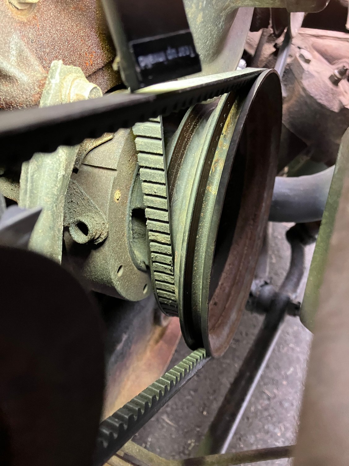

Originally Posted by Akumothesaiyan
Thanks I'll look for those but what do they line up to? Only thing I could think of is a singular arrow at 12 o'clock on my timing cover
That's it. If you have a piece of metal hanging near the damper, that is what you align the marks to.
Here's a good picture what they usually look like.
I don't have that piece of metal on it though just a mark at 12 o'clock above the balancer on the timing cover
