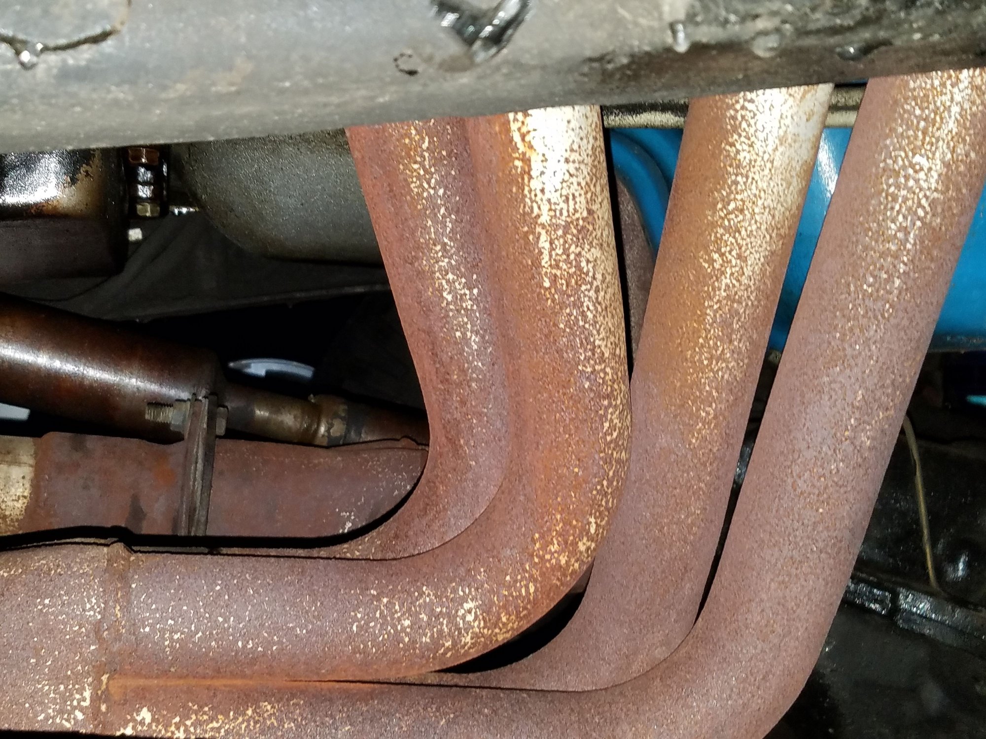

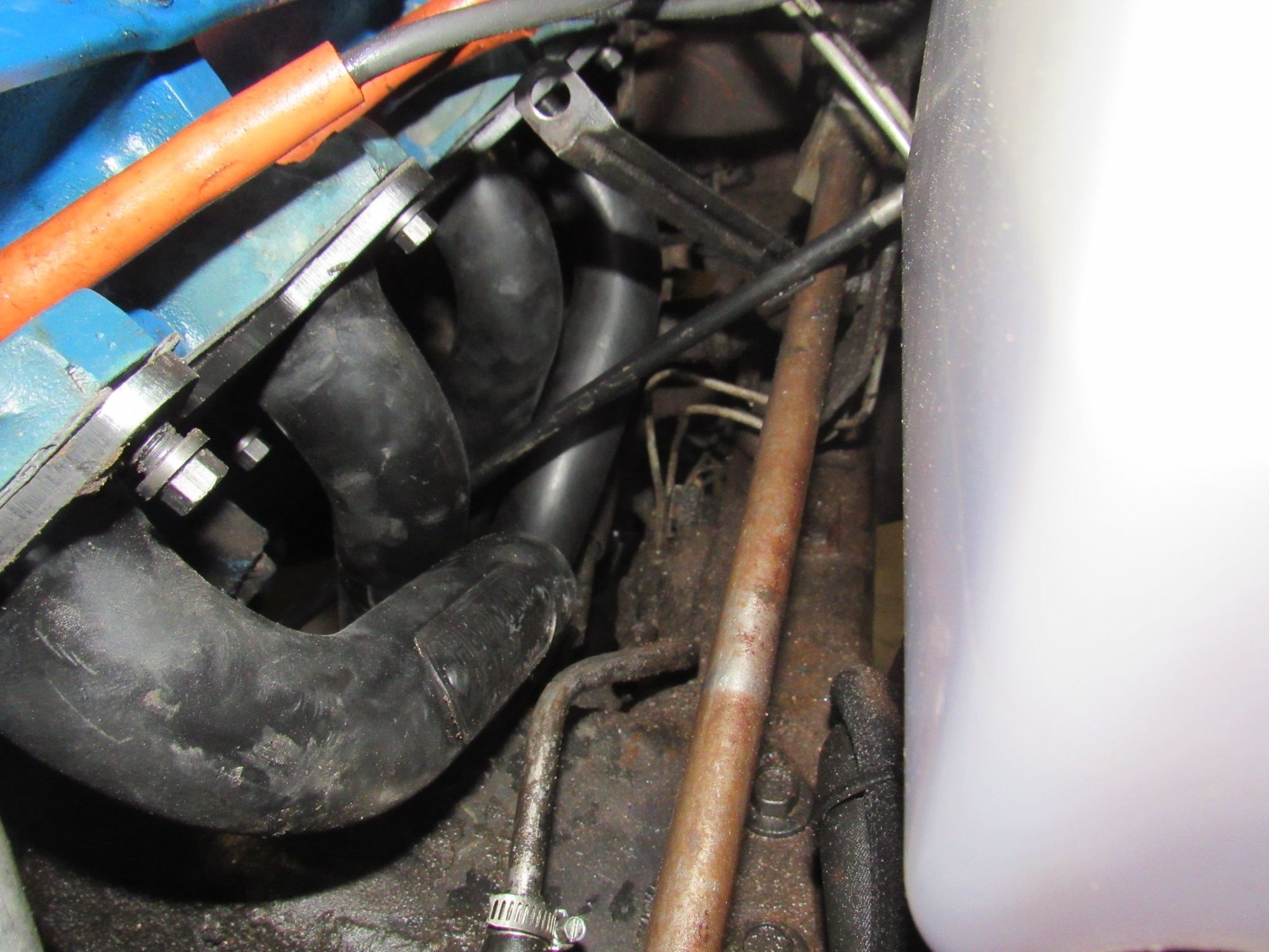

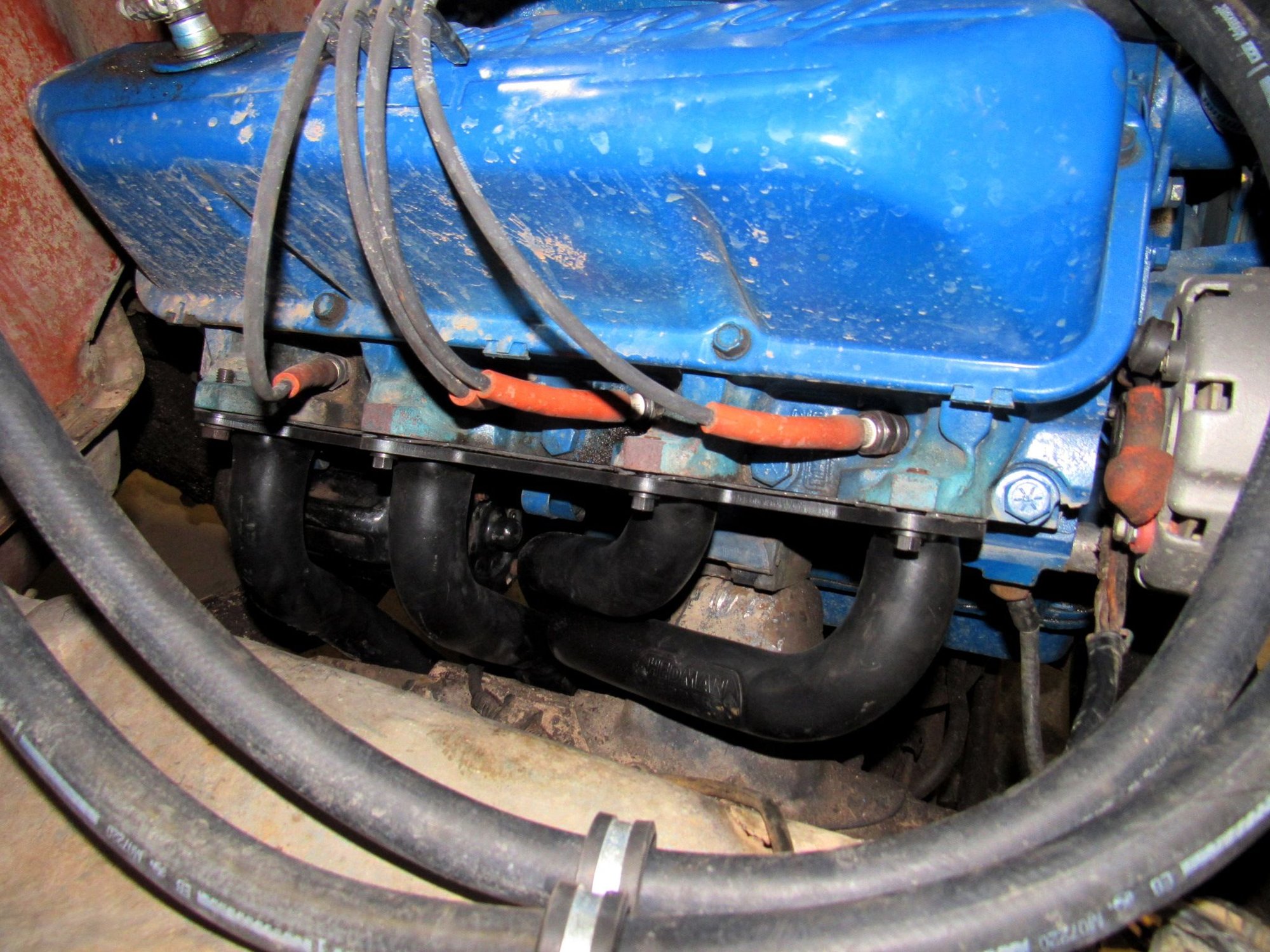

I put Hedman Hedders on my '72, 79 and my 1976.
These pictures are my '76. If both factory exhaust manifolds were like the left one, bottom I doubt that I would have bought the hedders.
The hedders suck because it has to come off to get the starter off.
I don't paint mine and I would never waste my time wrapping them.
I have no doubt that at some point in time they'll rust out anyway.
I replaced the fenderwell hedders on my '79 I think only once in 200,000+ miles.

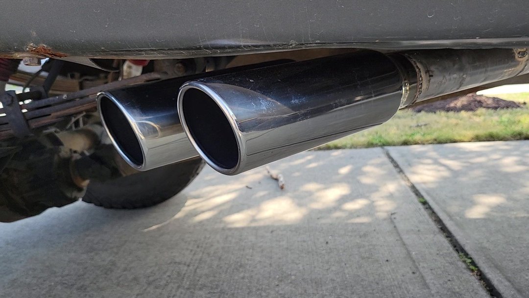

I went with Hedman fenderwell exit headers after I discovered my stock manifolds were heavily pitted. Went the easy route and bolted on some glass pack resonators and stainless turn down tips. Exits about a foot in front of the rear cab corner
Any chance youve got a photo of it under the truck and a video of how it sounds? This honestly seems like a super easy solution and not bad of an idea

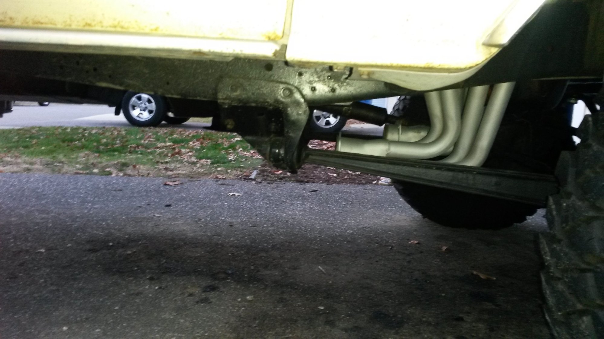

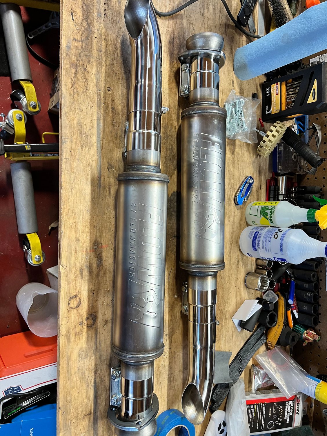

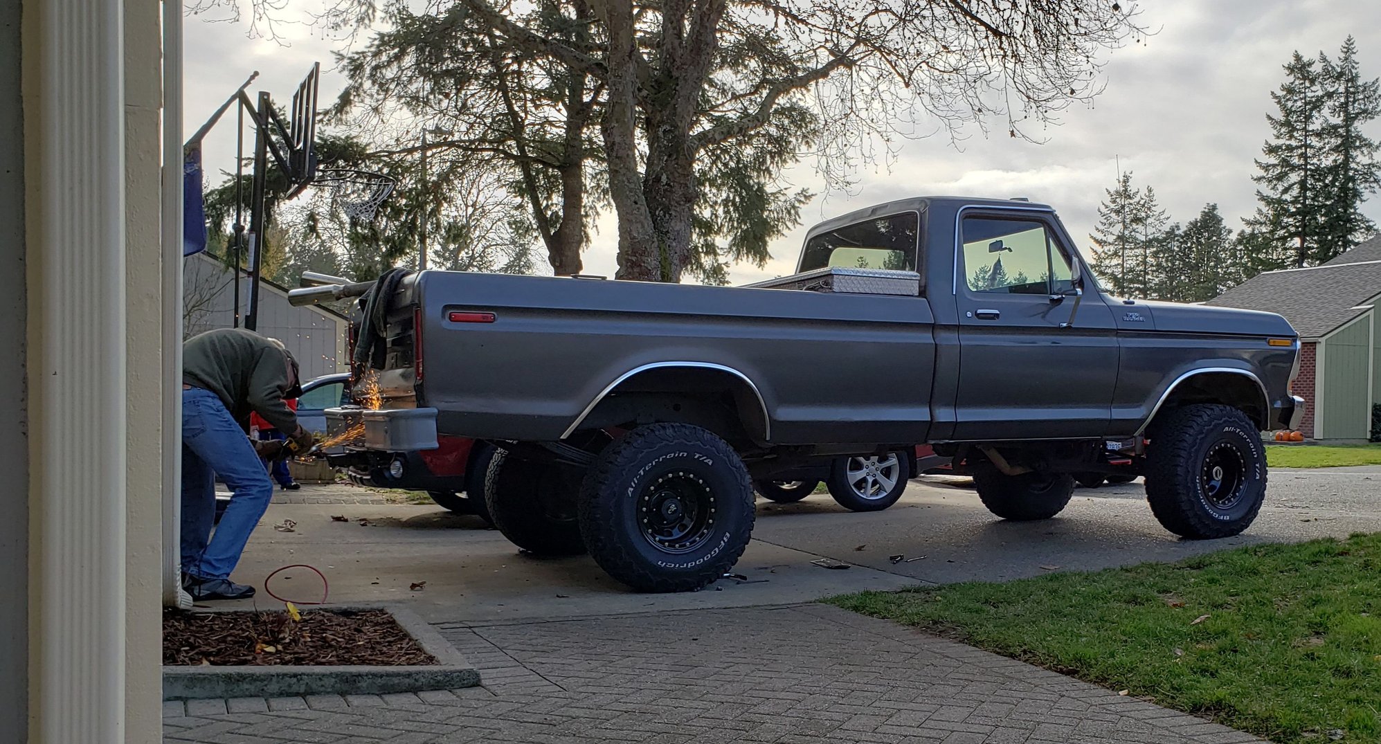

1978 F150 4x4 with two tanks. This is my experience and advice when it comes to exhaust.

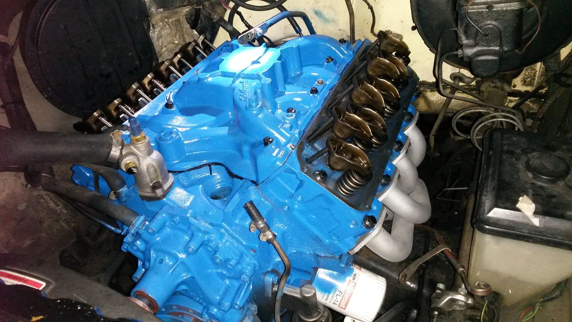

Before I repainted my truck in 2016, I rebuilt the top-end of my engine, and I installed a set of Hedman headers (inside the frame). I sandblasted them and used POR15 High Temp Exhaust paint on them before install. I was able to use a large powder-coating oven to bake them as required. After I had the truck running, I drove it, open headers, about five blocks to a muffler shop. Sounded like a NASCAR with that lopey cam at the time. I brought the tips and mufflers with me. They charged around $500 for the pipe and labor, tips out the back under rear bumper.
The headers hung lower than I like. Literally even with my radius arms with a 4" lift. And as you can see, the outlets were staggered. Drove me nuts.

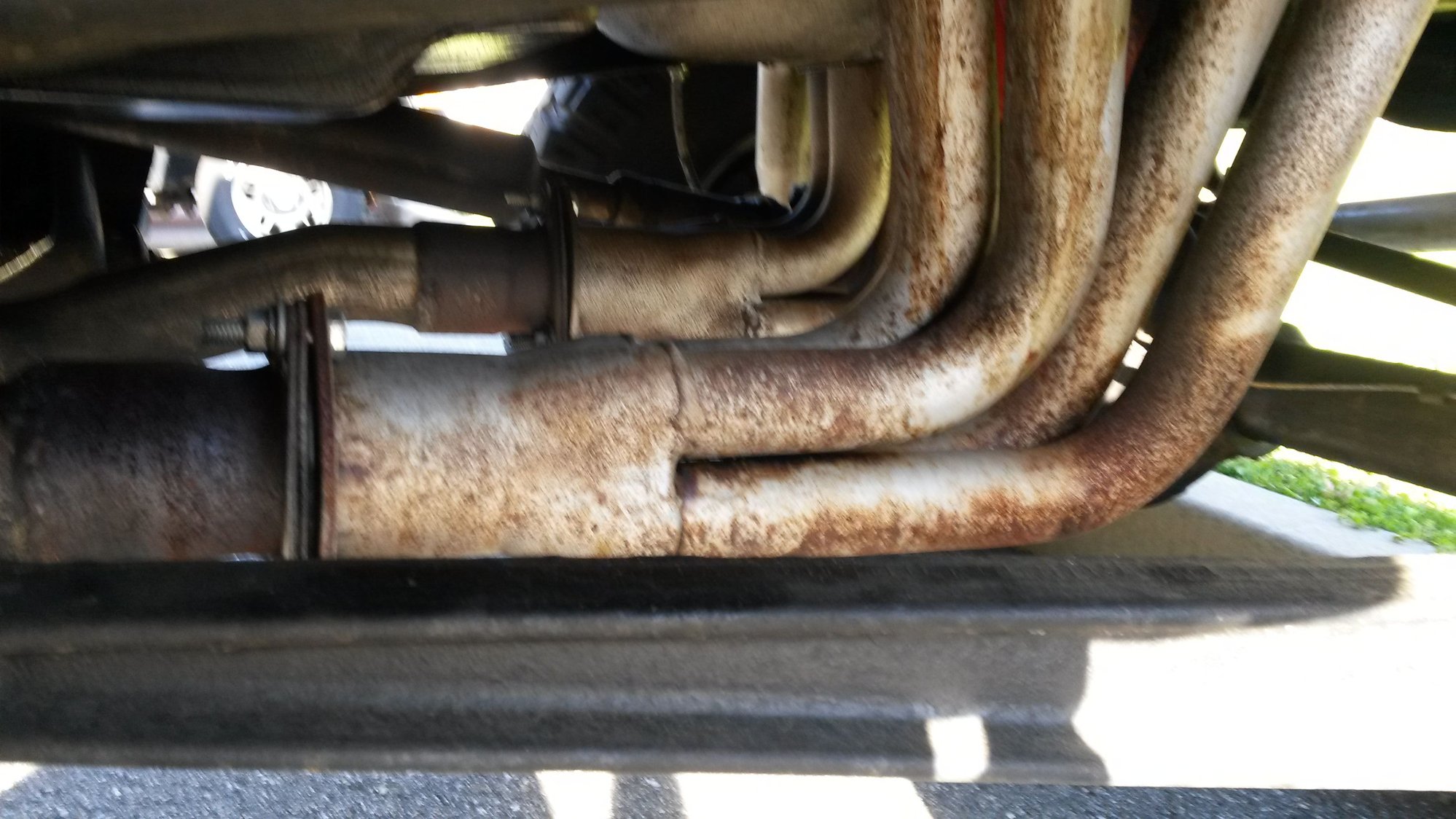

Headers after six months.
Headers after less than three years. Living in CT winters wreak havoc on our trucks. They rusted so bad they were leaking at the collector, not the pipe connection.
The hangers for the tips would break off and I would have to reweld them up one too many times. Until I got sick of it and kept shortening my exhaust and patching the rust holes, I gave up on that exhaust eventually.
I happily went back to manifolds, bought a Walker Y-pipe from manifolds to back of cab. I bought a FlowMX muffler (one in, two out) and reused the old tips and made the rest of what I have now. I am pretty happy with it. No leaks, holding strong, and sounds good. And to agree with Rubi, they can get loud if the right foot gets heavy.
After going from manifolds, to headers, back to manifolds, I had not noticed ANY increase in horsepower or gas mileage. The only thing I did notice was the inside cab noise was quieter with manifolds and the headers radiated heat into the cab in the summer. In my opinion, headers aren't worth it in those trucks unless you are building a race truck. Stick with you manifolds and get a nice MagnaFlow mufflers or 24 inch glasspacks and run the pipes just behind the rear tires. If you do decide to get headers, I have read on numerous forums that the exhaust wrap will hold moisture from the rain, snow, and ever car wash and that causes pipe distortion and rapid rust.
I’m planning on adding some rubber isolators near the tip for some more support. This is cold start before the choke was fully open.

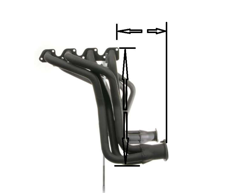

You say you have these summit racing headers sitting in your garage waiting to be installed... Any chance you could grab me some measurements so I could see how they will kinda fit in the truck?
The 2 id love starts from the rear top exhaust bolt. Id like to know how far they dip down and how far out they go. I worry about not having enough room with the transmission cross member.

Tyler, those look exactly like the headers I had. Look at post 23, second picture. They hang pretty low. I've seen exhaust pipe go over the crossmember (tightly) and under it. Hopefully your exhaust guy is better than mine was. Spend the extra money and get the stainless pipes, not the aluminized junk.
