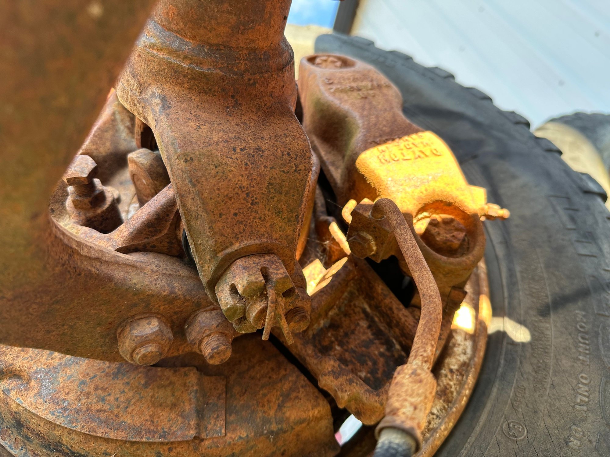

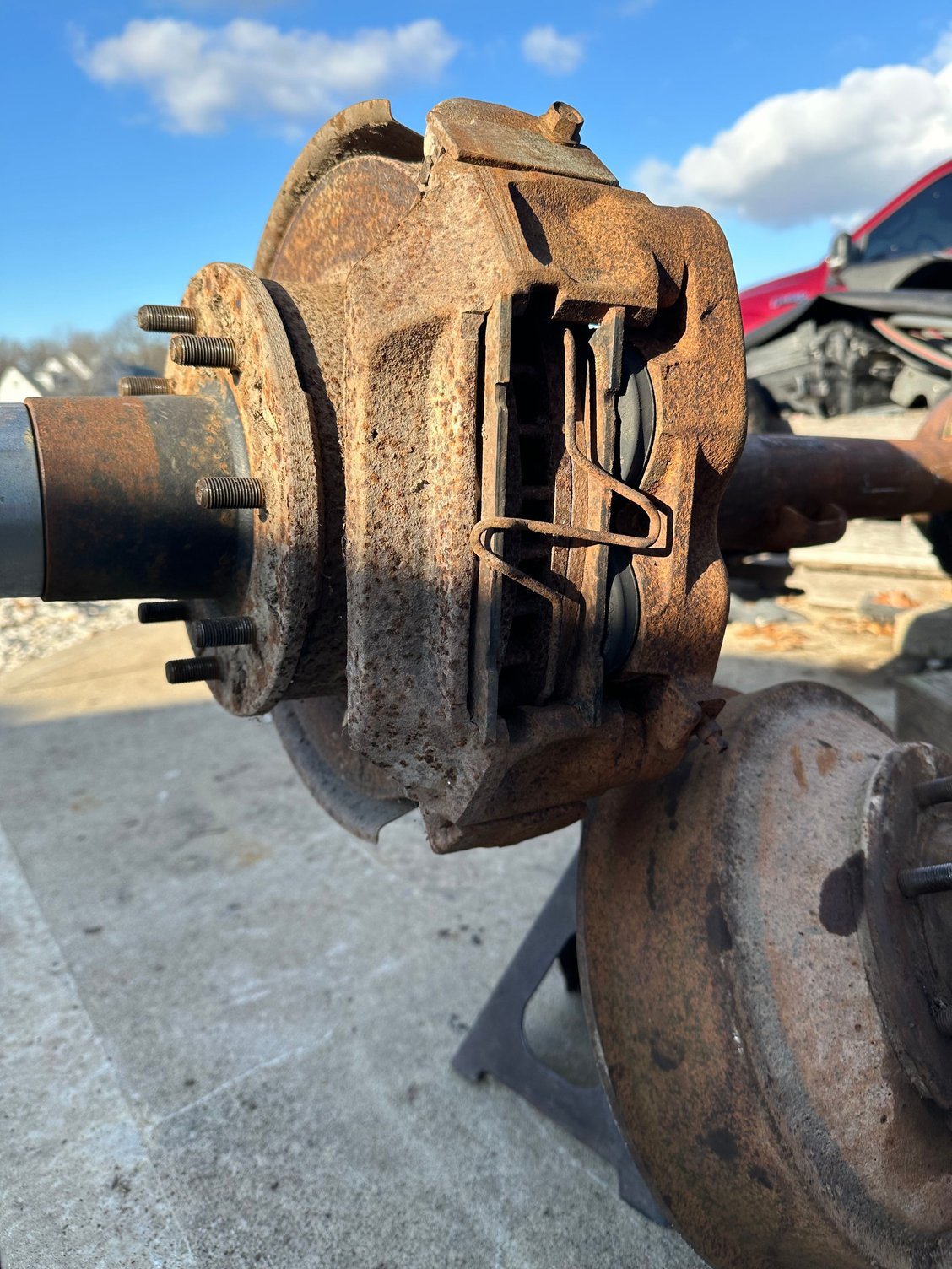

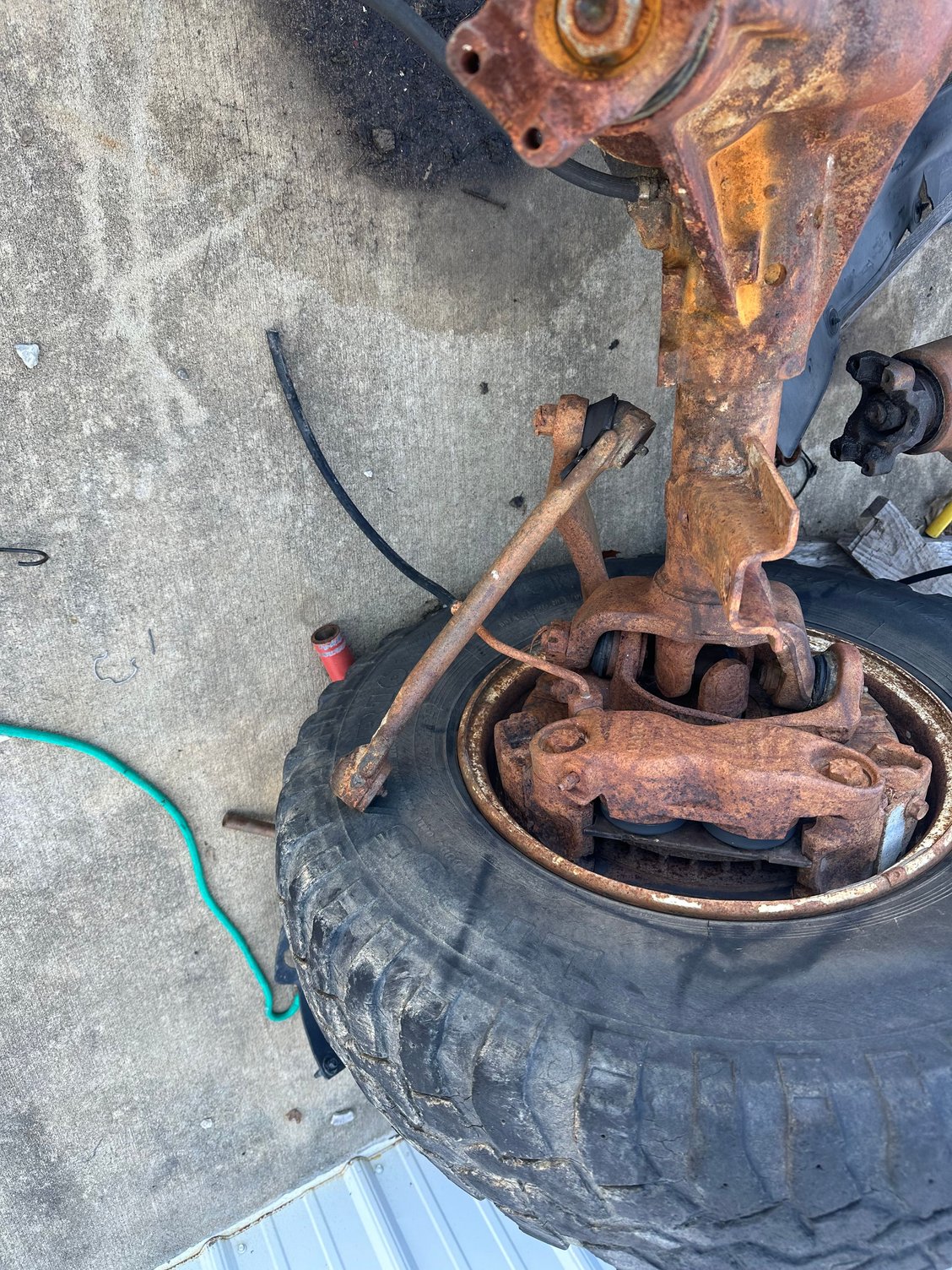

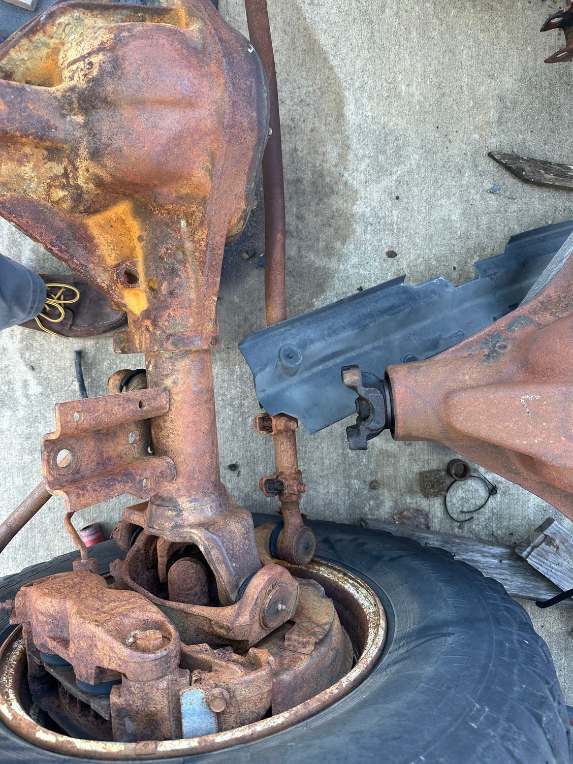

these are the pictures I have right now that were in the day light how you can see what you need to.

Thanks. Shows ball-joints (as expected) and what I think are the normal "internal" type locking hubs, and appear to be the larger variety. Hard to tell for certain with just an edge shot, but that's what it looks like for not.
Looks rough, but sure looks complete! I'll see if I can get some part numbers for you, from the inner u-joints out.
But again, I would not necessarily replace the lockouts with something from the aftermarket. The factory stuff was generally stronger. So as long as grease was kept in the hub, and not too much moisture got inside, the locking mechanism may just need some cleaning and re-greasing. Doesn't hurt to have new bearings of course, since you don't know the maintenance history of the axle. If maintained well, they can last the life of the truck!
