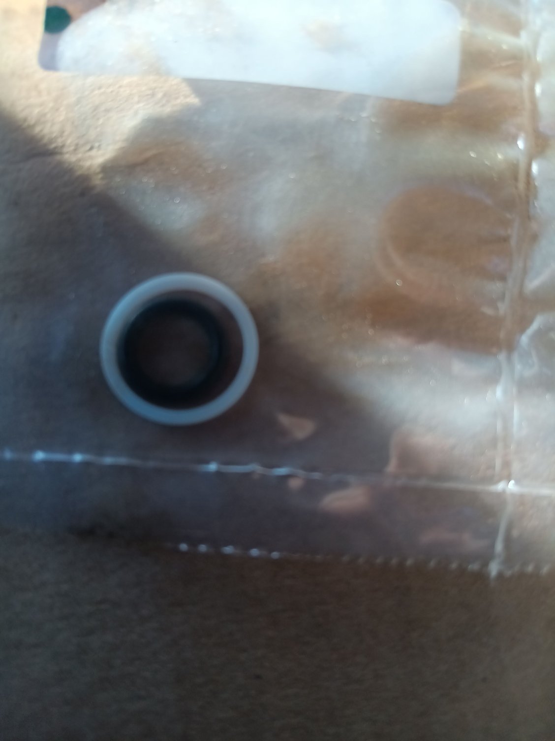

So when I got a new pump it has these 2 orings one Teflon and 1 small rubber oring where do they go?

I'm not certain but those might be for the line that connects on the side near the frame rail. the line with the 90. I didn't think that fitting was serviceable though

me either and it had come already installed into the side of the pump also I'm thinking maybe they are for the hose with the 90 going into the side your talking about if a used hose was being reused but I replaced that hose also at the same time........ and now my speedometer will only go up to about 40 mph reading even if I'm going faster it won't go higher I assume it's the speed sensor that's in the rear diff needing to be changed?
