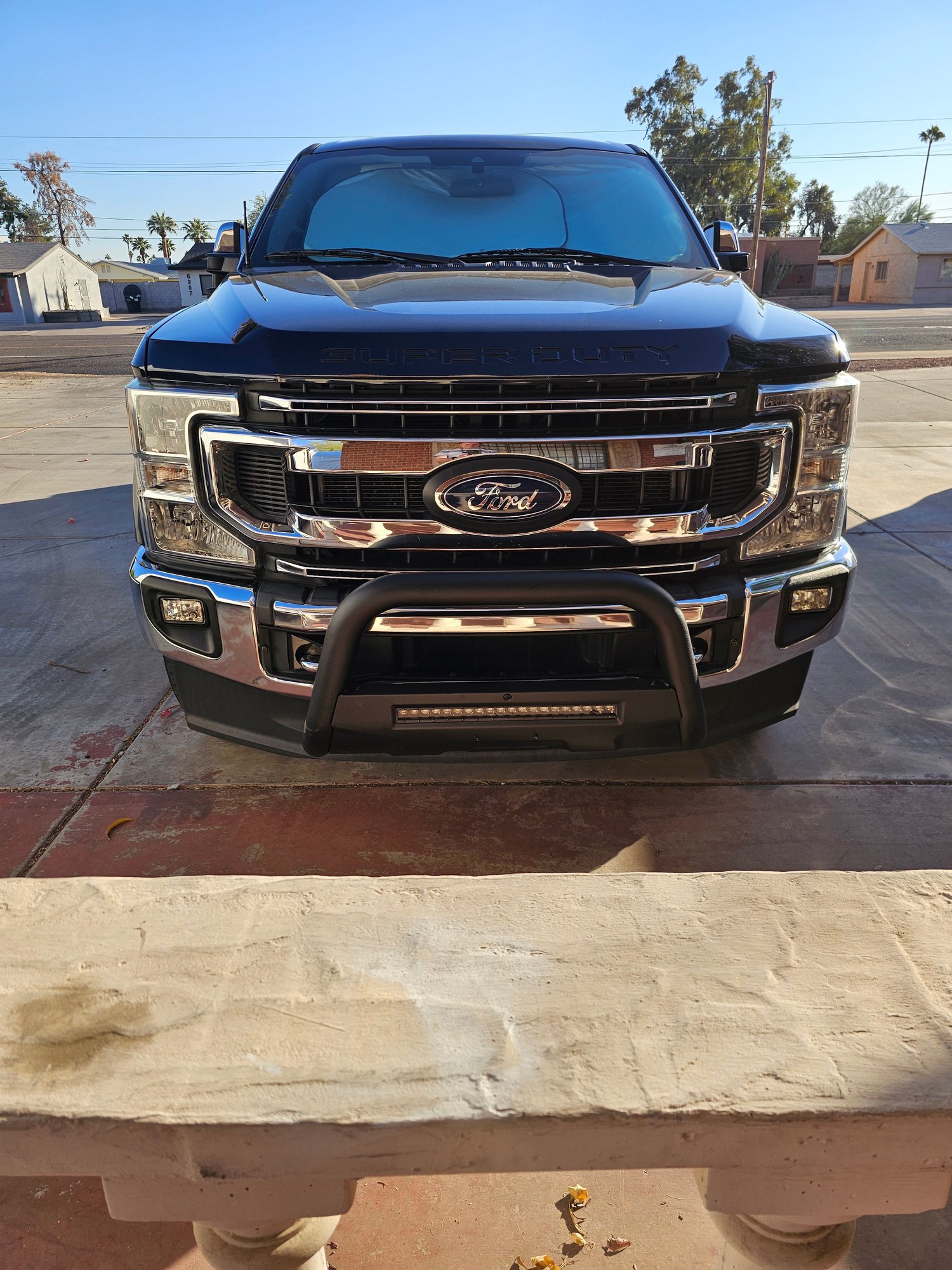

Very interesting read Heavy. I just received the Ford letter this evening after work. I have a 2021F250 6.7L and figured it was coming. I've got about 61k on her and I'm very OCD on maintenance. Draining the fuel water seperator at every oil change and fuel filters at 20k. I've used Howes Diesel Treatment every fill up since I bought it used with 27k. Truck runs absolutely great. FX4 with 3:31 gear set and mileage is very good. 17.5- 18mpg in town and 23+mpg highway.
Its my daily driver after selling my 2014 F150 Ecoboost.
This frickin CP4 Pump thing is like Russian Roulette apparently. Truck runs great, but Its like wait do the Ford Warranty Recalibration Recall or bite the bullet and go aftermarket before it grenades?
Of course this truck like ALL the vehicles I've ever owned NEVER stay stock.
Truck is a Beast. I'm a big fan of Fords and now diesels as this is my first.

Originally Posted by meaz93
<snip>I've got about 61k on her and I'm very OCD on maintenance. <snip>Truck runs great, but Its like wait do the Ford Warranty Recalibration Recall or bite the bullet and go aftermarket before it grenades?
Whoa, thought I was looking at a picture of mine! Less the bull bar.
I didn't want to play roulette, so I had the S&S DCR installed around 68K. Since everything was opened up to do that job I also had the SPE heater inlet tube kit installed at the same time.
