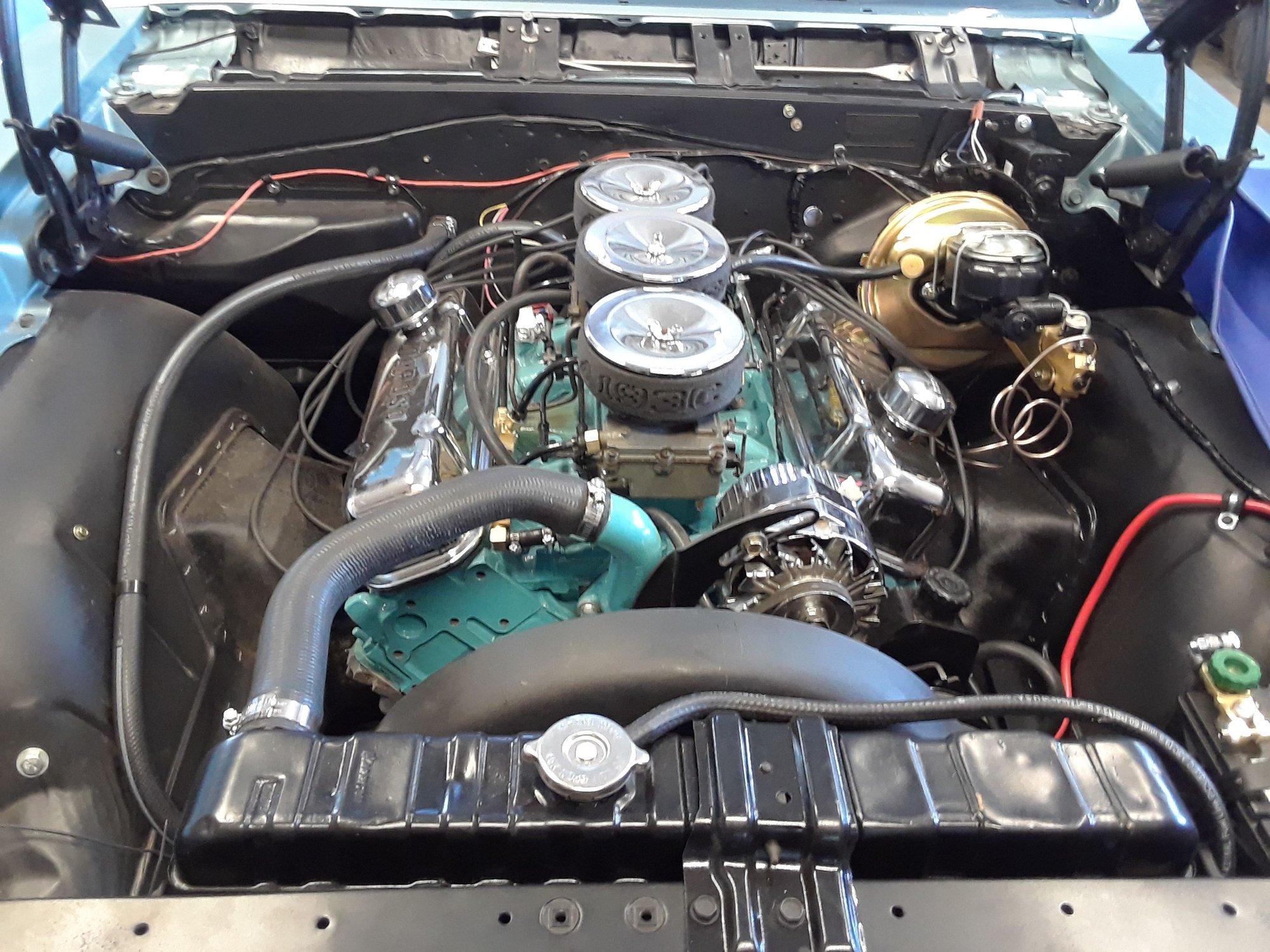

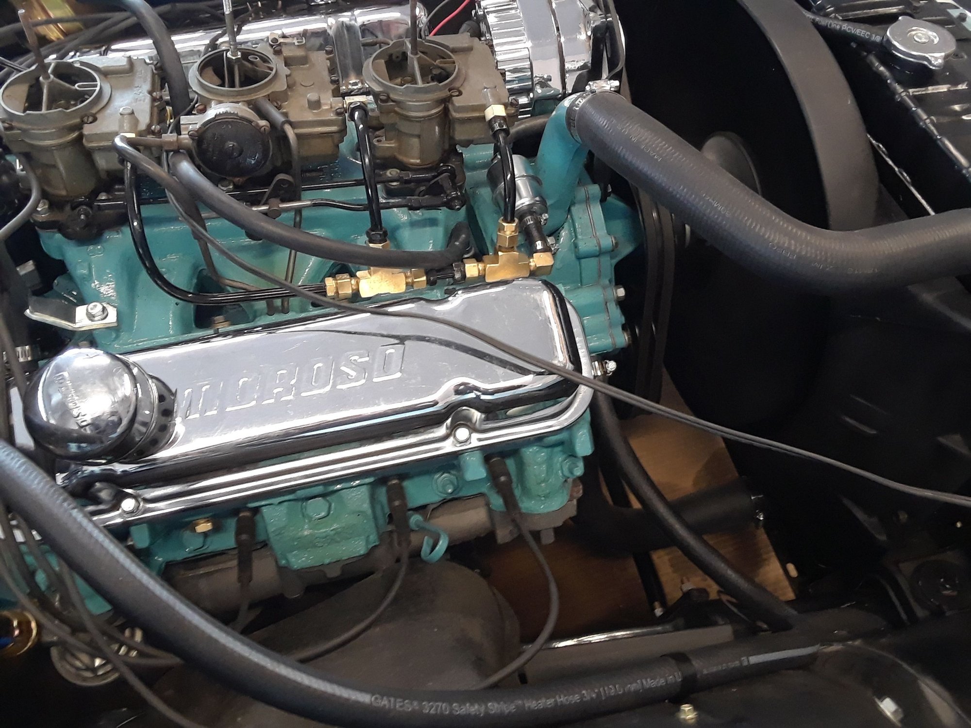

here'
s a few of a poncho to compair

Thanks for sharing this with me Charlie. My truck is parked outside and we’ve had some bad weather over the last couple of months so, my projects been on hold. it does look very similar. Certainly the alternator and power steering pump set up is like mine, I am surprised as it does have an odd / unconventional appearance to it , I figured it was a boge job .The top radiator hose engine outlet is different to my engine , also the intake manifold is different. Mine has an Edelbrock manifold, Tomorrow morning I will take the pictures out with me and compare them. Since posting this I have found out that the the gearbox is a gm th400 . I’ve also ordered a book on Pontiac engines that hopefully will enable me to decipher what it is. When I was working on it last , I found that the distributor was only loosely placed in its seating and not set in place, the ht leads were tie gripped together but not in the cap for some reason ? So I don’t know what engine it is or the firing order , which is cylinder one or where the rotor sits for TDC cylinder one. Hopefully the book that I’ve ordered will take me in the right direction . Thanks for taking the time out for me , it’s much appreciated 👍

i posted the shots to give you a comparison to work with as to what the outside looks like, to me. yes the guys are correct it's a poncho and they did make a 350 aka 5.7, they also made a 326 that was common in the early empests/firebirds than 389.400.421, 455 which one you have will be fun to figure out as they all look alike
