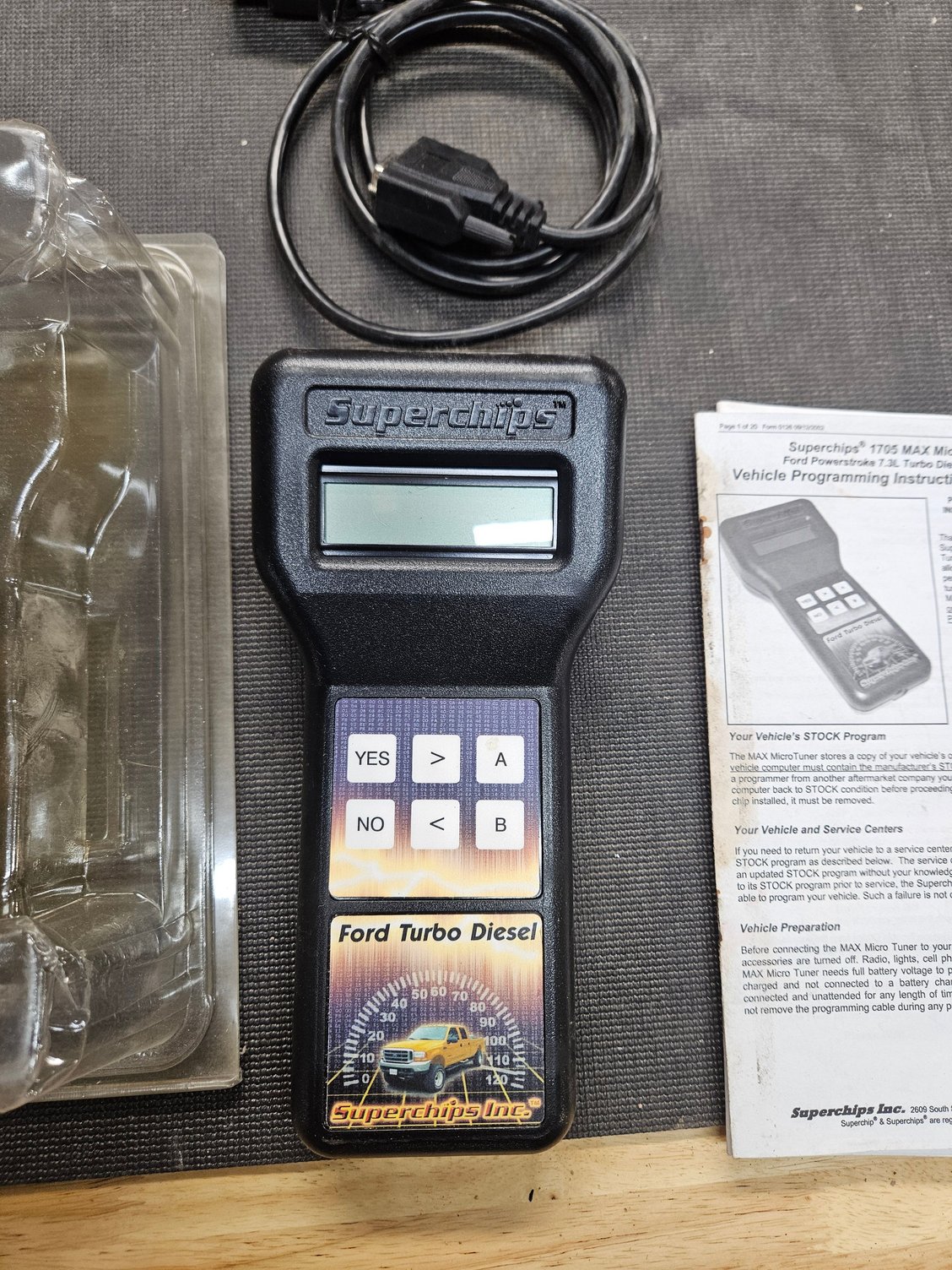

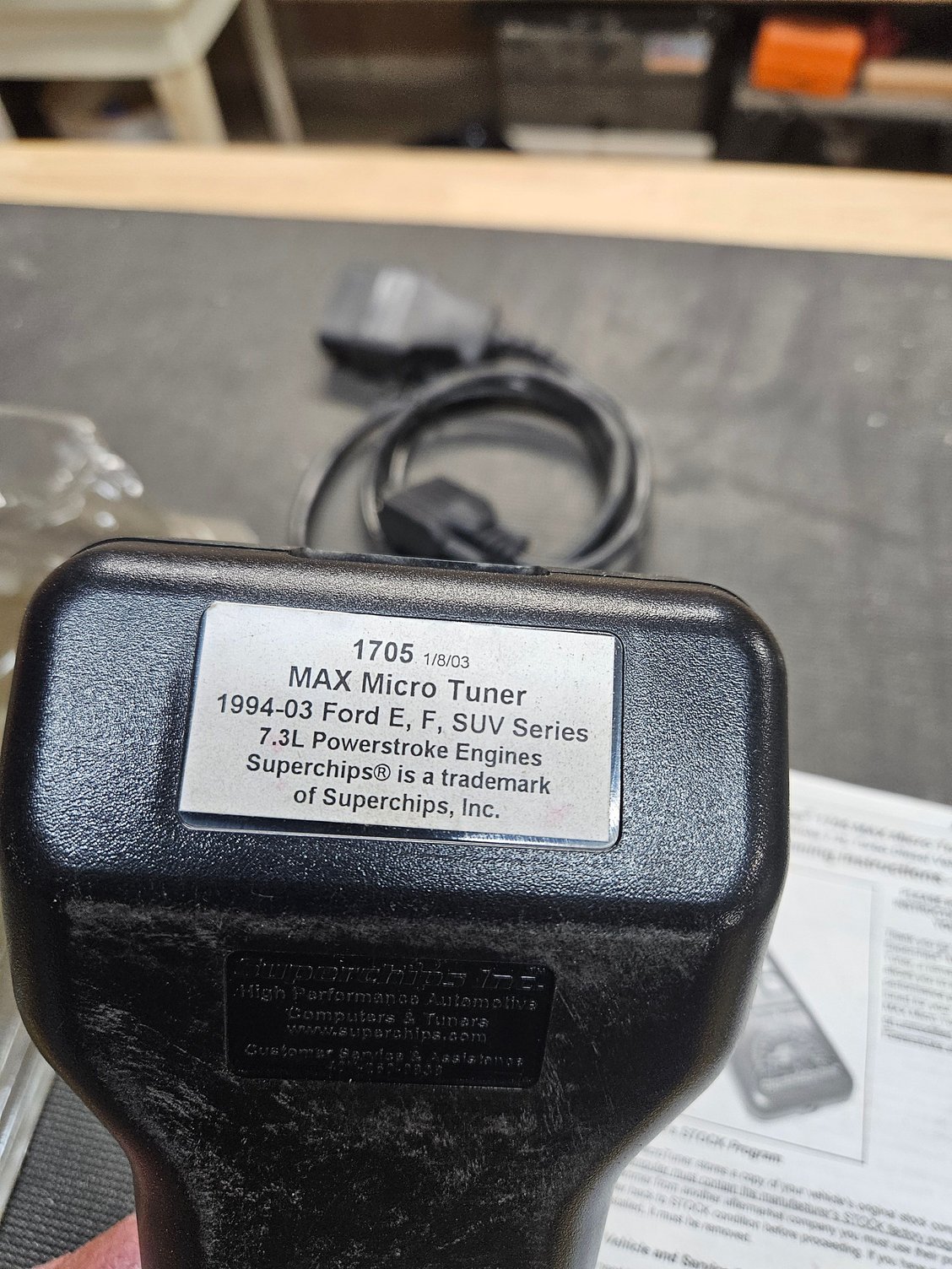

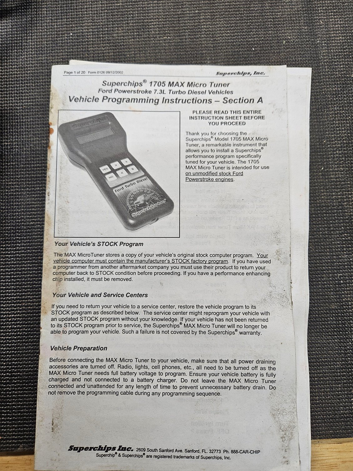

If you are still interested contact me. I have one that I used on my '97. It is original condition not VIN locked.
Sold the truck a while back to a fellow who didn't want a tuner program so it was reset to stock and the tuner went into the basement. Reorganizing recently and realized I still had it.
It needs to go to someone who can use it and I tried to list it on Ebay but they won't allow stating that it could be used to defeat emission controls, like they really cared.
