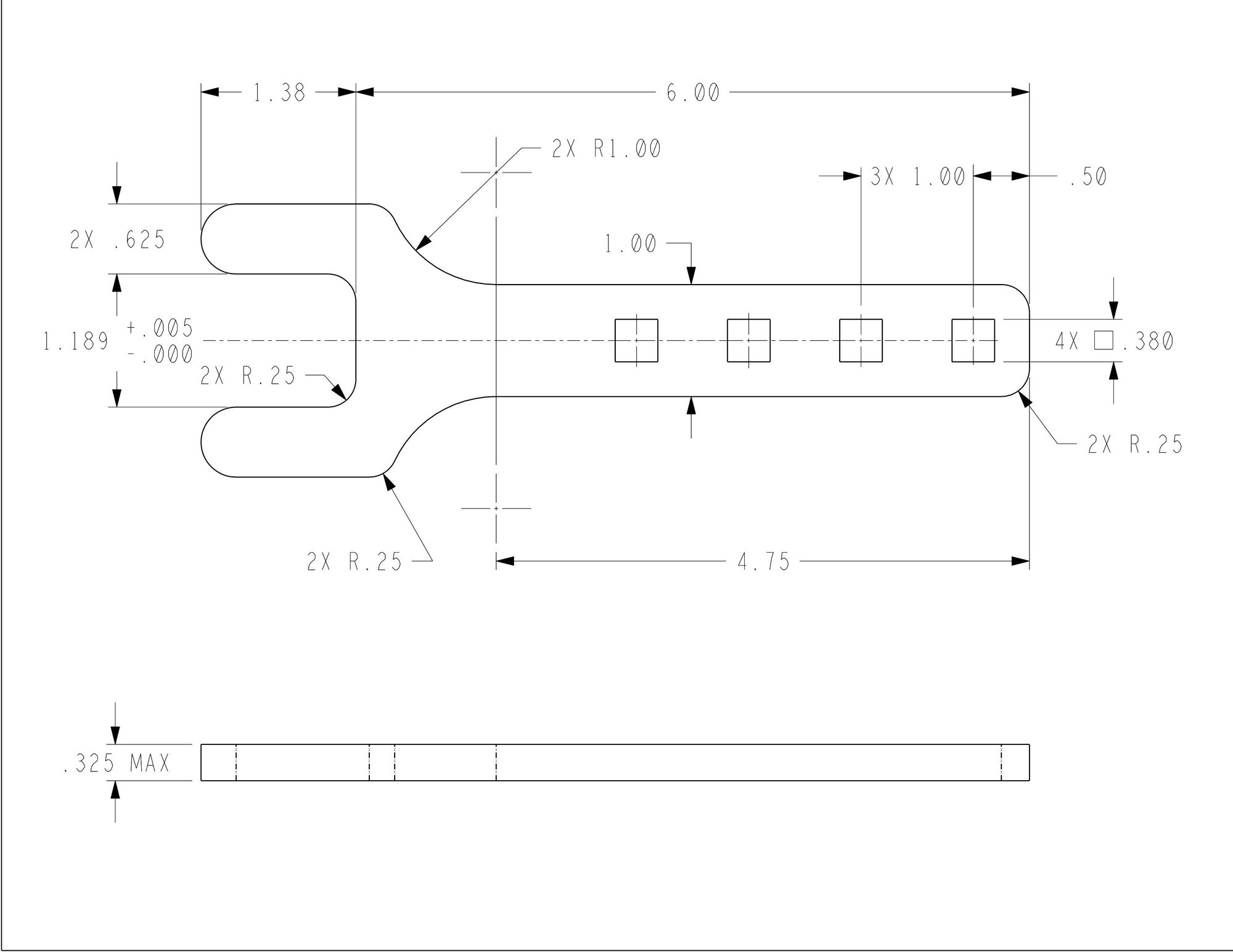

This was in a different thread
found it yesterday. It lost the link
definitely not drawn by me
