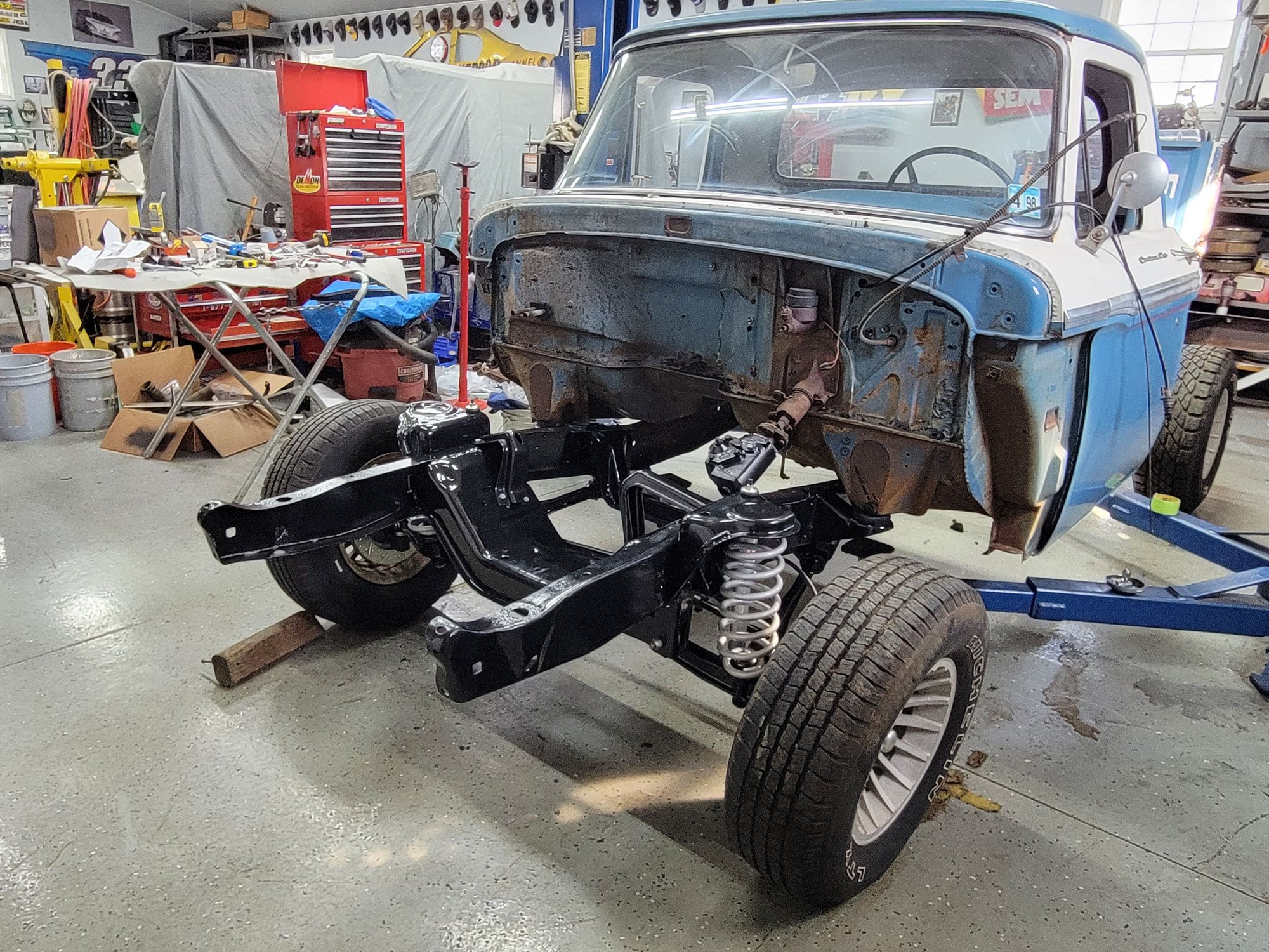

BC_99's Avatar
BC_99
Joined: Jun 2023
Posts: 152
Likes: 159
Depending on what your other plans are for suspension etc... cpp makes a complete kit with new spindles, king pins etc. I found them on ebay and used it on my 65. It's not on the road yet, but it went together nicely.
BC

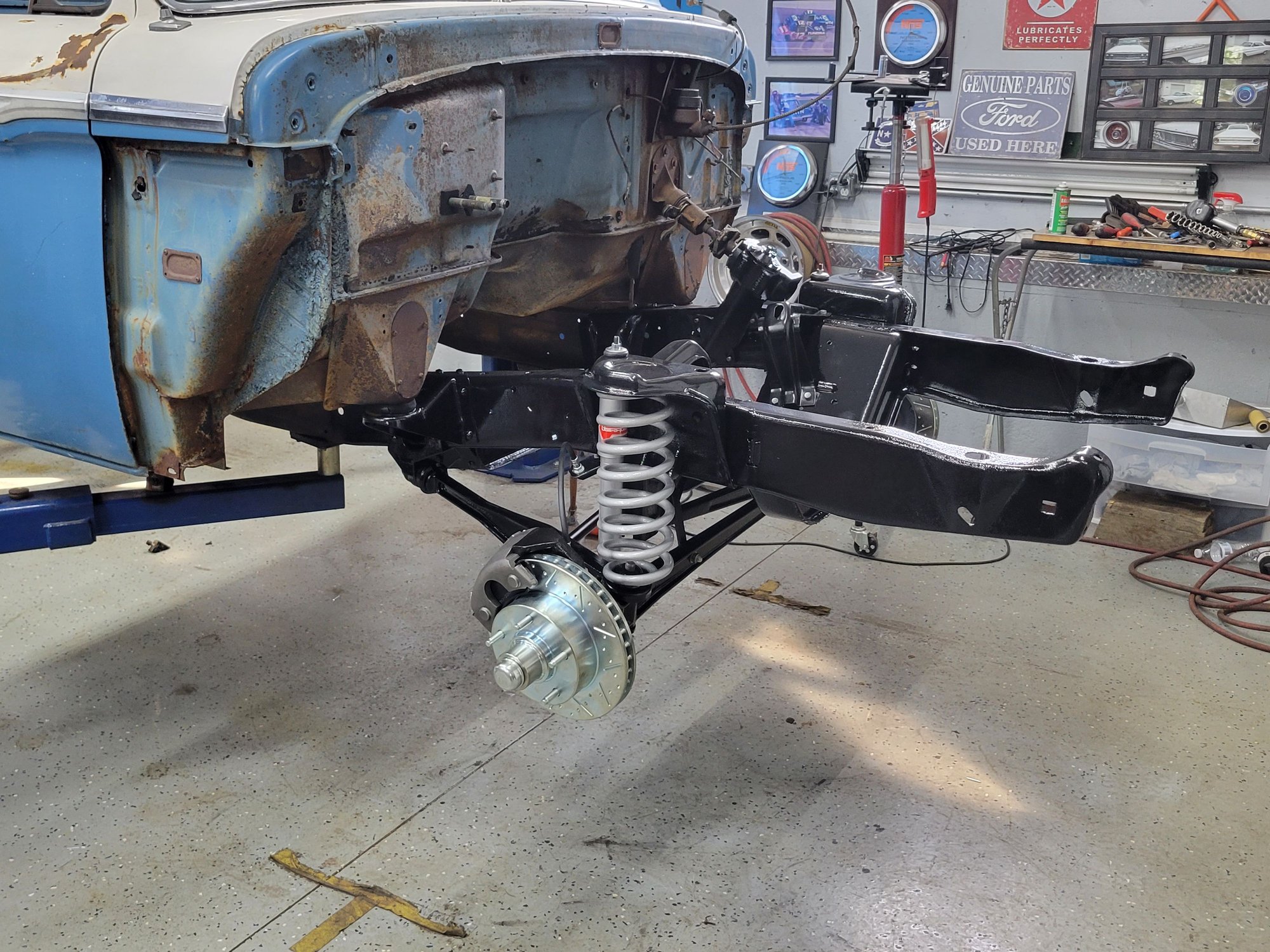

Originally Posted by BamaBiggDaddy
what steering gearbox is that? I have a 62 but the CPP power on and still strugging with hook up. Like the way that sets in
it's a remanned unit...from jegs I think. Here's a better angle of it.
BC
