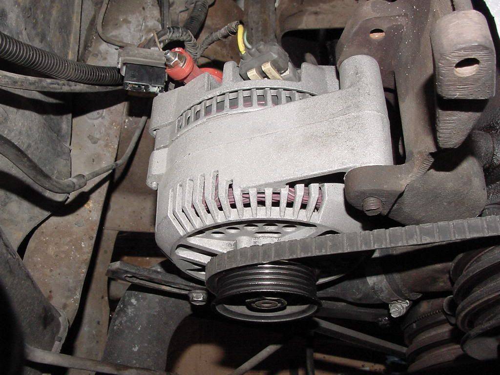

Here are a couple of photos of the 3G... in the "will it fit" stage.

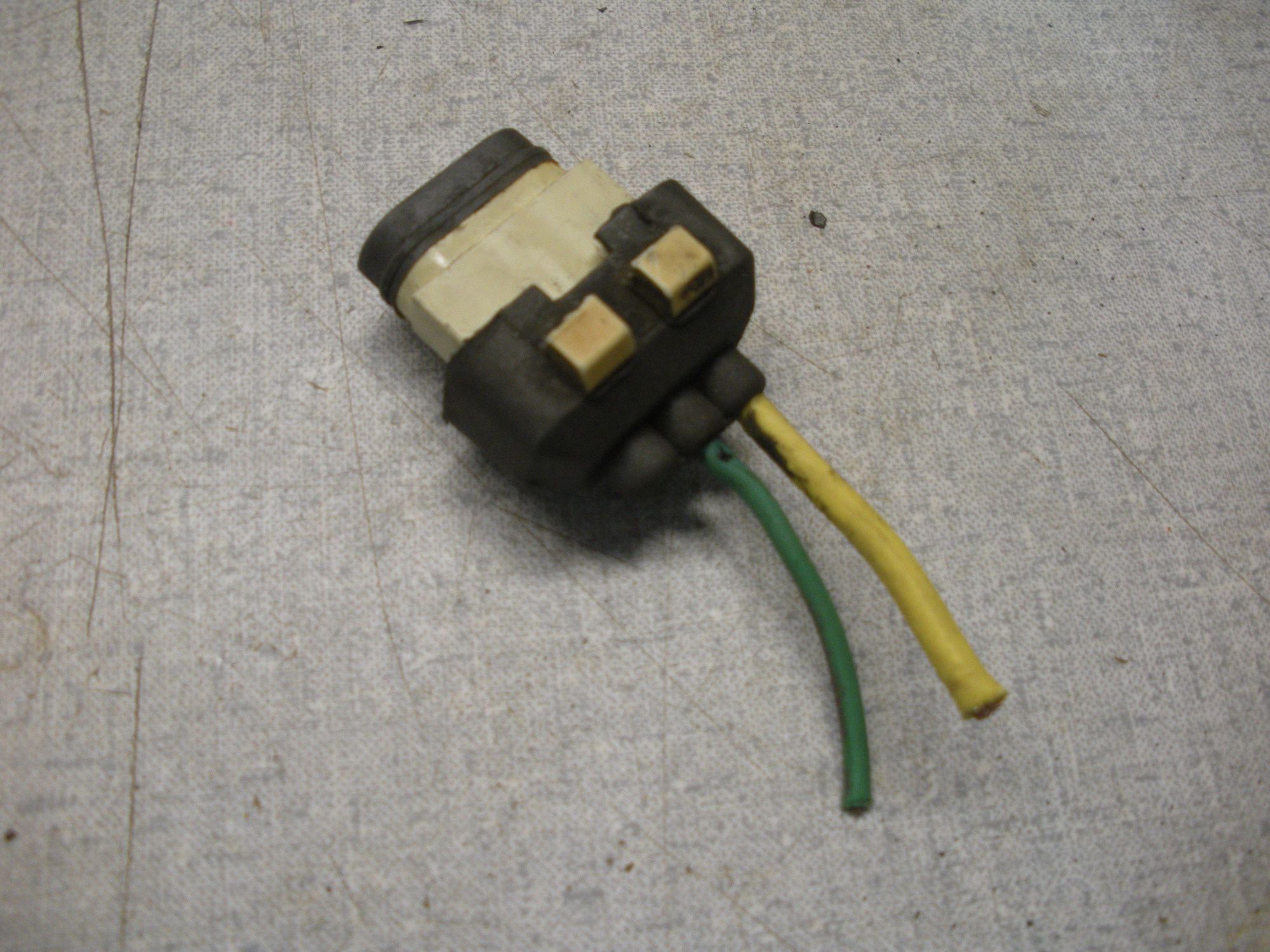

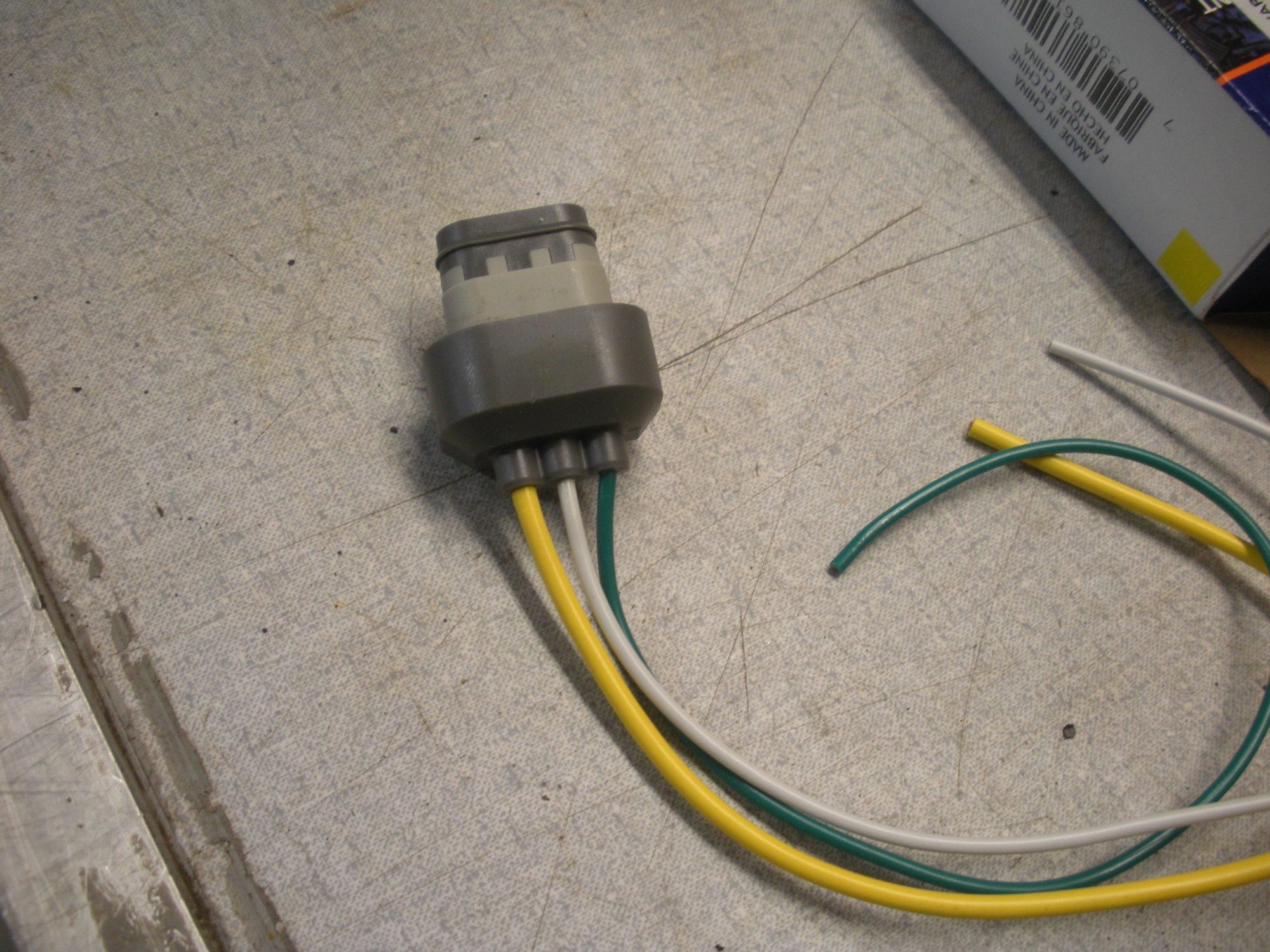

If it helps, here is the voltage reg. connector I got from NAPA. The new one has three wires. But for my 2g I just used the same two wires next to each other. (old yellow and green, new one I use yellow and white)

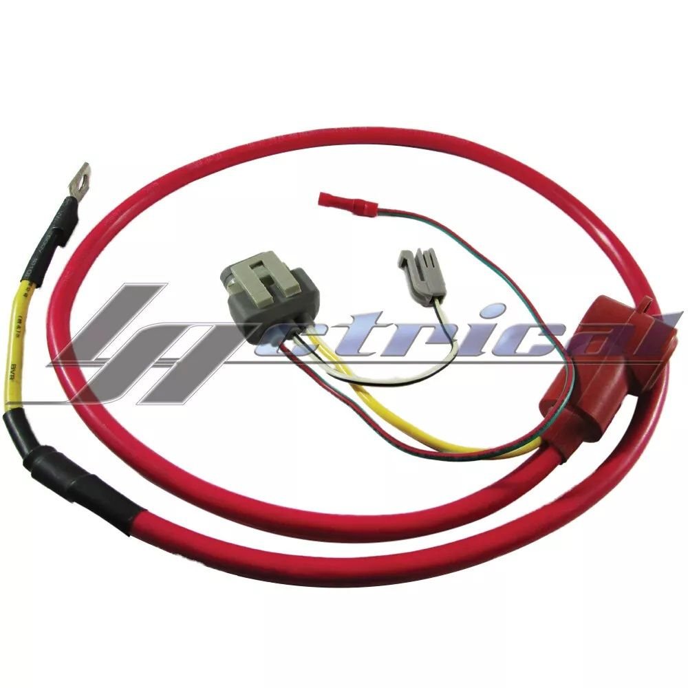

I found this on ebay. For the price it's a decent pretty straight forward and saves some time. It's about the same price as a used Mustang loom that does the same job.
