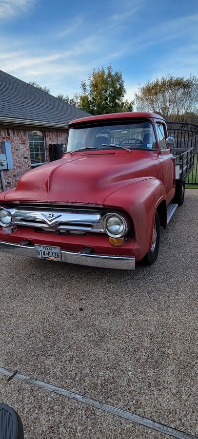

56 f250

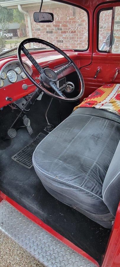

Looking for seat
The seat and sliders in the truck is not original. No where close. I am looking for a complete seat frame and sliders.

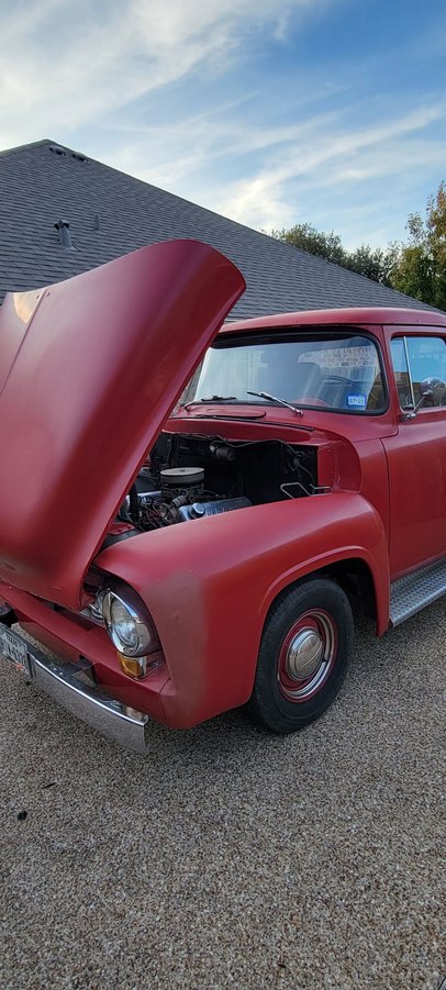

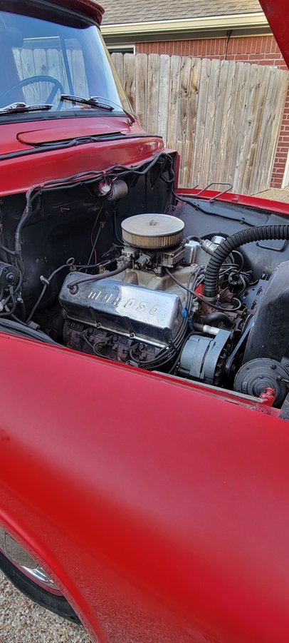

Nice truck.... Looks like a big block. What engine, trans, rear end?

I have not researched them. Told it's a 351M, but not sure of trans and rearend. 3 speed automatic and a 9" out of something.

Looks to be the size and shape of a 351M/400. If you were told 351M, it's likely true. No one would lie about that if it were a 400. It usually goes the other way around. There are no external differences, just the stroke of the crank.

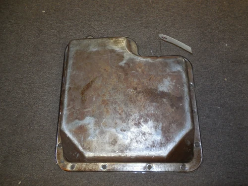

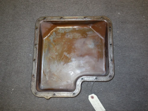

The most likely 3 speed auto trans would be a C6. It has a square shaped oil pan with a corner notched out, as seen here. If yours looks like this, there you go.
Used Original 1972 Ford Mustang C6 Oil Pan - Picture 1 of 2
Used Original 1972 Ford Mustang C6 Oil Pan - Picture 2 of 2
If the rear end is a 9" with the 5 on 5.5 truck bolt pattern wheels, the whole drivetrain was likely donated from a 77-82 F150. There may still be a tag on one of the center section bolts that would ID it. If you could find that and post a pic, we can help.
Cool truck! I take it the clutch pedal is just there for looks if it's an automatic. Welcome to the forum!
yes the clutch pedal is just for looks, will probably be removing it.
