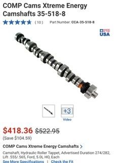

yeah, I mis-typed the cam I want. Looking at the 224/232 Extreme Energy CompCam offers. That has the 112 LSA you mention.

The cam you are looking at is for a 5.0 not a 5.8. I know the firing order is different and this may be an issue. Another potential issue is the cam is for a roller block, which you will want to make sure you have before ordering. Most cams require different valve springs, there is a page on comp cams website for the parts you will need with the camshaft.

Is this the camshaft?
What camshaft did you find that is for a 5.0L? The one I found is a roller cam and starts with “35” so that has the 302HO/351W firing order. The block is from a ‘96 so it should be a roller block unless it was replaced with something else.
