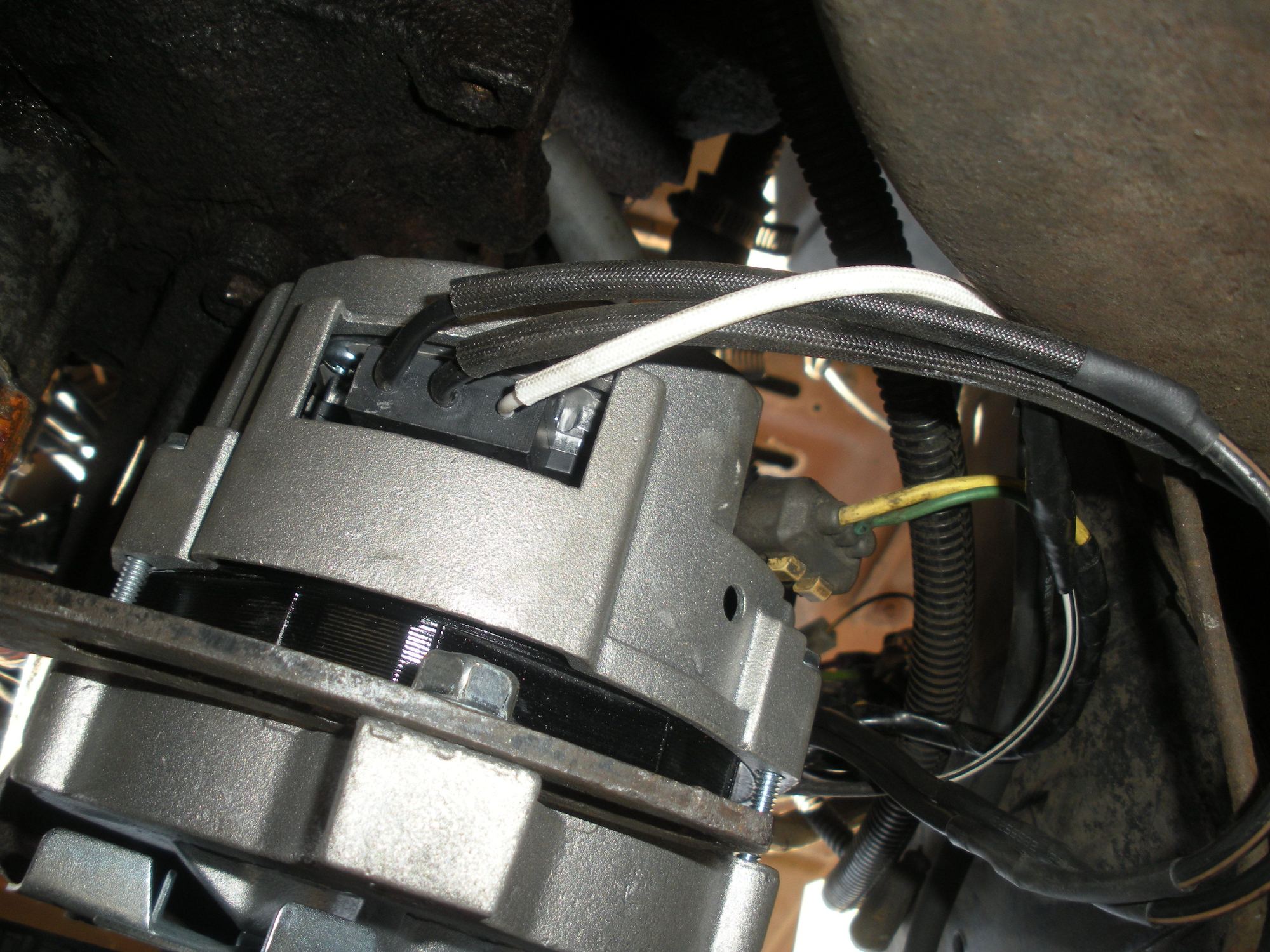

Here's my newer 2g from NAPA, with new connector. Advanced tested the old one and told me NAPA had for me. Make sure they only sell you the newer style connector, They may offer you the old style.
Bring the old Alt with you, they will change over the pulley if needed.

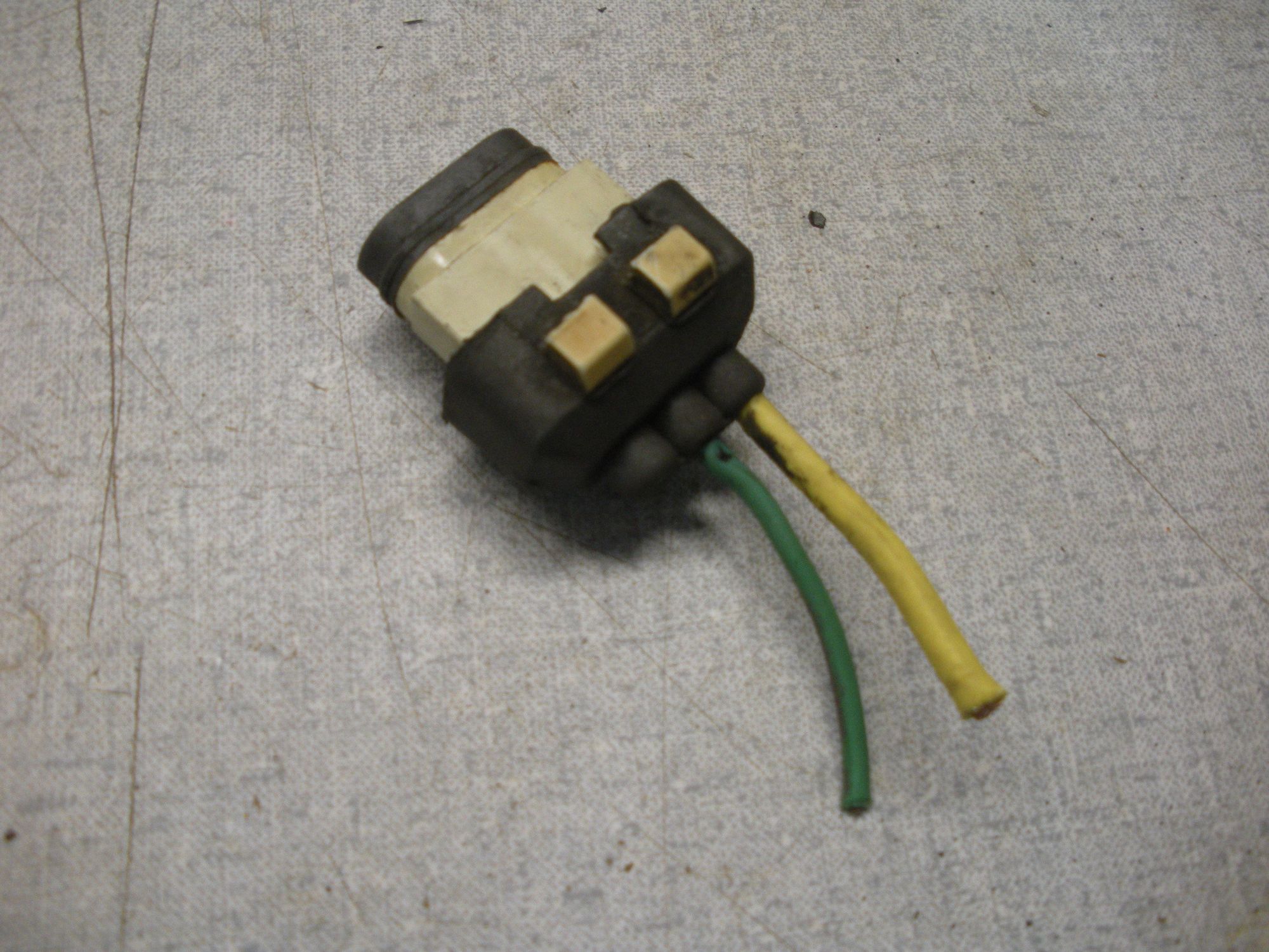

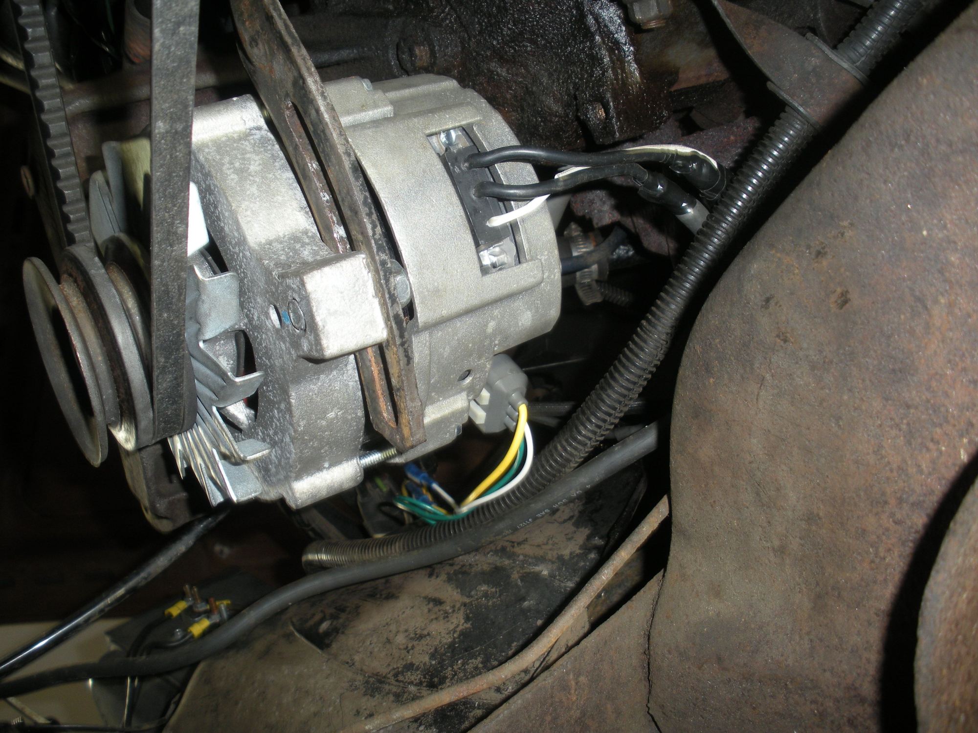

If you need, that should help. Notice "C186" for the regulator is wired differently then on my 86 302EFI. When I put the new connector on, I kept the same hookup as from the factory.
