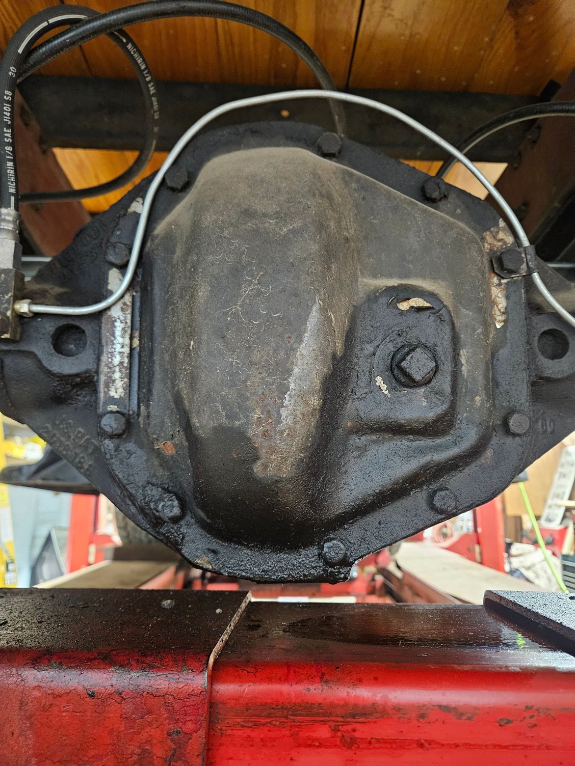

I am told it is from a late 60's or early 70's ford truck. How would I tell if it is a Dana 44 or 60? It has 10 bolts. I will attempt to post a picture.

That doesn't look like my Dana 44. Are you sure it isn't a Dana 60?
How many lugs on the wheels?
Ignore the size, the scale is off. The shape is different.

Looks like the number 60 is cast in, in your pic. The ratio should be on that tag. The Dana 60's are the correct width up to 1972 Ford trucks. I got mine from a 2WD 72 F250 with 3.73 gears. Works well for me and the tires I'm running and a T98 trans.

As I am cleaning it up, it almost looks like an 80 in the lower right corner. I think a Dana 80 actually has more gear ratios available. Adding to my confusion as to which one to pick. Lol

According to this, the Dana 80 was first used by Ford in 1988, so if your axle is 60's-70's, it's not a D80. https://en.wikipedia.org/wiki/Dana_80
The tag on the diff cover will have information on it for year and application. Post it if ya got it. We can tell you more.
Something to consider is one of the reasons low gears were used in the old days is the engines weren't powerful enough to pull a higher gear, especially with a load. Your truck feels powerful now, relatively speaking, because of your 4.11 gears. Swapping them out for something super high, like the 3.07 you mentioned may be a big mistake. Guys that have tried gear swaps don't recommend anything higher than 3.50's with a V8. I wouldn't expect that to be any different with a 75-90 hp 6, depending on it's condition.
The other thing to keep in mind is we've become conditioned to having our modern cars practically idle at 70 on the highway with overdrive transmissions for the sake of fuel mileage and comfort and quietness. As such, the 3000-3500 rpms that was normal for an engine to work back in the day sounds like a grenade today and freaks us out, when in reality it's what they were designed to do.

Looks like 80?

Trying to clean up the tag to read it.

this is what I see, ymmv.
