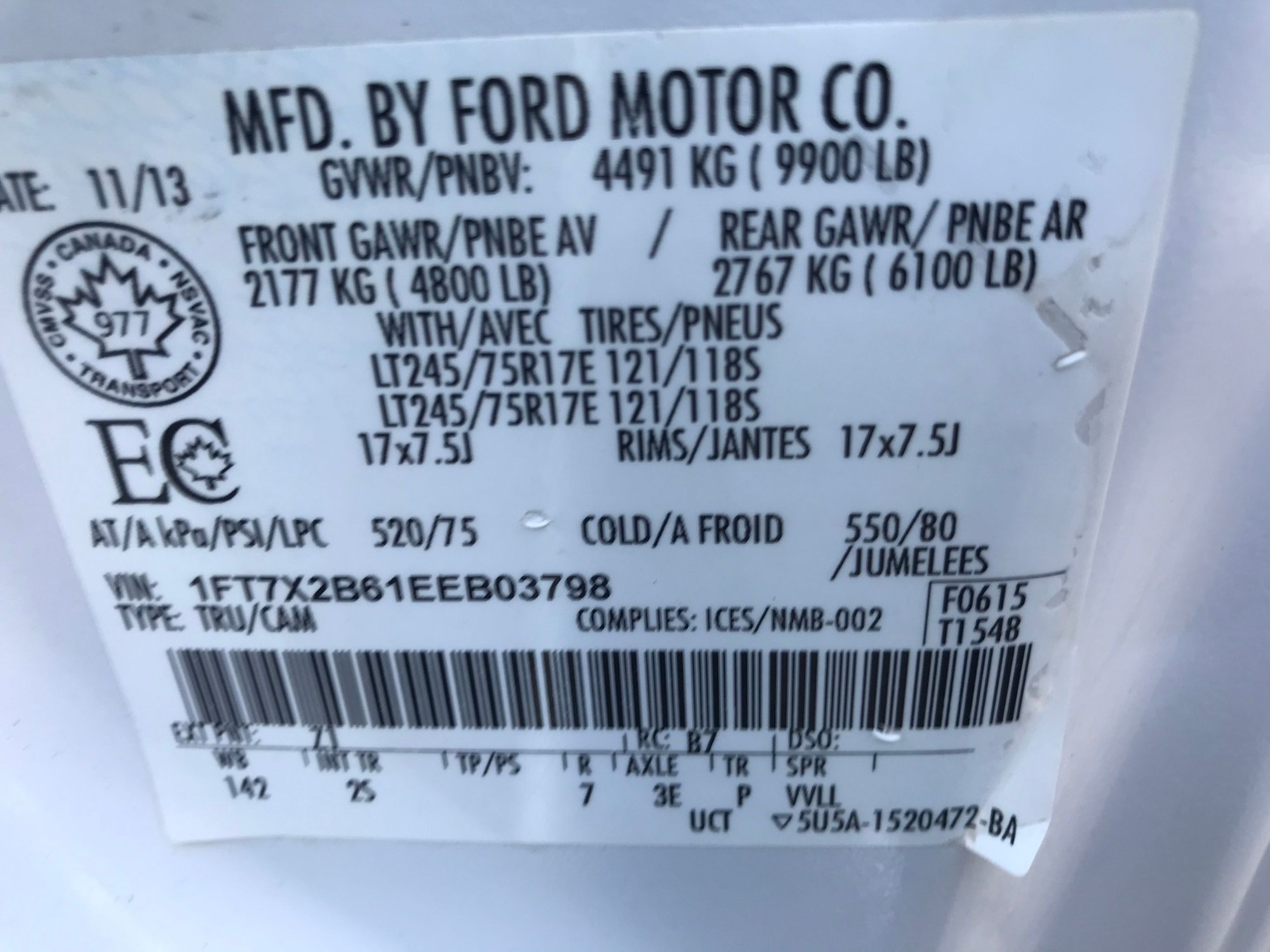

I am just continuing to build the database with door stickers and the information is interesting to me as there is sooo much incorrect information in various forums, and they just feed back and forth on themselves until pretty much none of it is correct (especially on eBay). That's what I'm hoping to NOT DO with what I am finding and putting into the database. I'm keeping the door labels as reference and cross-check, so VIN info is available to find a specific "stock" front coil spring from the dealer with the correct VIN information. So far, I have about 100 labels and counting. I'm cross checking on VIN, Door Labels, and Window stickers for what options came with the specific VIN (example - extra heavy duty alternator) so the part number search is not so onerous and the other necessary parts can be located as well. In this instance, I am tracking on FX4 springs, shocks, versus engine type and options. That's why I was wondering what he was offering as for all years, but it's not. I just wanted to confirm as a sanity check - peer review so to speak.

the second link is to a russian site/ listing It's a listing site that shows auction results by VIN. That's the one I checked after COPART. I can confirm door label information and GVWR, GFWR, GRWR numbers and correlate them to the SPR code to confirm or deny Ground pressure lbs rating.

My questions do not pertain to my individual vehicle per se, but 2005 - 2016 FORD F-250 Super Duty. I am taking my personal vehicle to the alignment shop to have a measurement taken to confirm my suspicion of spring sag, then I will go to the FORD dealership and order new springs from them based on a VIN that I have researched that has the ground pressure lbs that I would like based on some excellent suggestions I've been graciously given by minds greater than mine on this subject.

Data is updated with new information in case anyone wants to look at it. I have the information from approximately 110 door labels. Please include your handle from here so I know it's a legitimate request.
