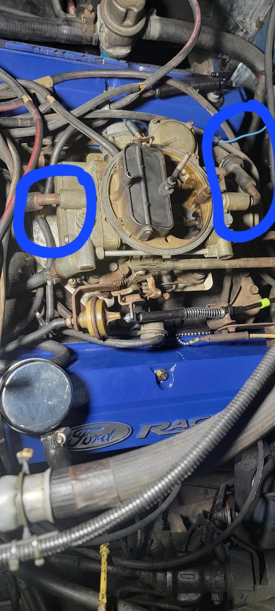

Hey guys appreciate the help all around. I finally have some time coming up where I am going to do the carb but I am running into an issue. I have no idea how to get two of the hoses out of it. I can get the fuel line, off and the bolts off. But there are 2 hoses running in the front and back seemingly with no threads. The hoses have a rubber part with a "****" of some kind but I cant for the life of me figure out if its a way to disconnect the lines. I will attach picture below.
Anyone have ideas on how to remove the circled hoses in the pictures below so I can pull the carb out?

Just pull them off. That steel line coming out of the carb is just a nipple for the rubber line to slide on to.

There is a short rubber hose between the metal nipple and the black / white plastic part.
If the hose is rock hard I would use side cutters to cut the rubber off each nipple.
Just be careful not to cut the plastic part.
Can also try cutting it witha razor
