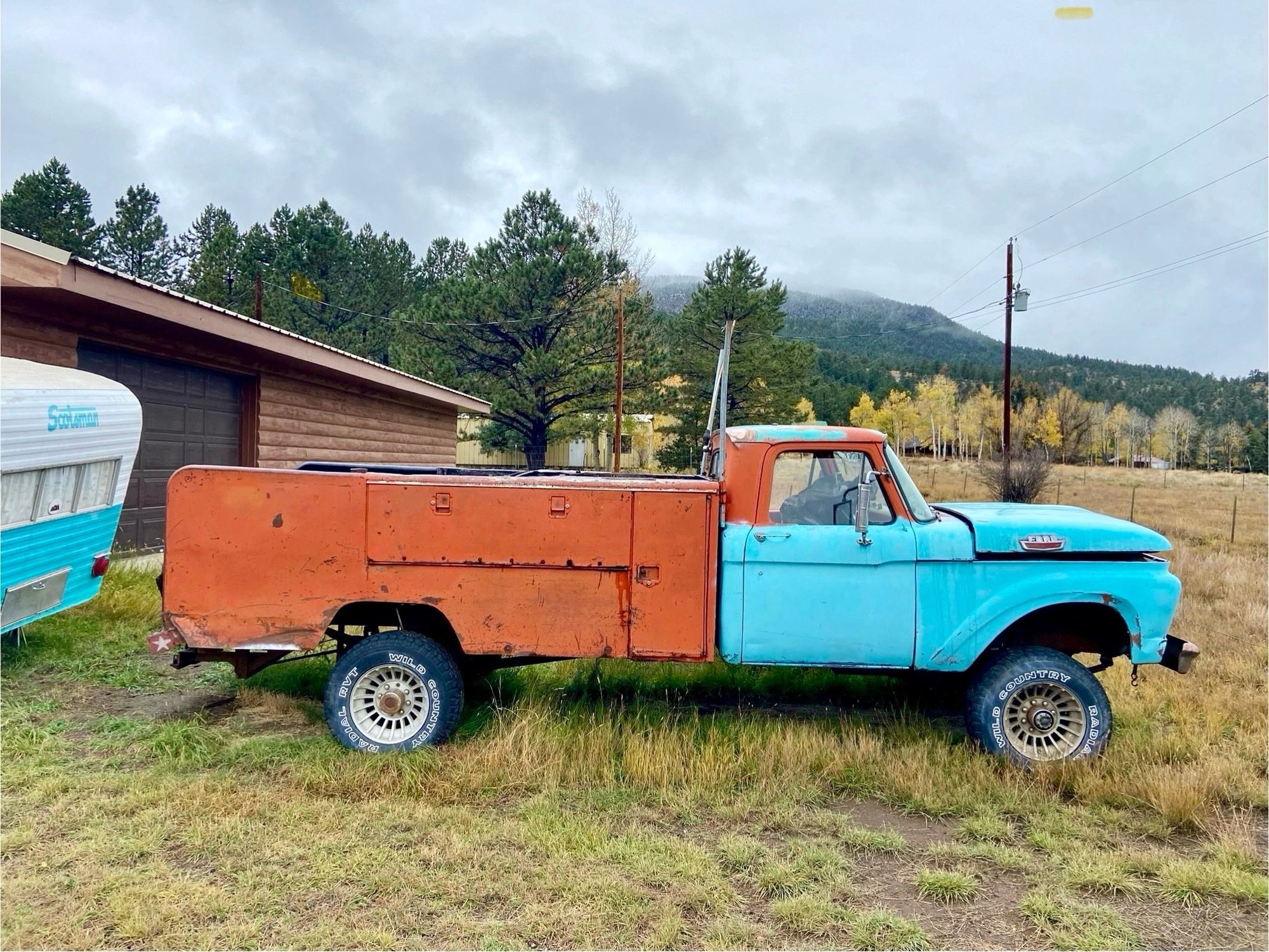

New here but not to FTE. I admit I have a Ford truck problem.

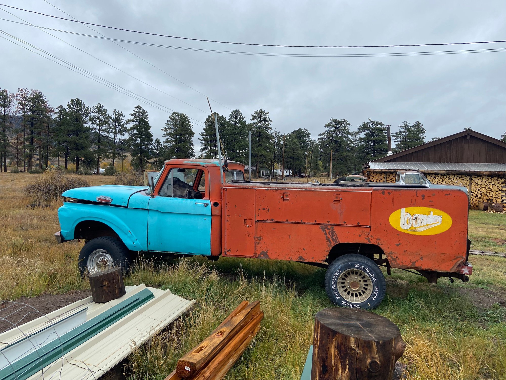

This 66 has an interesting story. The guy built it to haul his ****** to Moab and pull a camper. The jeep went into (onto?) the back of the truck. He extended the frame and built the box.
I originally bought this truck to put the drive train in a 50 F2 but……the more I checked it out the more I liked it and I already have a running F1 but I didn’t have a 60s truck. Now I’m excited to get started on the project and the plan is shorten the bed to 8ft and put a tail gate on it and make my wood hauling/work truck.
My first question here is what engine do I have? The VIN plate shows a C but decoders like Fordification don’t show a C. Plus the PO may have changed it. It’s a F250. Do any of you recognize it?
Thanks

C engine code was used in earlier years to designate the 292 engine and that's what it looks like. It's definitely a Y-block. Last year for it was 1964.
I can also tell that the cab is not a 1965 or 1966 because it has the cover on the firewall below the solenoid for the heater motor like 1961-1964. 1965 and 1966 the heater motor was on the other side of the plenum chamber so they had no cover there.

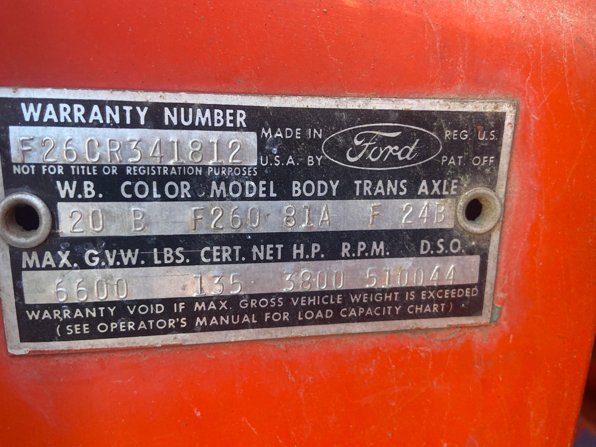

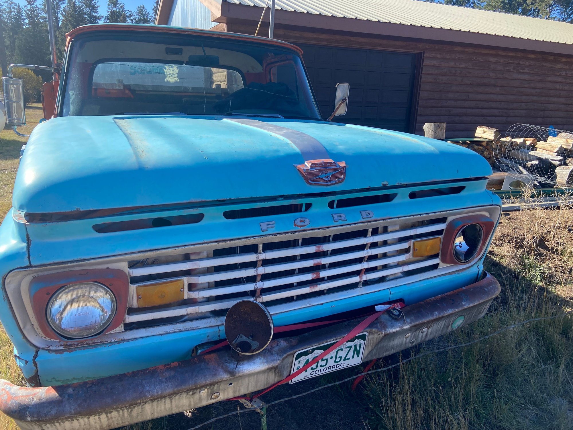

If there is a Warranty plate on the driver's door near the latch post a picture of it and I can decode it for you. Also, if you take a picture of the grill and post it I can tell you which year that is. Could have been changed, but if not it's a great hint.

The truck is no newer than 1964, and the engine is a 292, if original.

Not embarrasing at all. From the side, except for trim, the cabs all look the same from 1961 to 1966.

Requested grill picture.

Definitely a 63 built in Oct of 62. All of the badging and grille and roof height is consistent with a 63 model. Cool project. I have a 63 F250 4x4 as well. The drivers side exhaust manifold look to be car/t-bird version mounted backwards so it's using a passenger side car part. Those flow pretty well so a good mod.
Here's a link to decode the rest of the tag.... https://www.fordification.info/tech/vin63-64.htm

Wheel base is approximately 142” so PO definitely lengthened frame. From what I found 120 is wheel base for long bed .

Correct... The "1" on your tag is a little off register... All 61-66 F250 4x4 had a 120" WB and all were long beds. And all of them had that same style bed if a Styleside.

F26 = F260-4 x 4
C = 292 2V
R = San Jose, CA assembly plant
341812 = October 1962 assembly month, 1963 model year
120 = wheelbase in inches
B = Caribbean Turquoise paint
F260 = F250-4 x 4 - 6,600 lbs gross vehicle weight rating
81A = Standard Cab
F = T98A 4-speed transmission
24B - 24 = Dana (Spicer) 60 (5,200 lbs. capacity) 4.56:1 ratio non-limited slip rear differential
- B = Dana (Spicer) 44-6F (3,000 lbs. capacity) 4.56:1 ratio front differential
06600 = Gross Vehicle Weight Rating
135 = Horsepower @
3800 = RPM
51 = Denver, CO district sales office
0044 = Domestic Special Order number
