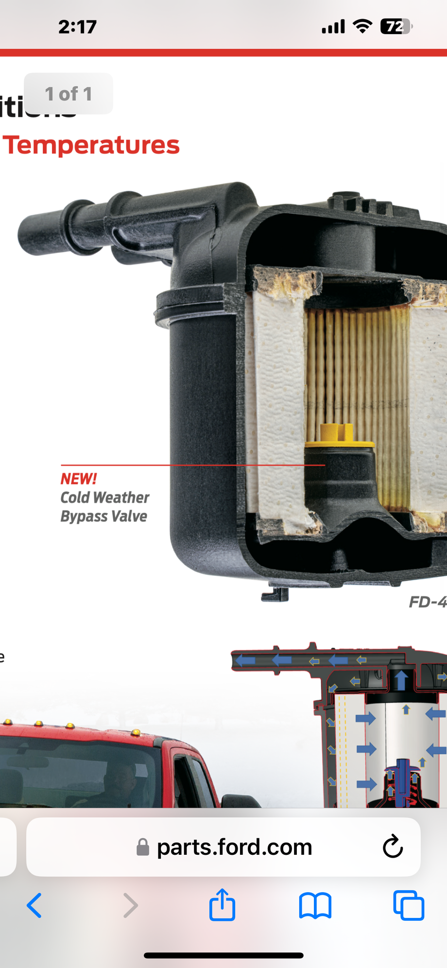

Originally Posted by Conner58
I seen they now have a new style of ford filter out .
The top has ribs for reinforcement .
yep
and that new style has a bypass valve….so instead of filters clogging and bursting…it goes into by pass and sends all the fuel junk to the injectors.
Old Nov 1, 2024 | 08:56 AM
Ltngdrvr's Avatar

Originally Posted by speakerfritz
yep
Never heard this before, where did you get this info from???
There is no external indication of this, only external change is the strengthening rib difference.
Old Nov 1, 2024 | 09:59 AM
we had a discussion on the 6.7 section and there was a ford pdf with details and internal views.
you can go to 2:30 on this video and he explains it.
definitely a problem in my mind. I’ve blown one of these older filters with less than 3k miles on it and I suspect it was bio mass related clogging….now with the new filter.. that junk would go directly into the injectors once the filter goes into bypass.
I'm not sure why they are claiming the bypass is new to this filter. Ford/Motorcraft stated that the bypass was in the FD-4625-AA, which was out late '19 or early '20.
if it was…it didn’t work…filters were bursting….i had one which burst and it was the prior generation.
i have the prior gen odd and there is no mention or illustration of a by pass filter.
new version pdf has mention of the by pass and cut away as to how it works.
Here is the prior version…maybe someone has the new version
https://parts.ford.com/content/dam/f...el_Filters.pdf
Old Nov 1, 2024 | 01:18 PM
speakerfritz's Avatar
speakerfritz
Joined: Jul 2013
Posts: 14,298
Likes: 2,197
Found the new version
I had already added it ro my previous post. I'm sure you can see the part # associated with it?
Old Nov 1, 2024 | 01:22 PM
speakerfritz
Joined: Jul 2013
Posts: 14,298
Likes: 2,197
Lower left hand corner of the new version PDF, it’s dated 2021
