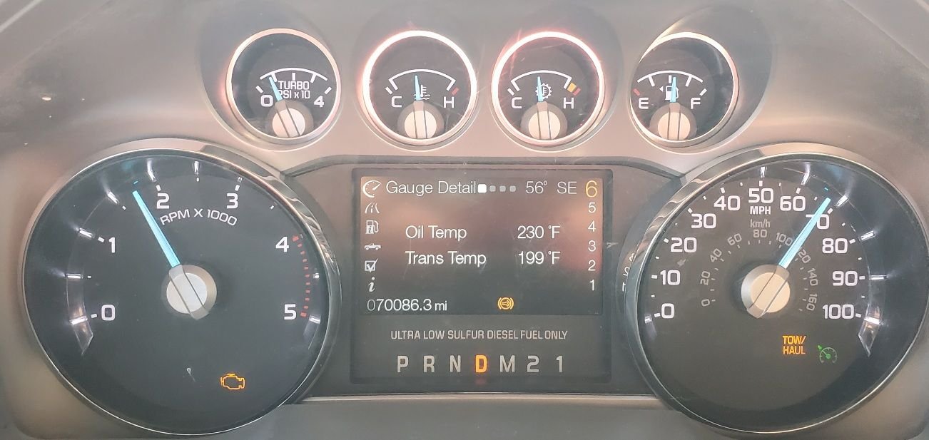

This is a couple hours in to pulling the 5th wheel with my '16' just a couple days ago.
Normal.

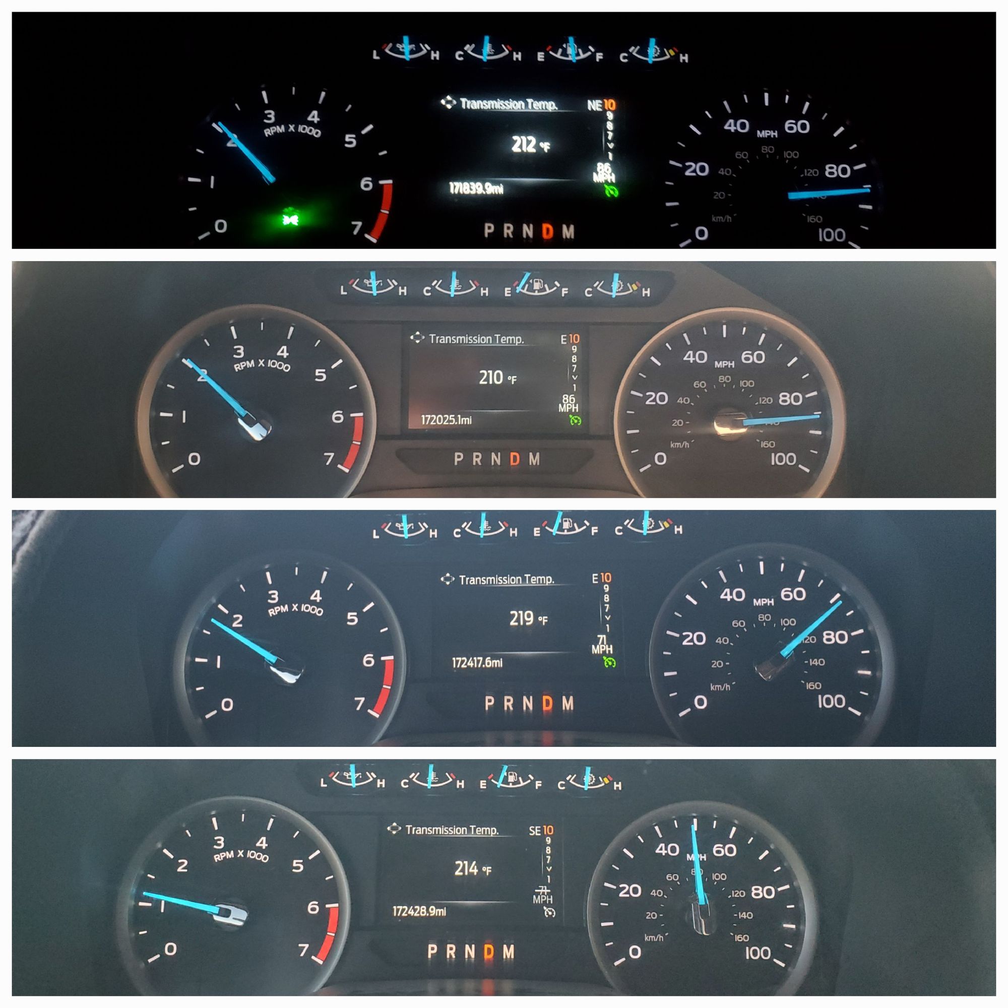

The newer transmissions certainly run a little warmer. This was yesterday during a 850 mile run from NV to CO with my '21' without towing. Top pic about 2.5 hrs in, bottom pic near the end at 12 hours. Those temps are the normal range.
