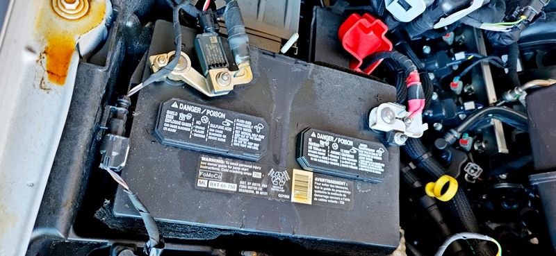

They did not. At least not on 2024 F250 XLTs.
I replaced what came with the MY24 truck and replaced it with a Walmart AGM:
Original:
Replaced with:
Original:
Replaced with:
Original:
Replaced with:
did the exact same after my 2 previous set of Motorcraft batteries went south
