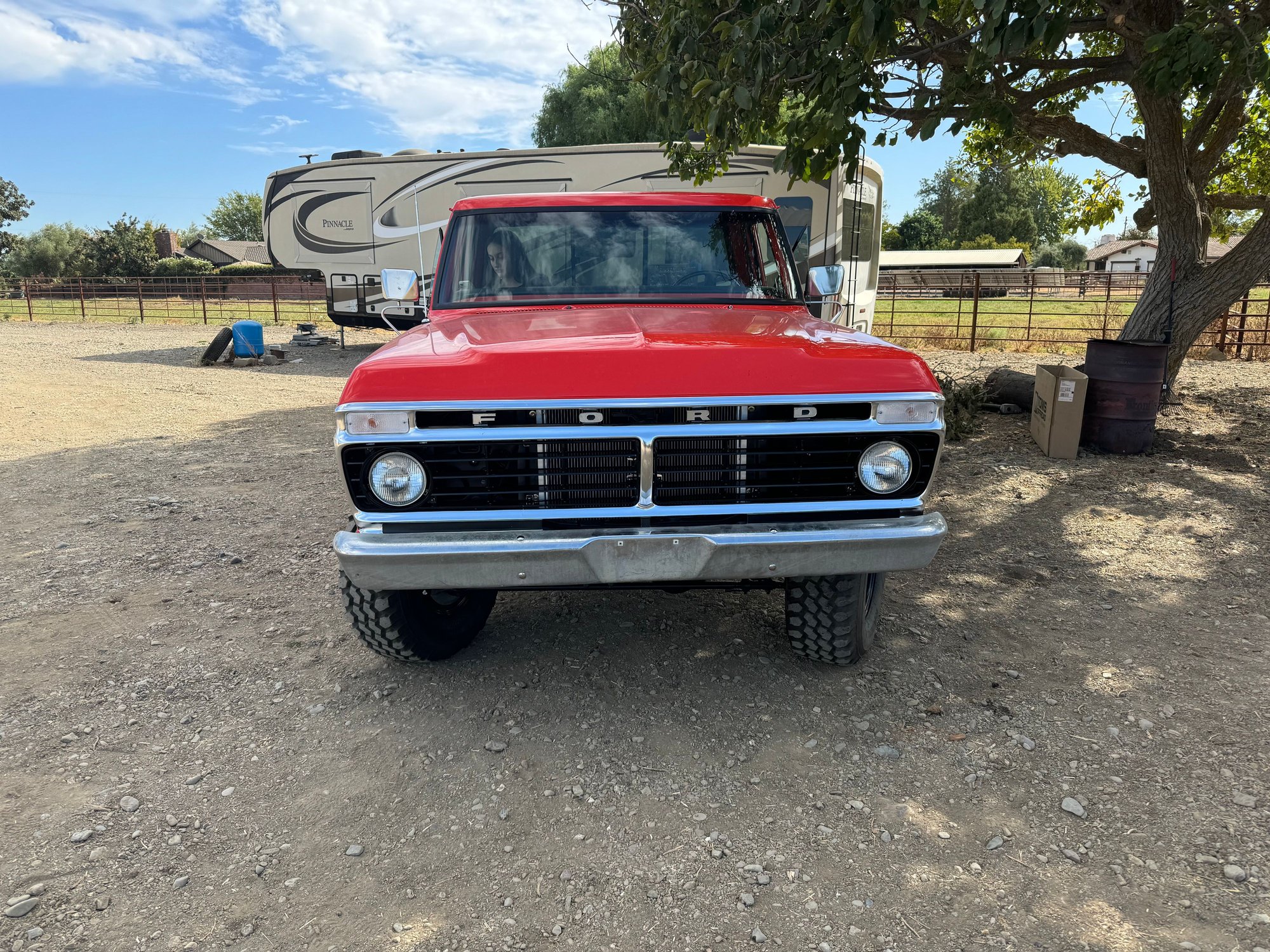

Depends on what you want. I didn't remove anything, just spent a couple hours listening to Willie's Roadhouse on XM as I rubbed and buffed both by hand and drill mounted buffing wheel using Semi-Chrome aluminum polish. I followed with Liquid Glass (an old school non wax polish) If you get real close, you can see the years but I don't allow that level of closeness in traffic. It didn't have any "damage" .... just 45 years of sitting outside on the truck when not pushing wind.
I did it in 2022, still looks the same. I thought about a new bumper, but then I'd have had to get a new grille shell, so this was what I did.
I had already polished the bumper but it has some age related spotting too..
I did mask my new paint.

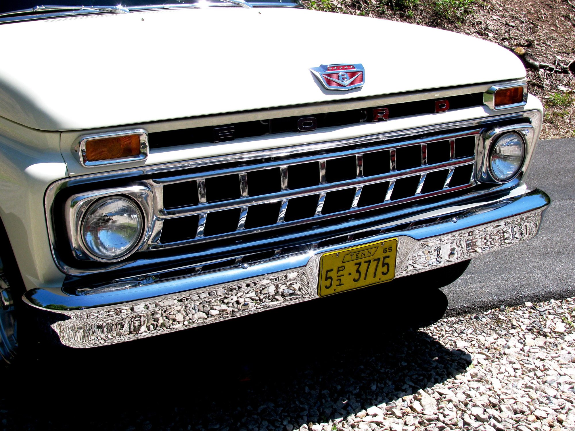

Originally Posted by F-250 restorer
I'm wondering is anyone knows of a system/method to refinish one of our aluminum grill shells that will make it look good. After seeing how much these things are now selling for, I am exploring other options. Thx.
If you want it to shine like new it is doable but labor intensive.
You cannot polish the anodizing it is too hard.
1. Remove the grille
2. Go get several red Scotch Brite pads and a couple of cans of not environmentally friendly oven cleaner and some rubber gloves. The anodize has to be removed and a caustic is required.
3. Somewhere outdoors spray a generous coat of oven cleaner, it will start to foam. Do not let it dry. Rub with the scotch brite and rinse with a hose. This will usually take more than one application. Anodize is non-conductive so you can use an ohm meter to make sure it is all off.
4. Do not use any sandpaper or compound coarser than 320 grit. Sand out any deep scratches.
5. You need at least a good drill and a Dremel tool. Go buy a bunch of felt and muslin bobs and some polishing compound. Harbor Freights a good place to get that stuff. Never go to a finer grit without using a new bob or at least cleaning the old one.
6. Start with a medium grit and work down to the finest grit. The degree of shine depends on how dedicated you are. Finish up with some Blue Magic or Mothers metal polish. Since it will be bare aluminum you will need to keep a coat of polish on it to prevent any corrosion.
This is a 65 grille I did because they are not reproduced.

That's a nice job, and I know how much work went into it.
You're absolutely correct the bright dip has to come off, you can't polish a turd.
