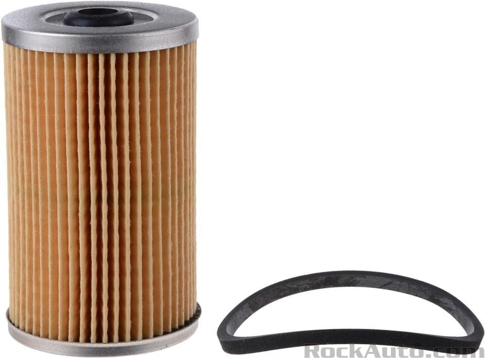

If your truck has this style of fuel pump the filter is located inside the canister which unscrews for the pump.
And this is what the fuel filter will look like.

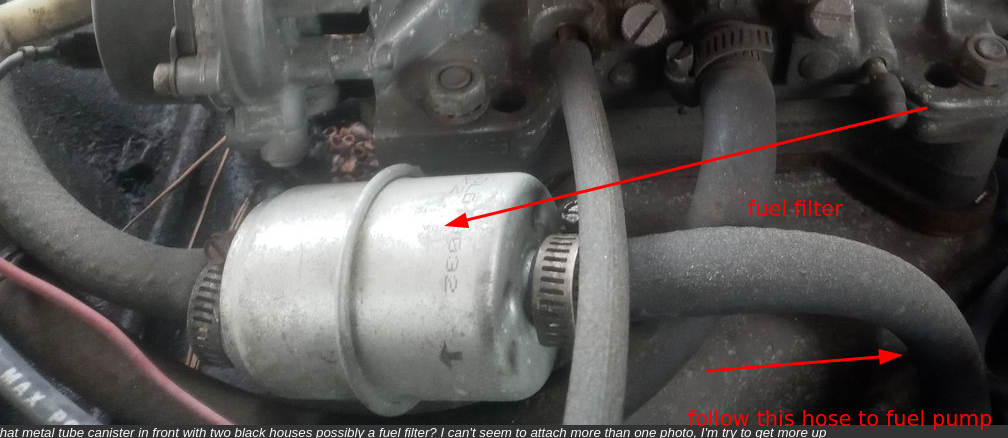

Thanks so much, I'm feeling pretty dumb because I can't even seen to locate the fuel pump... I took some pictures, if I'm a lost cause I completely understand lol
It's that metal tube canister in front with two black houses possibly a fuel filter? I can't seem to attach more than one photo, I'm try to get more up
This is attached to the frame and has wires and lines going to the front tank. What is this? I am not seeing a fuel "pump" from my limited understanding of what shape I should be looking for...
Thanks everybody who's taking their time to explain!

Here's your fuel filter.
Your second picture it the fuel tank switching valve to switch from your main tank to your auxiliary tank.

The second image you showed that is under the truck near the rear tank, that is called the fuel transfer valve, when you flip the switch on the dash that valve is what controls whether your fuel is drawn from rear or mid tank.

Might not be a bad idea to replace the hoses when you replace the fuel filter. They look a bit aged.
That carb could certainly use a refresh, the accelerator pump is leaking. If you are confident in your abilities you could order a refresh kit and rebuild it yourself or have someone do it for you.
