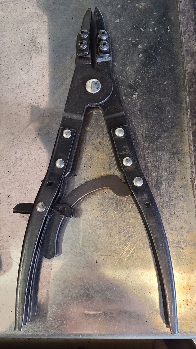

This is the Lisle pair. I don't remember the part number. They have a ratcheting hold-open mechanism that makes it a lot easier to deal with the snap ring, even though the ratchet can be a bit fiddly. The one complaint I have, and it applies to nearly all snap ring pliers, is they need to be either serrated or coated with diamond dust to grip the snap ring better. Almost nobody does that.

thanks Pikachu. that is the one that i bought. i will be digging back into my truck tomorrow, and will let you how it went. peace.
