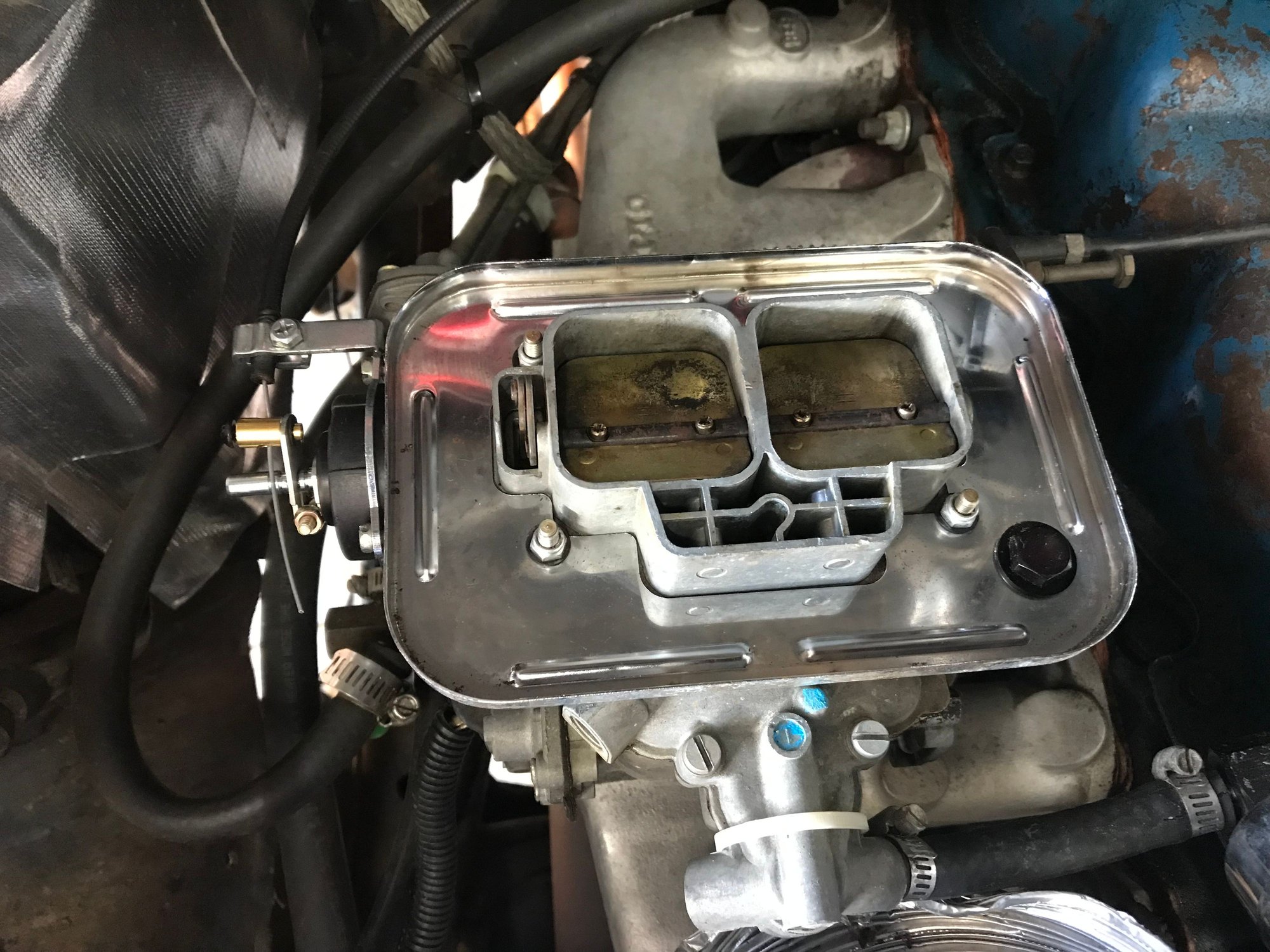

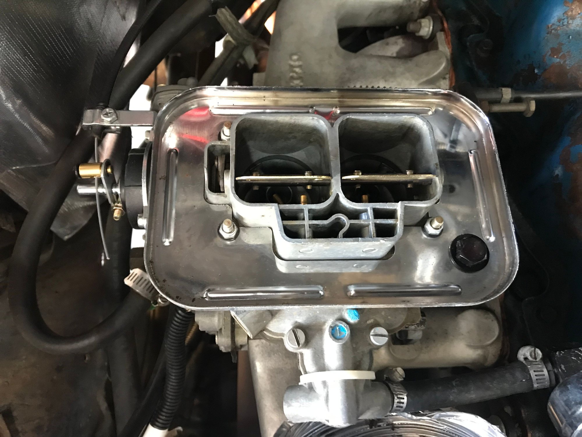

To operate the choke I put my foot on gas and if the choke is pulled the full length the truck starts and idles rough ( this is all in warm weather ) (no choke required)continue pushing pedal and pushing my choke. In a bit I get a high idle 2nd scenario -After the engine is warm , I go out start truck ,depress the gas pedal ,then slightly opening the choke ****, I get a clean high idle around 1000 rpm .If I depress the gas pull out a little more ,rpm’s are like 1300-1400.On this set up ,the thing to remember is depress the gas pedal to control the choke **** in or out.I am sure when pressing the gas pedal and slightly open the choke ****; the high idle must be on the cam , I have not done any adjustments ,other that setting the carb up years ago (2013)using a vacuum gauge for set up .I do not plan as you state -to use this for extended periods .For me a good 2-3 minuets is sufficient . Tomorrow,I can look to see where the choke is in each of the scenarios mentioned above ,as I do not think on high idle it’s changing the fuel mixture .its just on the fast idle cam . TR

Choke **** pulled all the way out
Idleing around 1200-1300 rpm choke **** just barely pulled out!

Choke pulled all the way out !
