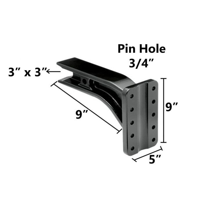

I'd get a Curt or similar drop plate hitch that uses the four bolt mounting. Then you can run at whatever elevation, and swap between pintle or ball setups.
