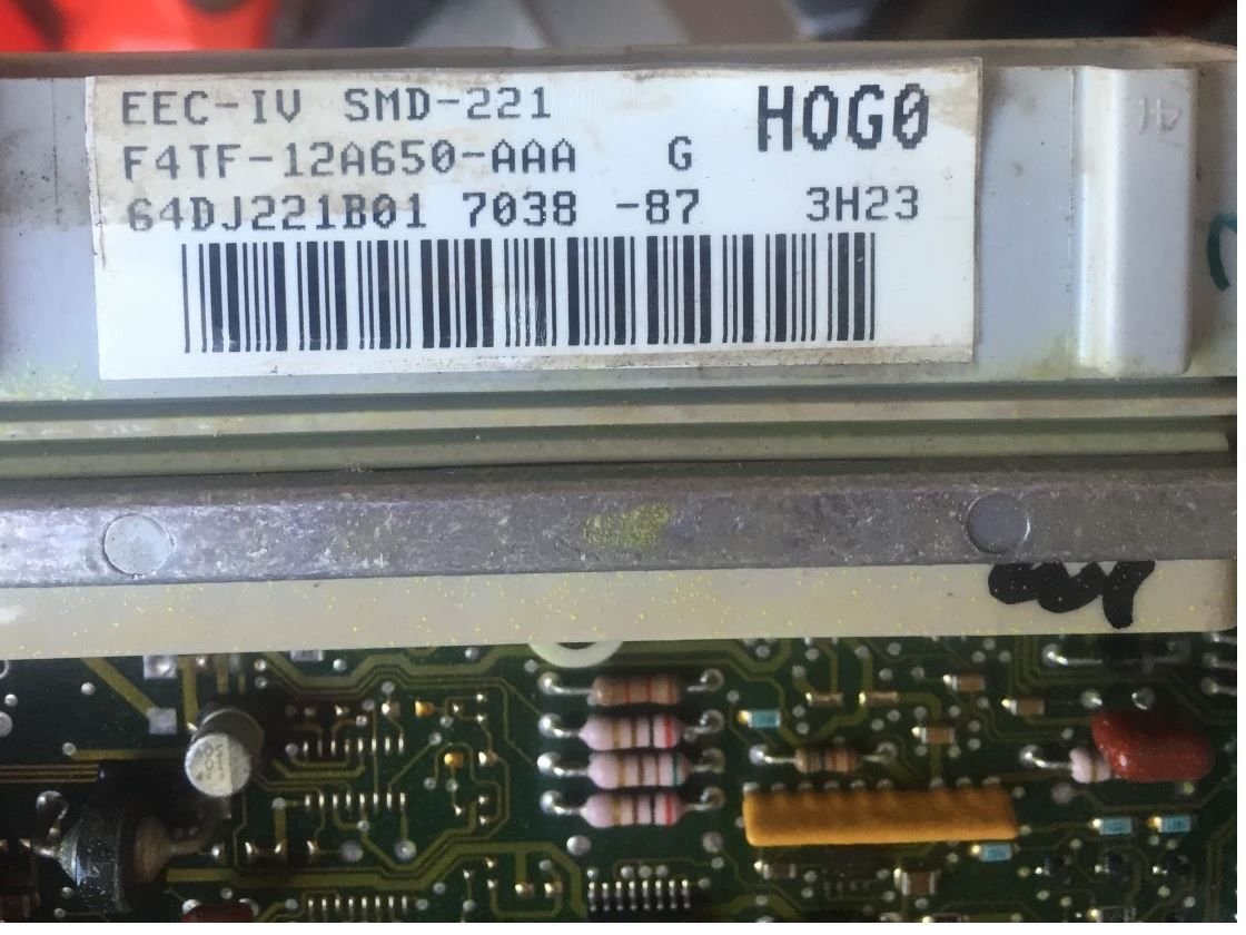

Post your calibration code from your data sticker on the door jam & your engineering number (part # for practical purposes) can be found or determined if what you have is correct or original.
The portion of this label, F4TF is the year & application (94 truck) 12A650 (computer) AAA (configuration/programing)
Some computers have a "Z" replacing the second F meaning it is a factory replacement part or factory remanufactured part (No big deal)
The HOG0 is called a "batch or catch" code, really a quick ID.
