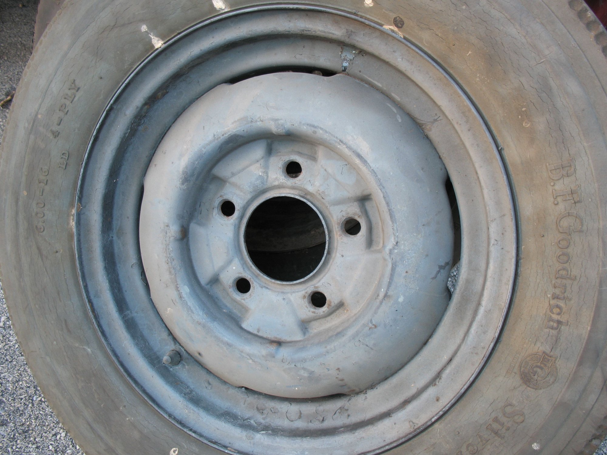

SCORED some 50 or 60's rims. I must be living right because they practically fell into my hands , ha, kinda
16" x 6" ???
This post is acting nutty ???
Anyway, What is the largest, safest size , tire that will fit on this rim/wheel ?
I should have some hub centric 1-1/2" spacers very soon that may help fill up wheel well.
The hub bore on these wheels are 1/2" larger than my stock wheels , is this un-safe
I am almost ecstatic cuz I have LUSTED 4 these 4 years cuz I have some AMAZING HUBCAPS I have been dying to use , but not the proper wheels.
NOW I GOT 2 just need 2 more...............

Those are innie hub cap wheels. They are lug-centric meaning that the tapered lug nuts center the wheel. You don't need a hub-centric spacer. Another thing is you will have to find innie hub caps as the majority of 67-72 F-100 hub caps are outie hub caps. With the wide hub, I think it is a Jeep wheel for 4wd. Is it stamped with a Ford oval?
They look like these Jeep wheels:
https://www.classic.com/veh/1960-wil...55243-4ZgAkLn/

I was gonna look later for factory markings. I know about the hubcaps I did not know what these came off of when I found these rims I thought they might b Model A , forgot; I think now A rims may be wood. I do not know. I also thought they might be Jeep. Got home & measured the holes & wa-la, FORD rims or at least Ford lug spacing . I know Ford has the same look as these but they may b JEEP. I forgot about JEEP
I need to know what size tire are good & safe to run . I can find out I just thought some of ya'll might want to add some thoughts. I know hub centic spacers are safer. I do not know if there is a need for the actual wheel to be centic on the factory hub. I looked at my truck hub & how they fit my stock wheels & they do look to be centric on the hub. So the extra 1/2" of the old wheels may not matter. As you said the lugs are tapered, so they hold a lot of the load. I just think if the wheel hub hole fit tight against the hub it would give extra support to the connection. This is why hub centric spacers are safer , I think
I was set on 8 inch front tires but now I kinda like the STOCK narrow look of skinny tires , plus my manual steering may get easier
Thanx RichS2659
P.S. I tried one of my old Ford hubcaps earlier & they did not go on , they seem to start & may fit because I did not hit them extremely hard because I did not want to dent the cap. I did hit them fairly hard but I do not know how snug they should fit so I will do more investigating tomorrow. I am now looking at old JEEP wheels & they look just like Ford rims so far.......
Oh well...........Thankx again.............

I don't believe those are 6" wide rims. They look more like the 16x4.5 or 16x5 used on Ford trucks in the late 40's through the 50's-early 60's. With the 600x16 tire, and the way everything looks and fits, I'm pretty sure from here it's no wider than 5". You could probably run a 215-75x16 tire safely. What amazing hubcaps do you have you want to use?

The cap is 1 of the worst of 5 with the original paint Also have a few more odd ones that are chrome I like'um all, cuz I have lots of 15" caps that I luv & are in great shape. I plan to change them around like you wear different shoes The caps do look good and almost will blind you when the sun hits them.........
Oh , I got some 15 inch trim rings that are perfect , but will not fit on here , but I lile the simple look , but the trim is the bomb with the chrome cap with the F on it
Trim looks Great with any cap actually...........will if its chrome cap is the best
Thats my BIG problem , I truely like about 5 or more different caps, so I'm gonna use a bunch cuz they all look AMAZING
I believe this rim is 4.5 or 5 inch wide I have found bias ply , but not any radials. Also not found exactly what size tire will work.
