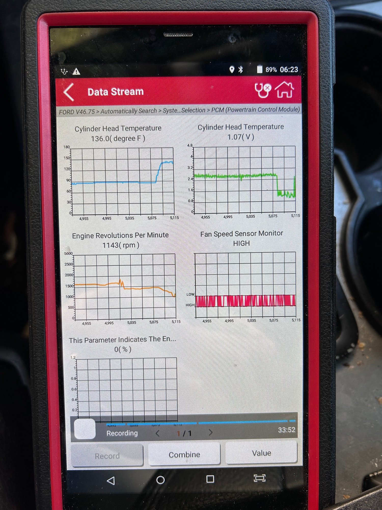

Update: I changed the CHT with a OEM sensor from the deler... no difference. See the photo below. The Voltage and Temp are unstable. The actual temp during this test was 220F. I put my volt meter on the connector entering the PCM and the voltage matches what you see in photo.
What's the possibility of the PCM being the problem?

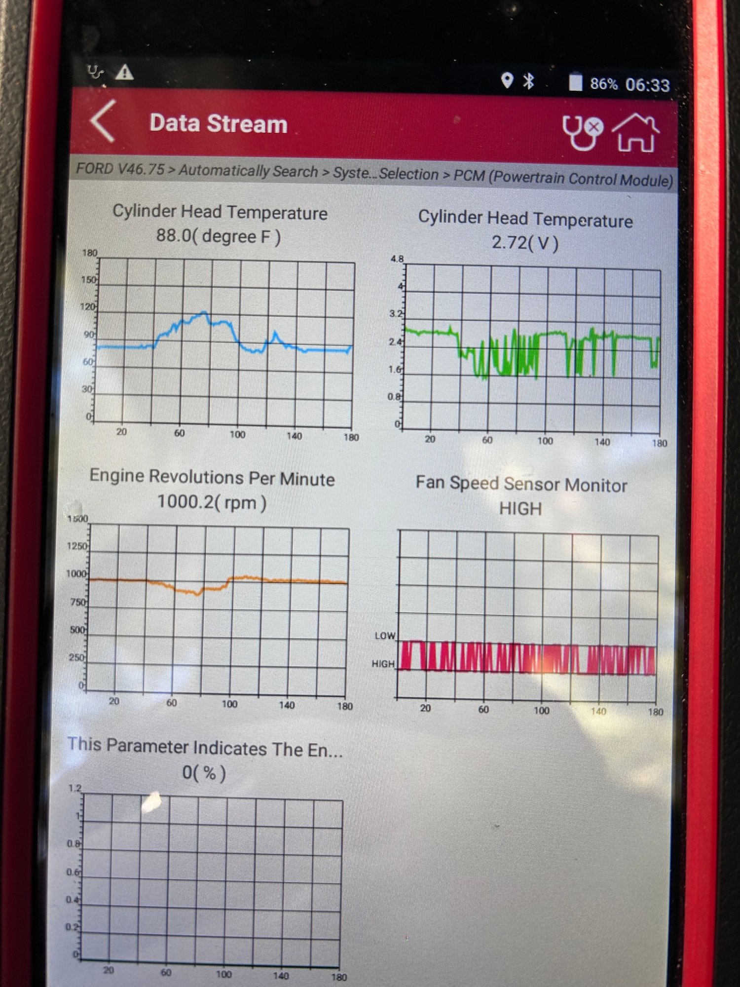

Here's another view

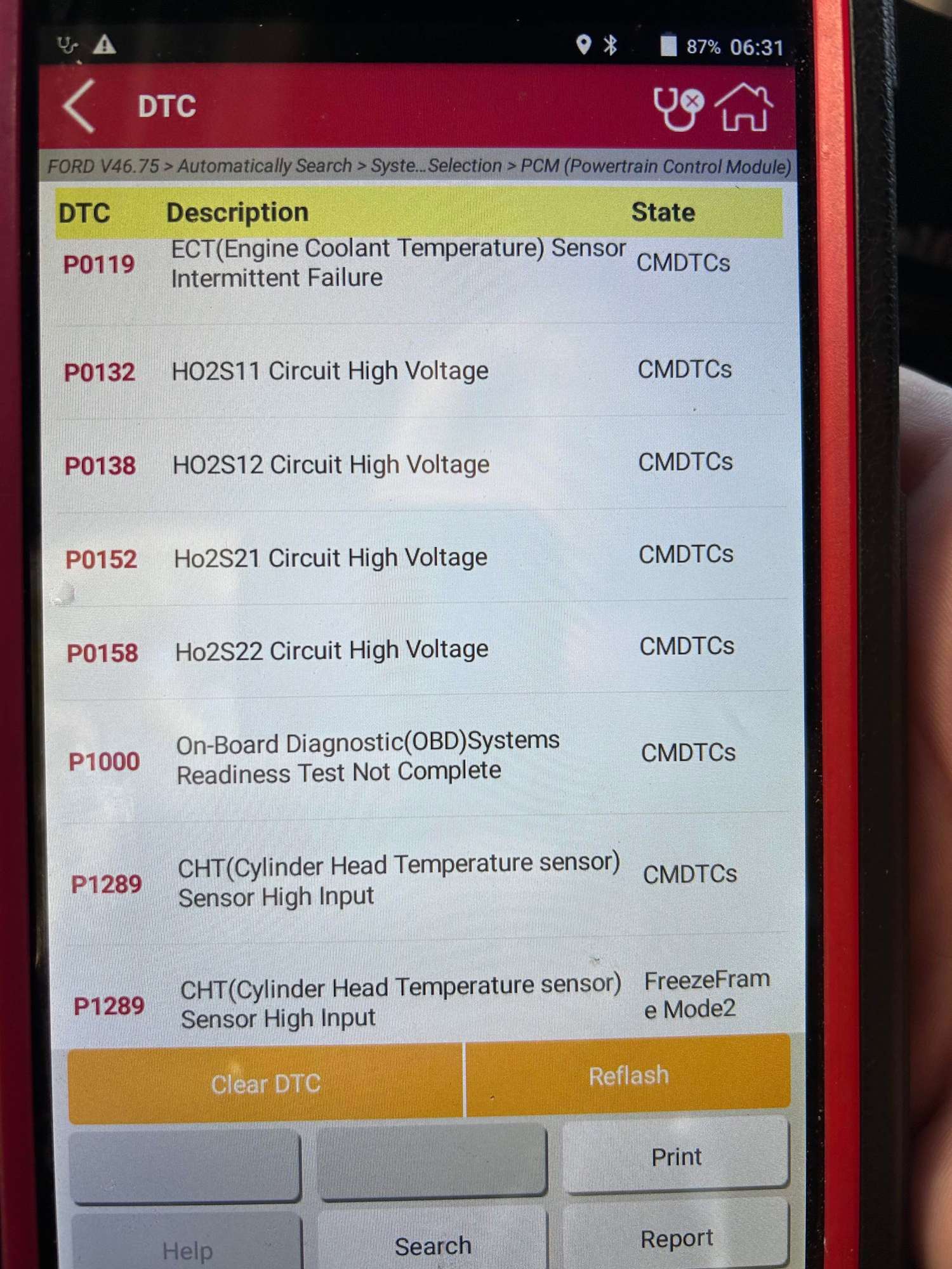

And the codes
