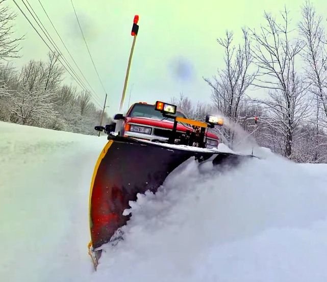

I have a 2005 Western pro plow 8.5" straight blade on mine:
