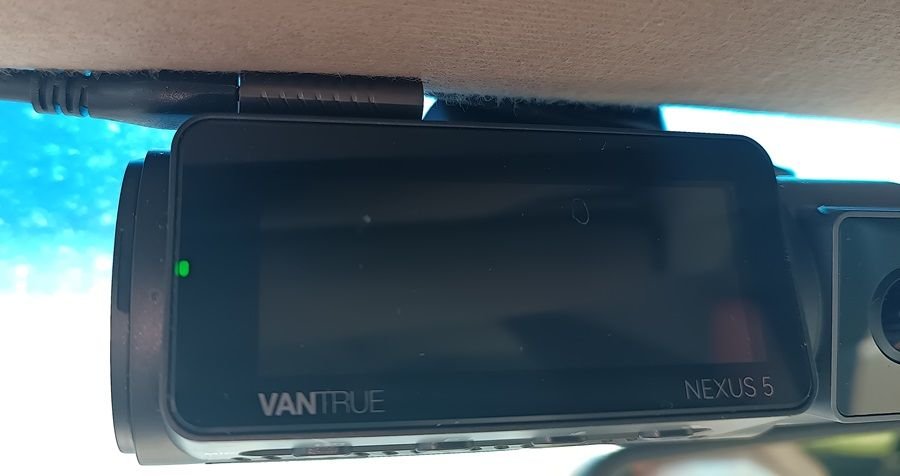

I've been using the Vantrue N5 4 channel since March and I like it ok. Before this I was trying to get by on the cheapest thing I thought would work with limited results.
This unit can make out license plates in most conditions and low light performance I would call "great".
Like most things, it has a few annoying "features" such as a strange need to require location services turned on when connecting to the app...why?
I've only had one firmware update since purchase and it did reset everything to default, so I had to do it all over again.
Audio recording can be disabled.. if you happen to be one who speaks with vibrant color or is used to singing while driving because no one was able to hear me before.....off is good.
G-sensor is very sensitive, I have all of the triggers on the least sensitive settings and can still get it to save the 'incident' of slamming the door.
Parking mode is nearly as sensitive with its motion detection, adjust to taste.
This system gives you 4 cameras in total. A max of 1944p for the main 1440p for the other 3 at 30fps with 2 of them facing inside. At this setting file size is in the 800MB range for a 5 min block in the loop.
Even though the screen is small, I was still able to see when a fuel can tipped over in the cargo area in the split view. I didn't think I would like internal cameras... I'm warming up to it because it saved me from a mess.
I did have to buy a USB-C 90 adapter to clear the headliner for the rear camera cable, and the polarizing filter is a recommended addition for glare reduction.
I wanted it as high as possible to put the FOV down angled close to the nose to see forward of it as much as can be, positioned up out of my way, and keeping the camera in line with the clean area behind the wipers.
This is the best I could manage and not interfere with the rearview mirror. I might have been able to get it a hair more to the right but it works.
I chopped the power cable and ran straight up into the overhead console wiring harness because it was right there. If you opt to use the rear cameras, The cable is long enough for our excursions.
fishing it above the headliner is a chore but doable.
Overall, it is pretty user-friendly and does what it should very well. Above all other considerations, being able to capture license plates was the selling point for me.

I just unboxed this same camera. I really appreciate your details on installation!
I was thinking of using a GoPro, which I already had, but the RAM mount I installed on the dash is cracking the plastic. Your idea is much better than mine, both getting it up high and out of the way.
For mounting, did you use the sticky mounting plates provided? If so, how did you prepare the window surfaces?
Specifically, what Ex wires did you tap into?
Thanks, again.

I did use the adhesive, wiped the glass down with isopropyl alcohol.
I don't want to steer you wrong on the wiring, so I'll dig out the diagram. I might have to peek back in there to be sure.

At the overhead console connector C911
LB/PK hot in run Pin 2
BK ground Pin 3
For constant 12v, I tapped into LG/YE to the dome light; there is also easier ground there.
I would post a pic, but I don't wanna unwrap the tape.
