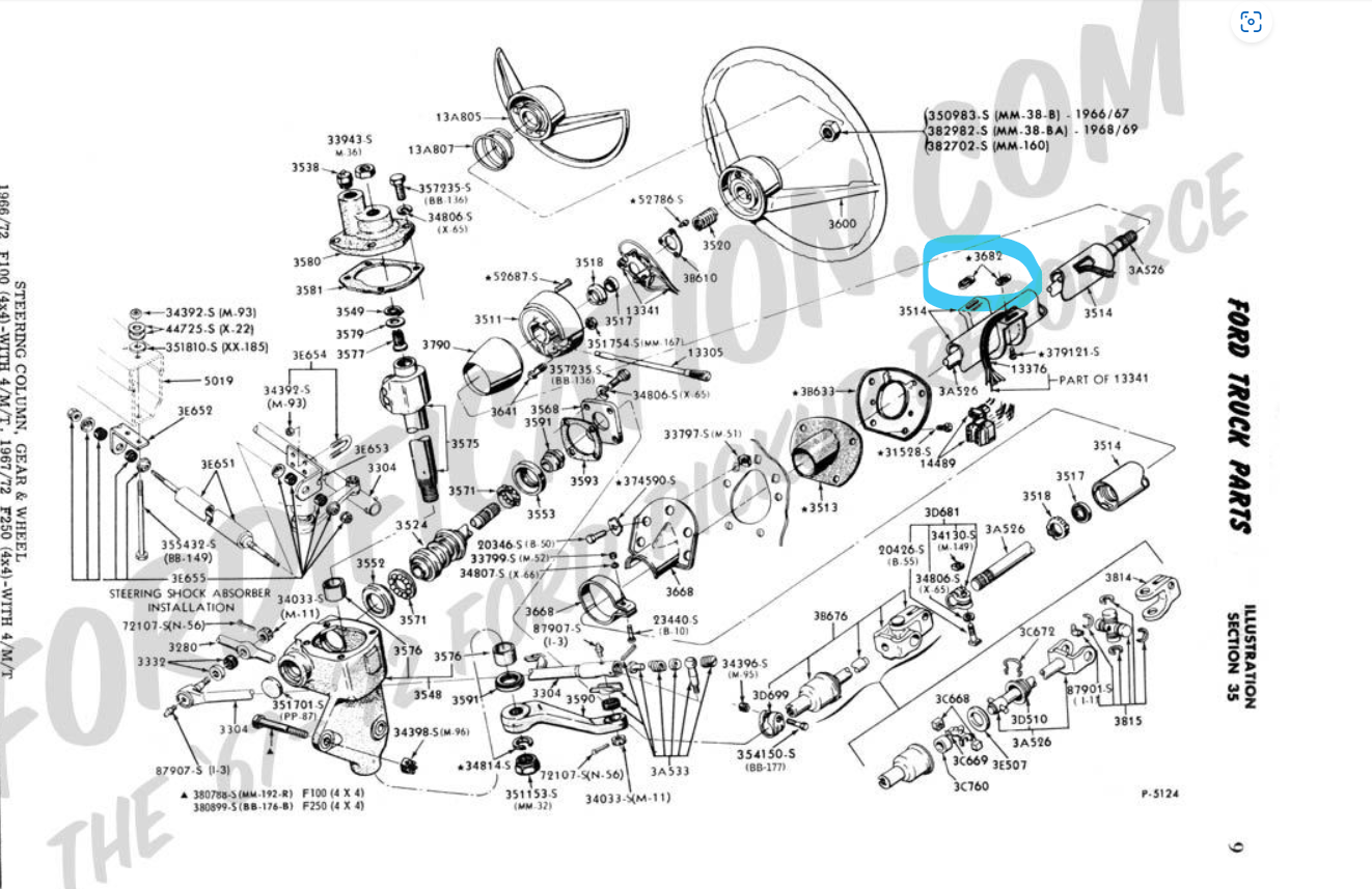

Hey f100 folks,
I am putting my 72 back together and I'm at the point of installing the steering column.
The upper mount to the dash where the painted cover goes seems to need some spacers in order for the painted cover to sit correctly and the column be in line with the steering box.
In the attached pic I have circled in blue the spacers I am in need of OR another method you may have used in there place. Does anyone know the thickness of them?
Thanks in advance for any info you may send my way...

After looking through the Fordification MPC listing which only has 2wd PS column listings, 3682 is not mentioned in there either. As noted in the earlier thread, they have to be improvised if needed:
SYMBOL COMMONLY USED IN THIS CATALOG
* indicates Not Serviced - must be improvised or procured locally
(From the Illustration Catalog Page 1)
