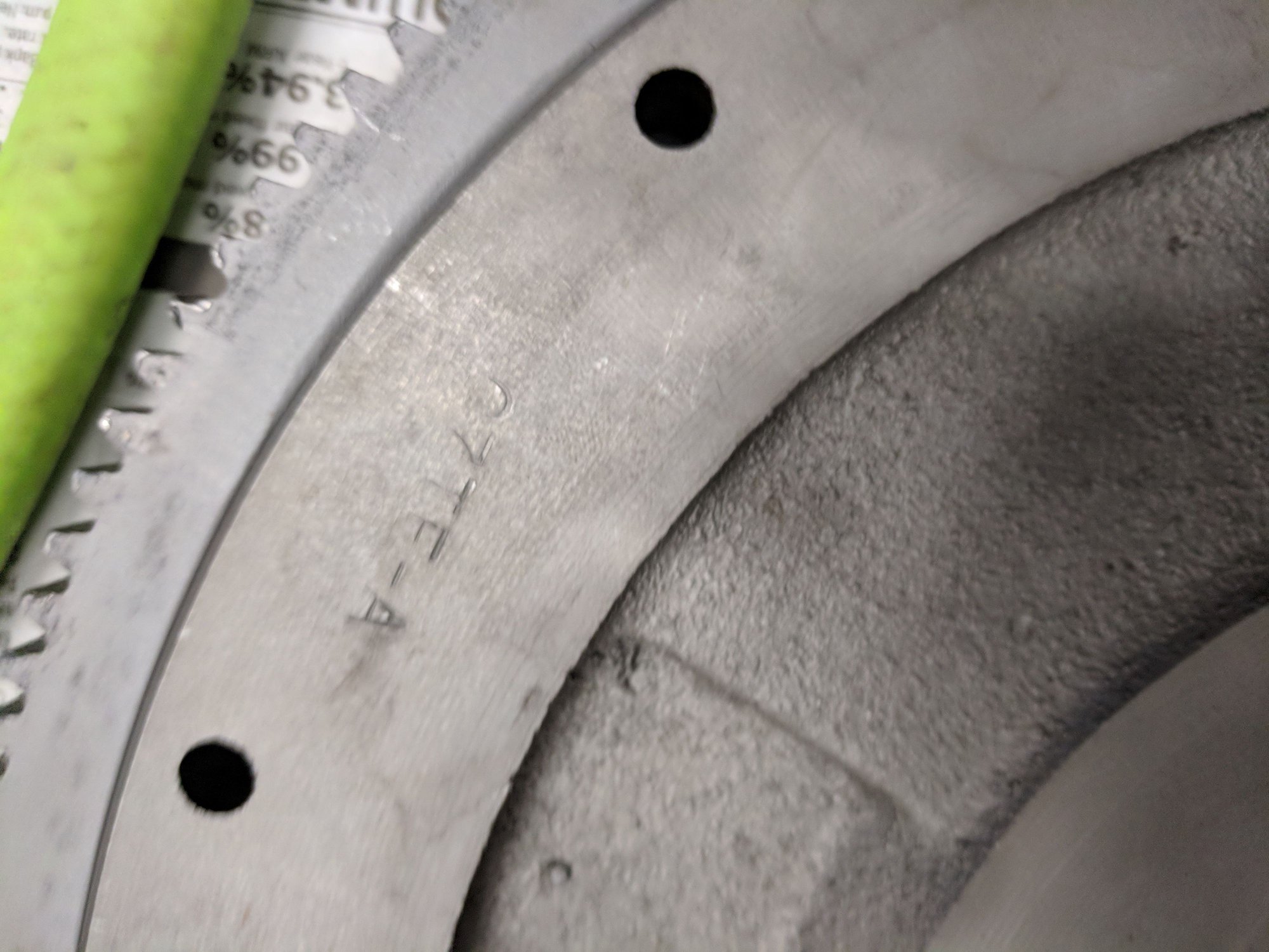

Can this flywheel be identified from these photos? The truck is a 1974 F100. The previous owner installed a 1971 351W with this flywheel. The engine has a subtle vibration around 3500 rpm. I know that the original engine was a 302, and at one point the truck possibly had a six cylinder engine installed. I'm wondering if this flywheel might be from one of the previous engines, and does not have the proper balance for the 351W. If I don't have the proper flywheel, what flywheel would I need with my 11" clutch? And who sells it? After a brief online search, I only found 351W flywheels for smaller clutches.

C7TE-A is the correct flywheel for a 1971 351W.

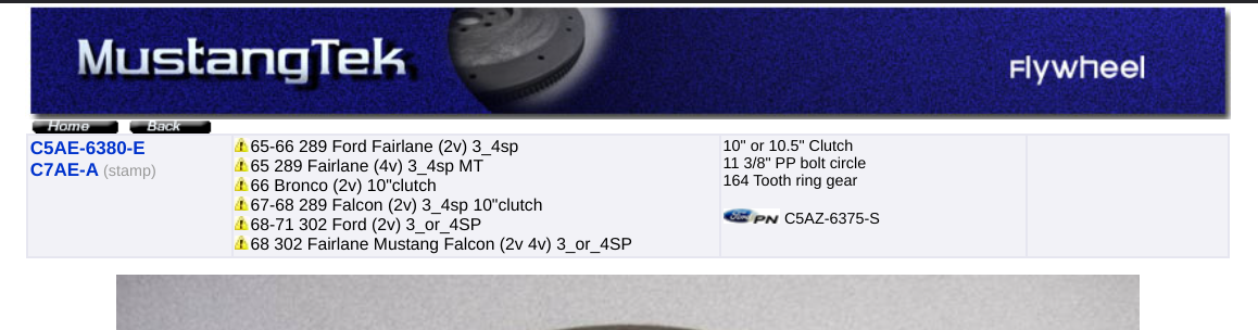

I did a quick search of C5AE-6380-E and found the following.
https://www.mustangtek.com/flywheel/C5AE-6380-E.html
https://www.ford-trucks.com/forums/5...lp-please.html

Thank you Laughing Gas and Mountain Pass. So it looks like I have the correct flywheel. As a follow-up question, am I correct that the casting number C5AE-6380-E would be sort of a generic part number, and then the stamping C7TE-A would indicate what the balancing is? Thanks again.
