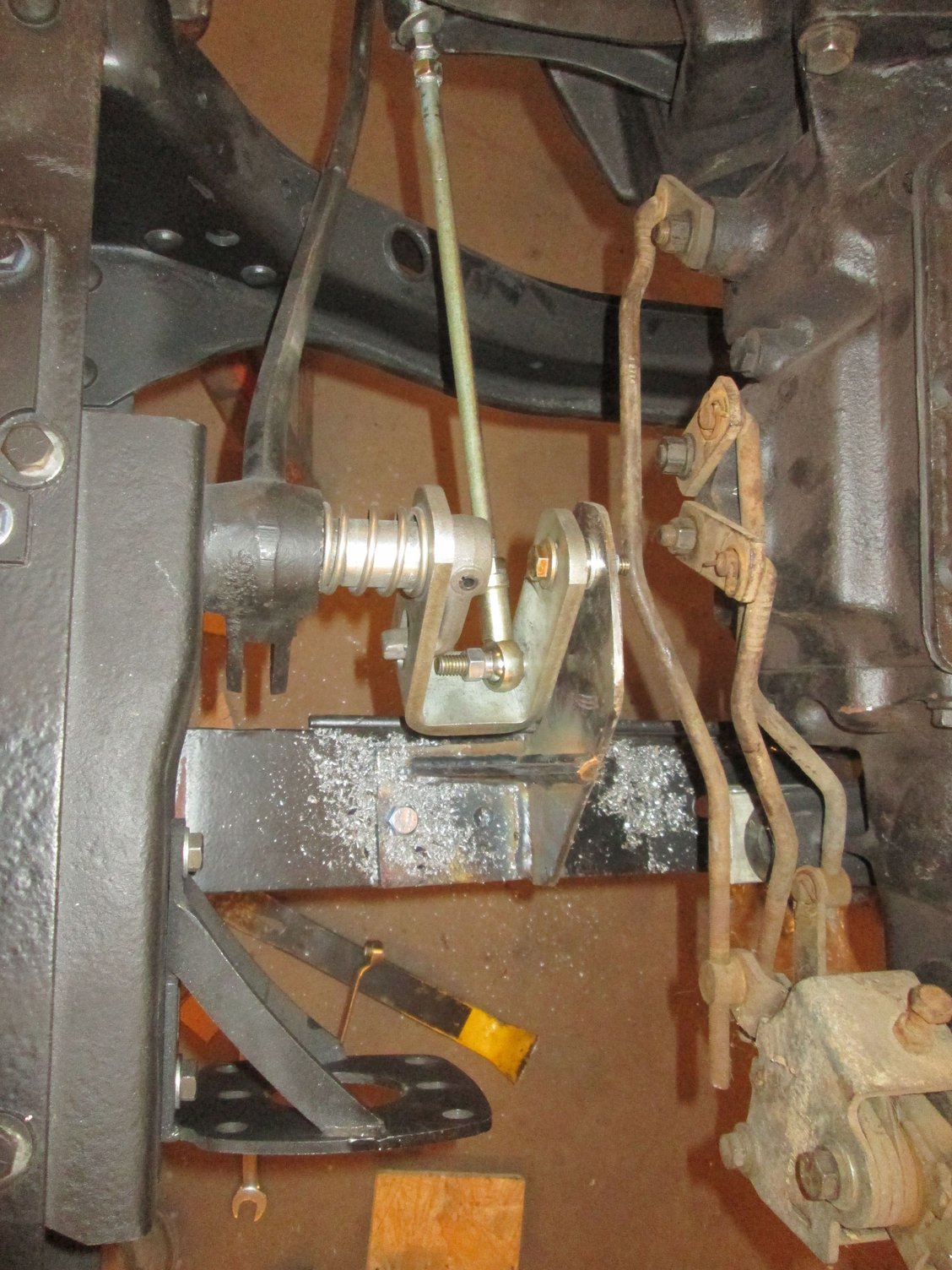

I also have a 390 and toploader, one problem with the toploader is that there is no place for the pivot on the transmission like the stock one, I will attach a picture of how I did mine, it has worked well for the last year and 10,000 miles
