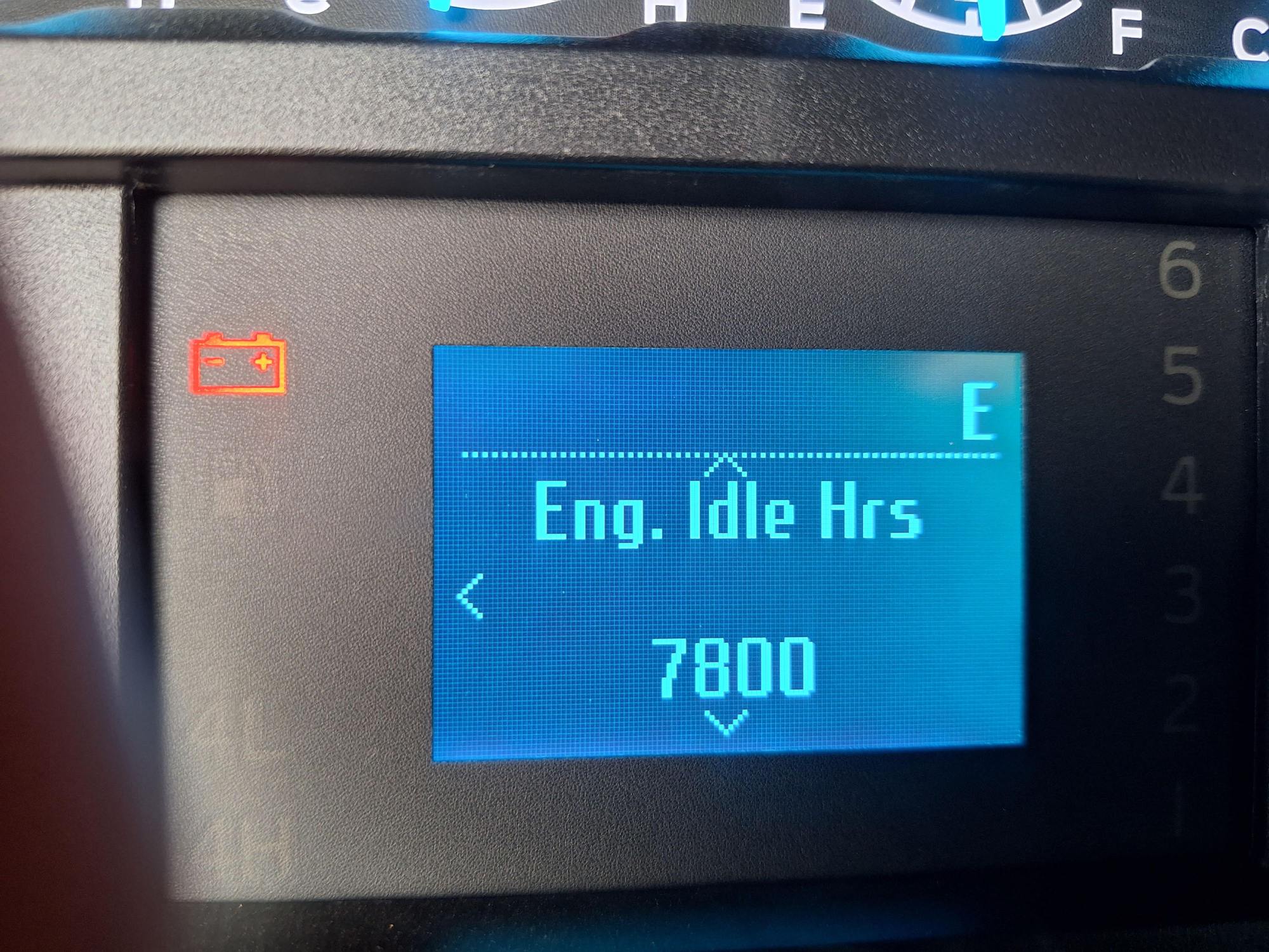

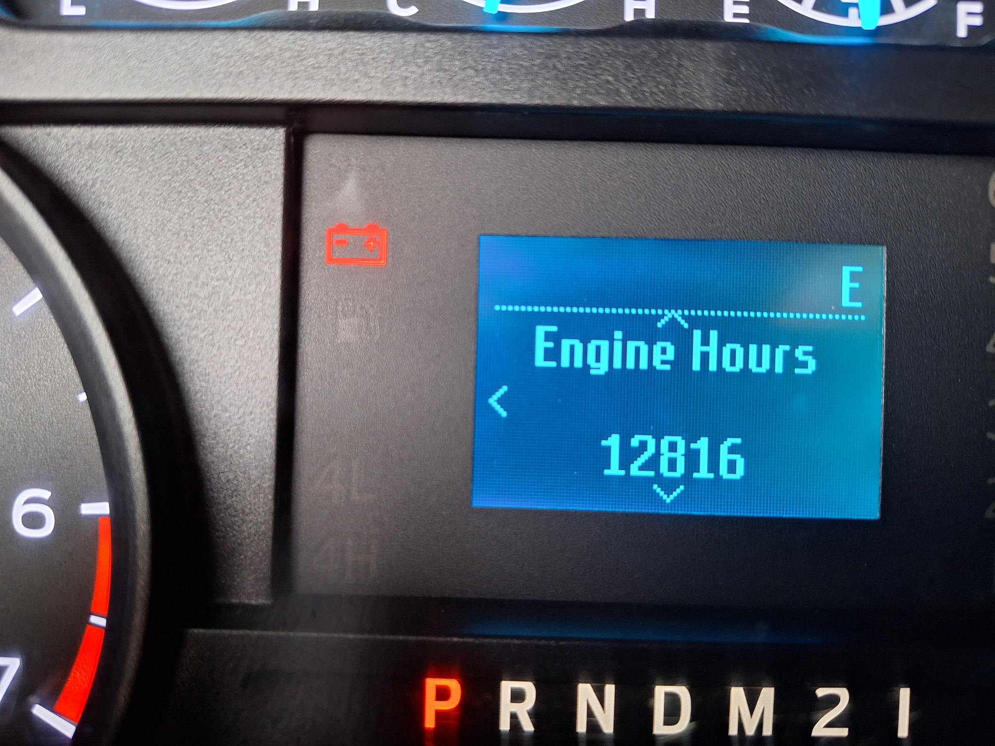

I have put less than 100 miles on the truck and the only thing I had noticed is it has a small exhaust leak between manifold and down pipe. Started it up this morning and it sounded like absolute garbage and the check engine light came on. After fixing OBD 2 port, found random misfire, misfire on 7, and bank 1 catalytic efficiency below threshold. Started playing around with the menus and found out this thing has 13,000k hours, 7800 idle hours(3k oil changes now don't sound that great ha)!!!!! 180k miles.
My questions are: Has anybody seen one with this high of hours? I run a shop of about 30 semi trucks and 60 trailers, we have a few with 4-500k miles with similar hours and they idle a lot! What can I do to find out if it has the original engine? Would you invest time and money trying to get this thing running right with this many hours, or just replace the cats and the engine? If it ends up needing cats, I don't want to put new cats behind a engine that has that many hours.

12,816 total hours, 7800 idle hours, means 5016 driven hours with 180K miles, calculates to 35.8 MPH.
So, it hasn't seen much highway time.\
And, I would be EXTREMELY leary of such a high record of service on a fleet work truck, all done at the dealer.
That would mean they spent considerably more on getting it serviced than the truck cost new.
I'd fix it up as cheap as possible to just get it running well enough to not trip and codes and sell it.
