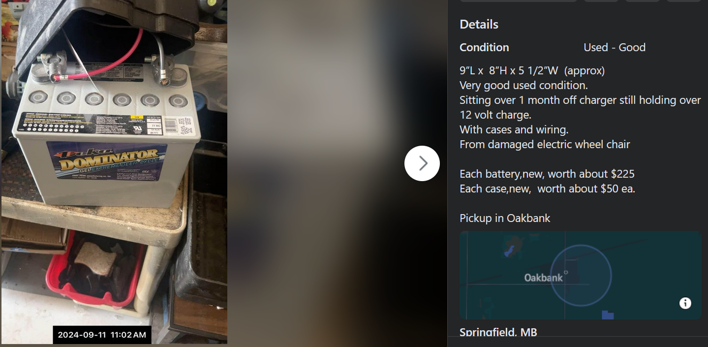

Would this battery setup be any good for my TC? I'd test them first of course and I'd need a 24v to 12v step down, but this would give me 24v/100AH and they're deep cycle AGM's. If the batteries are good that's not a bad deal for $200 right?
Thanks fellas

Those are the same Ahr rating as a lead/acid battery you know that right?
Not sure what you mean by “of course I would need a 24-12v step down”
You would need to hook your camper battery’s in parallel as you probably have a 12v system.
Unless you want ongoing issues with your electrical system, which is the backbone of any RV, camper, trailer etc don’t buy used battery’s.
Purchase whatever you decide new and then you can monitor the status of them from the start and not possibly inherite someone else’s problems in the future.

I thought if the 2-12v batteries were paired together it would be a 24v supply or does it just make it a larger 12v supply?

You want a deep-cycle battery with as many amp-hours as you can afford, just keep in mind that you really should only drain the battery to 50% to extend the overall life so you are only getting half of the amp-hour rating. This does not apply to a lithium though which can be drained down. You will get more amp-hours using 2 6v if you go lead-acid but they are big, heavy and cost.

Hey there amigo to the north just a quick lesson for ya.
Almost all 12vdc lead/ acid battery’s, doesn’t matter if they are deep cycle, rv, or amg type are only rated for 100ahrs.
The chemistry of those battery’s only allow you to discharge them to approximately 50% of their rated capacity, group size doesn’t matter.
So (2) 12v battery’s connected up in parallel, meaning pos to pos and neg to neg will only give you effectively 100ahrs of usage before dropping the voltage level to low to be of use.
Here is where the Lithium battery’s are more advantageous, more expensive but longer lasting ( more charging cycles) and having more capacity. Some have heating circuits built in for freezing temps but that will be an additional amperage draw on top of your regular usage.
Lithium Battery chemistry allows you to discharge these type down to 5-10% of their rating and still provide adequate voltage.
So (2) Lithium battery’s rated for the same 100ahrs each will yield to you approx. 180-190ahrs of usage.
Better still are LifePO4 type battery’s.
I was able to build (2) 280ahr battery’s and connected in parallel give me approx 530ahrs of usage/ storage.
More of an advanced setup but doable for someone with a good understanding of electrical theory and usage.
Depending on your camper setup figure out your load usage on an average day and do the math.
