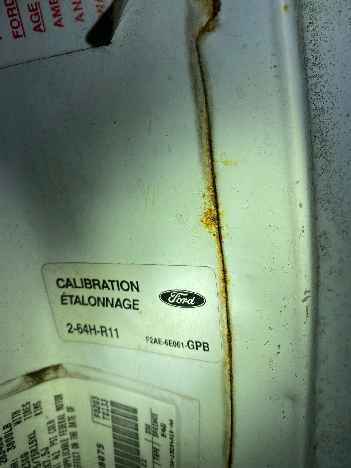

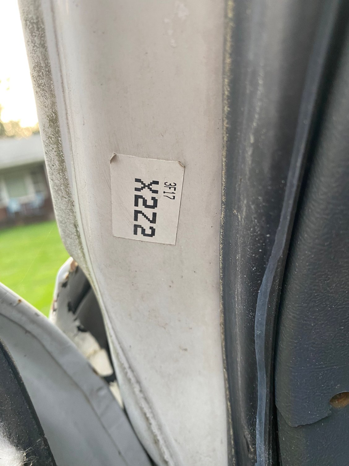

There will also be a sticker on the driver's door windshield pillar. THAT is the one you need to determine ECU/PCM

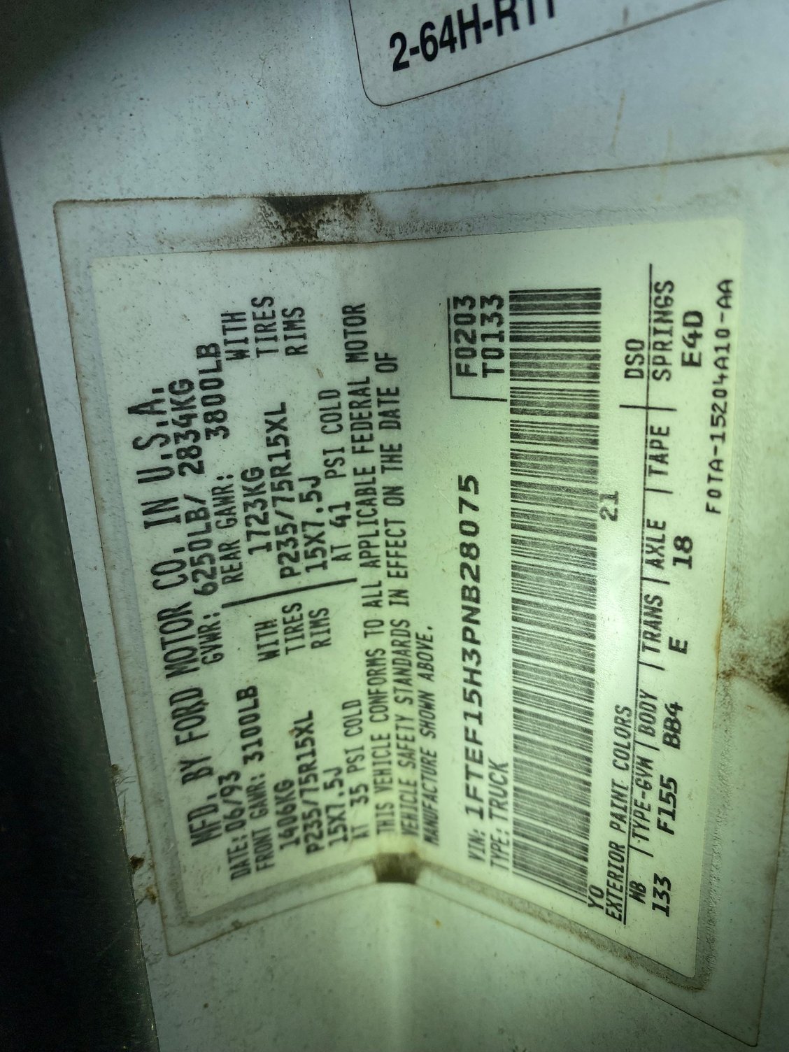

I thought I included the necessary pics? Did they not show up?

ECM sticker
Note that I said WINDSHIELD PILLAR, not door jamb.

Originally Posted by Johnny Chaos
Any SD48B hardware will work.
actual number is F2TF-12A650-MC
Not necessarily true - must be for '93 F150 5.8 with E4OD with Federal emissions, and there are usually several variations of it.
Just looking it up on car-parts (dot) com, there are SEVEN possibilities!
Electronic Control Module, 8-351W (5.8L), AT, E4OD transmission, exc. Lightning; Federal, ID F2TF-CB
Electronic Control Module, 8-351W (5.8L), AT, E4OD transmission, exc. Lightning; Federal, ID F2TF-CC
Electronic Control Module, 8-351W (5.8L), AT, E4OD transmission, exc. Lightning; Federal, ID F2TF-MA
Electronic Control Module, 8-351W (5.8L), AT, E4OD transmission, exc. Lightning; Federal, ID F2TF-MB
Electronic Control Module, 8-351W (5.8L), AT, E4OD transmission, exc. Lightning; Federal, ID F2TF-MC
Electronic Control Module, 8-351W (5.8L), AT, E4OD transmission, exc. Lightning; Federal, ID F2TF-PA
Electronic Control Module, 8-351W (5.8L), AT, E4OD transmission, exc. Lightning; Federal, ID F2TF-PB
Additionally, there are five more with Calif Emissions:
Electronic Control Module, 8-351W (5.8L), AT, E4OD transmission, exc. Lightning; California, ID F2TF-BSA
Electronic Control Module, 8-351W (5.8L), AT, E4OD transmission, exc. Lightning; California, ID F2TF-BSB
Electronic Control Module, 8-351W (5.8L), AT, E4OD transmission, exc. Lightning; California, ID F2TF-DA
Electronic Control Module, 8-351W (5.8L), AT, E4OD transmission, exc. Lightning; California, ID F2TF-DB
Electronic Control Module, 8-351W (5.8L), AT, E4OD transmission, exc. Lightning; California, ID F4TF-NA
As for which one of those is X2Z2, I have no idea...
I posted above which one specifically came with that cab from factory.
All assumptions are that this vehicle is factory stock.
Has the engine been swapped?
Has it had a MAF swap?
If either of the two above, then the code doesn't really matter does it.
Imagine if the E4OD trans had the 1995 solenoid upgrade, then you must have the 1995 or newer EEC because of the diode change. If it has, then you will fry your pre-1994 EEC.
Ebay has them for $400 and up.
Buy it locally probably get it for $50.
Open up the case, fix the capacitors yourself under $10 and some time.
They all are for E4OD, seven of them with federal emissions.
