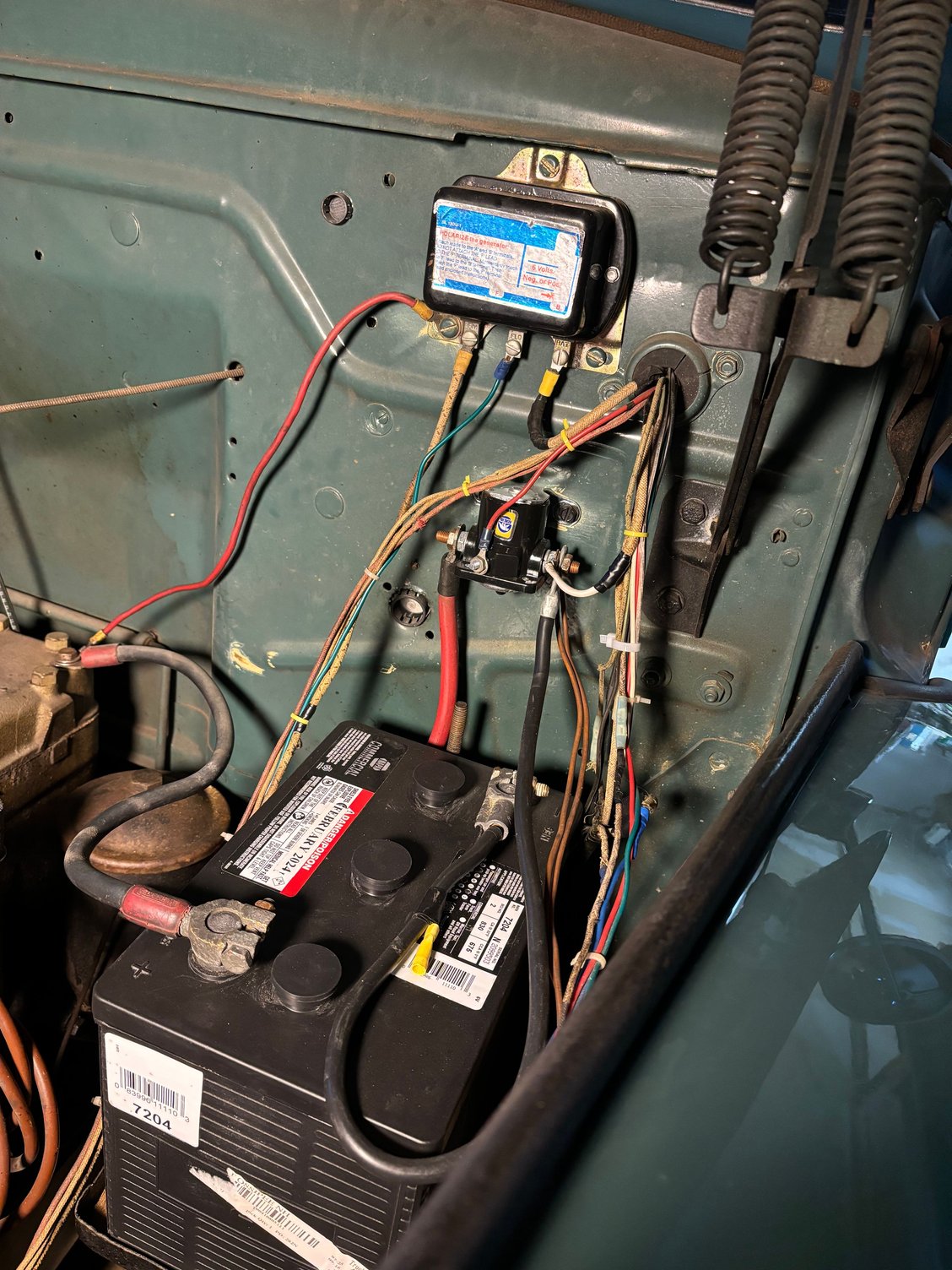

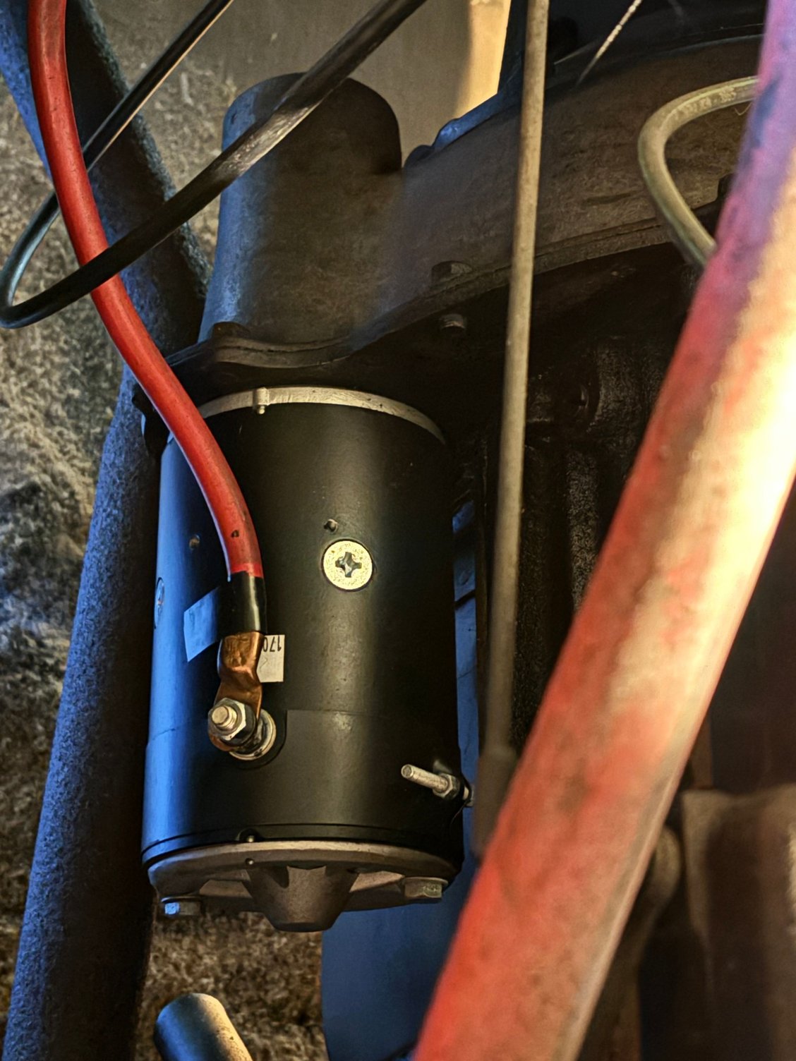

When I replaced the starter this spring , there was no support bracket and Im not sure where it goes.
Are you also referring to the two bots that attach the starter to the engine as being ground points?

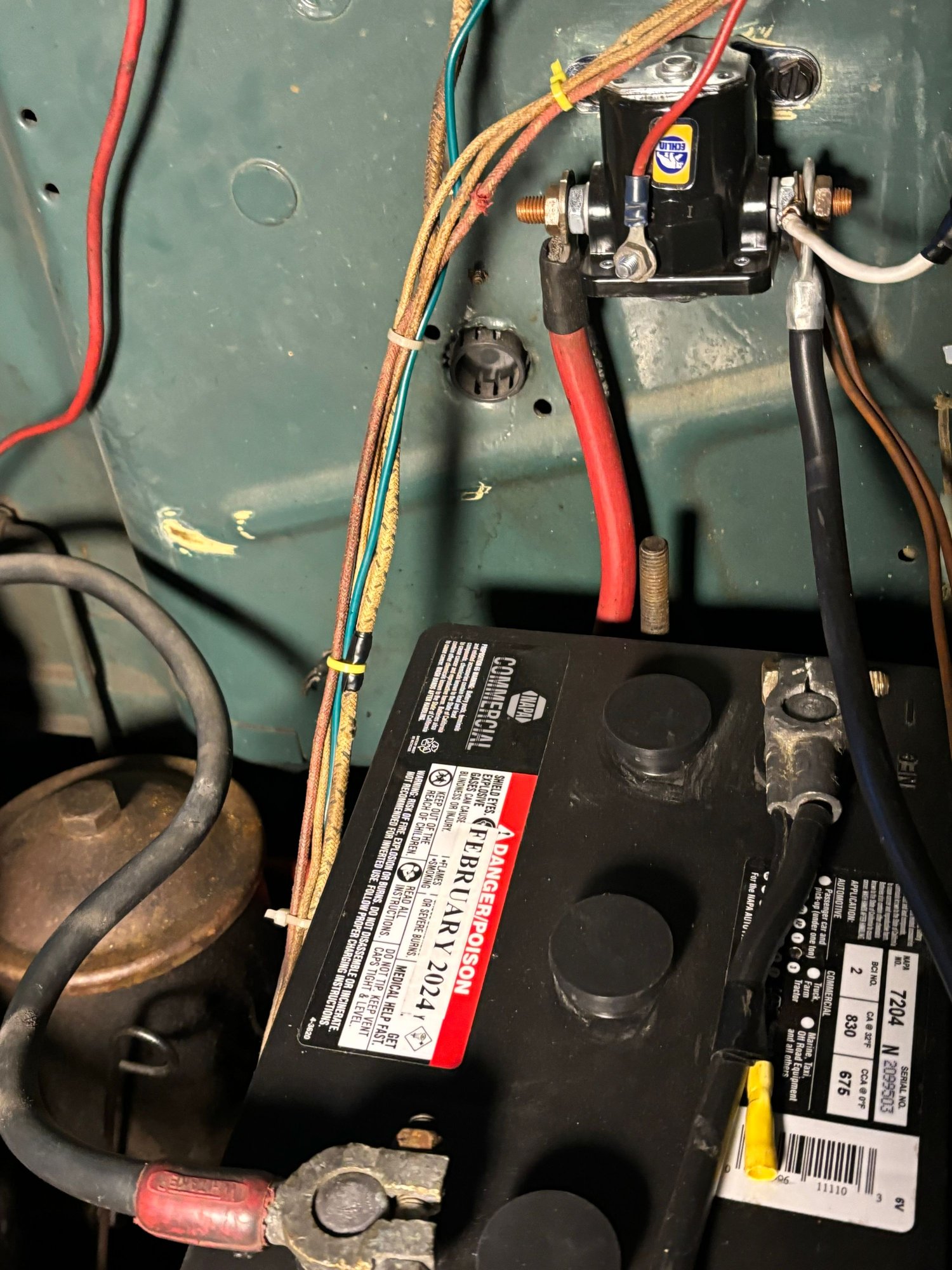

Currently Bothe the cable from negative to solenoid as well as cable from positive [groud] on battery are cables.
I have attached a couple images
New starter installed spring '24
small red wire from engine to mounting screw on regulator is only ground from engine to ruck cab
New battery and solenoid spring 24

My only ground from block to cab is a small maybe #10 wire. Image attached.
My other cables: Are cables Image attached {none braided}
{ I have not detected a ground from engine to frame , but will crawl underneath later today
Ive attached a few images.
I will be in touch in regard to your "other comments"
Thanks again
New battery spring '24
Small red wire grounds from engine block to regulator mounting screw
New solenoid and battery spring '24
Everything well cleaned
The starter button is an interesting thought. As I said the problem is intermittent and generally self corrects [ sounds much like a ground as is being suggested.

1) Your battery cables look small, like Gauge 4 battery cables for 12V applications. You really should have 2/0 (same as 00) battery and starter cables.
2) The ground of the starter goes through the mounting flange faces and the bolts. These need to be clean clean clean. No pain, no oil, grease, corrosion, or dirt. I bet if you remove the starter, the face behind will be that same charcoal color and not a clean natural metal finish.
3) The mounting bracket ( https://www.dennis-carpenter.com/tru...upport-bracket ) goes on the hex head side of the long bolt of the starter closest the oil pan and the corresponding oil pan bolt. These commonly go missing, but are surprisingly helpful.
4) You will want a grounds to the frame and to cab. Here is a good example (may be overkill, but it will WORK):

I'm finding 00 in braided for the engine block to positive terminal , but not 00 for negative to solenoid or solenoid to starter [ only 4]
I don't think I have a ground strap from engine to Frame and will ad one
Also wire from engine to cab is very small so I plan a braided strap there as well. It actually goes from bolt on engine to mounting bracket on Reglator [ maybe it is grounding the regulator.
I anticipate originating all from the same bolt on engine. Is that correct?
