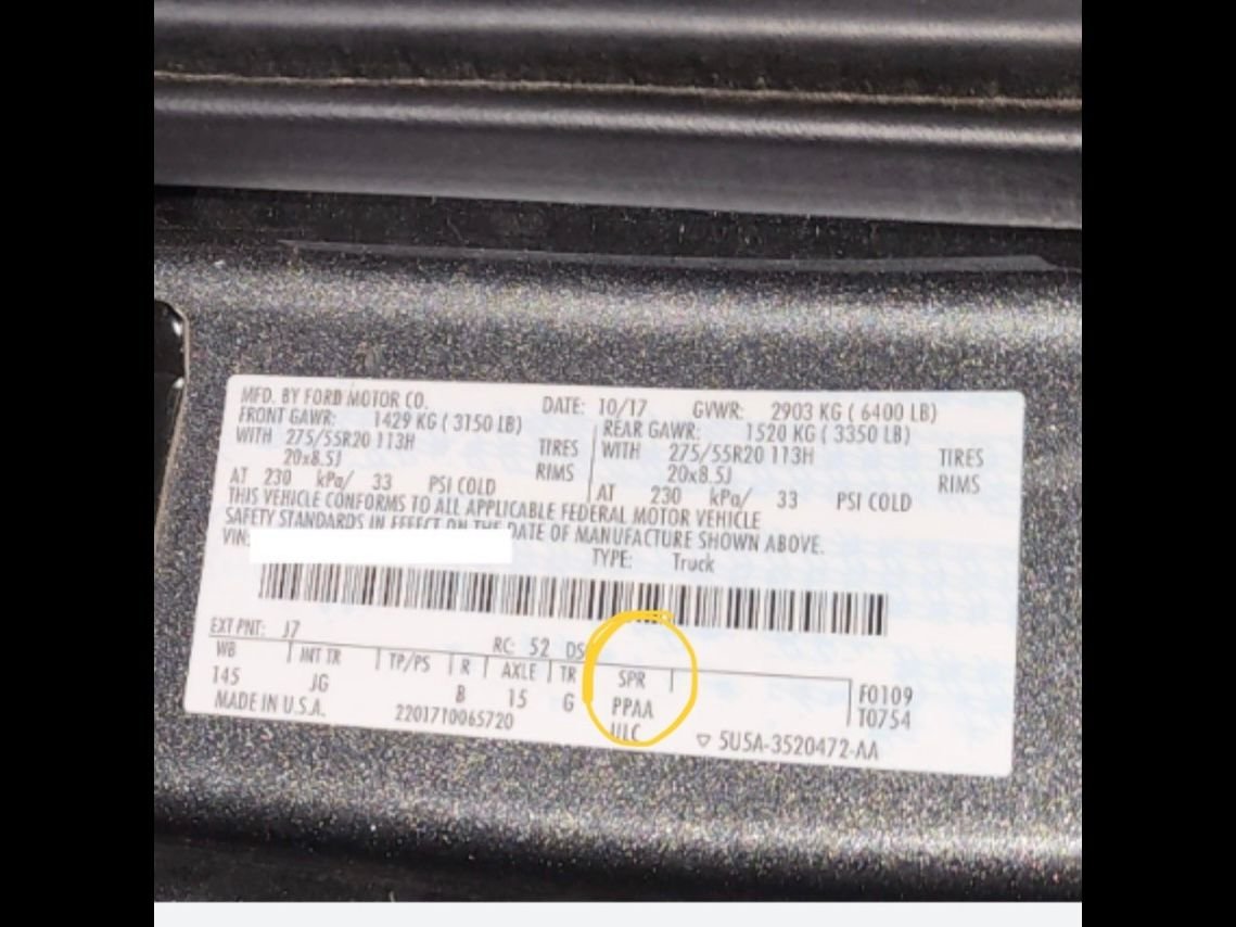

I’d recommend OEM / spicer, or XRF for front end parts (American Undercar sells XRF). Springs, OEM or call ATS or General Springs, and let them know what you do with the truck and ask for their suggestions. Rear depends on how sagged out yours are, and what type of weights you want to carry, vs what yours are now. Best to talk direct to the spring shop for weight options. Have your spring codes on hand when you call, it’s located on the VIN decal. If you’d like help with it, just post up a picture of it (black out the VIN number if you wish) and someone can point it out to you. (See pic below for example - spring code PPAA circled, only an example.)

Example of your spring code on VIN tag / decal.
