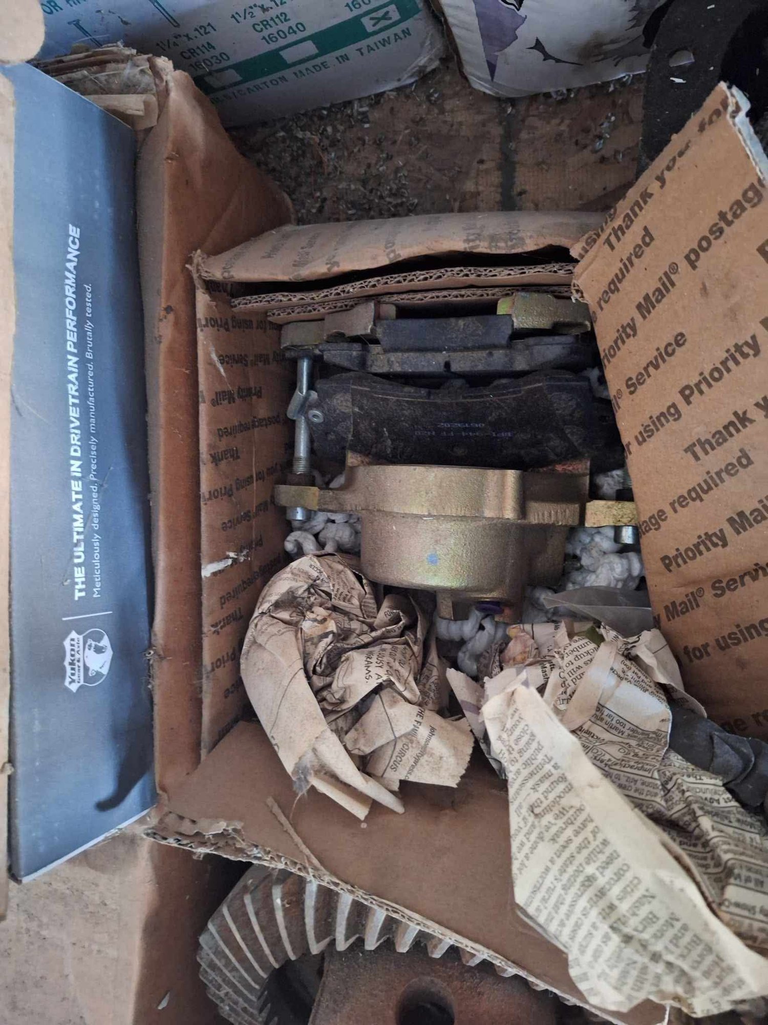

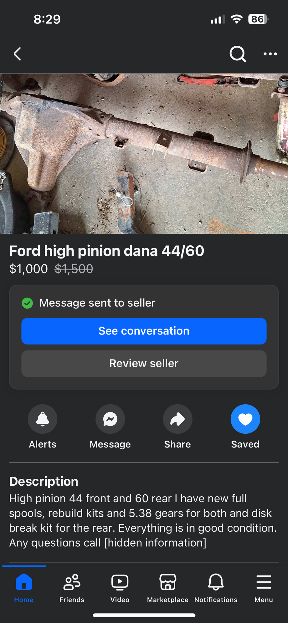

So I found a guy who will sell me the HP 44 and 60 off of a 79' he says, includes disc brakes for the rear and rebuild parts all for $800. See below:
Old Apr 1, 2025 | 09:11 AM
  #70
crowbar's Avatar
crowbar
Joined: Jan 2003
Posts: 53
Likes: 17
From: Phoenix

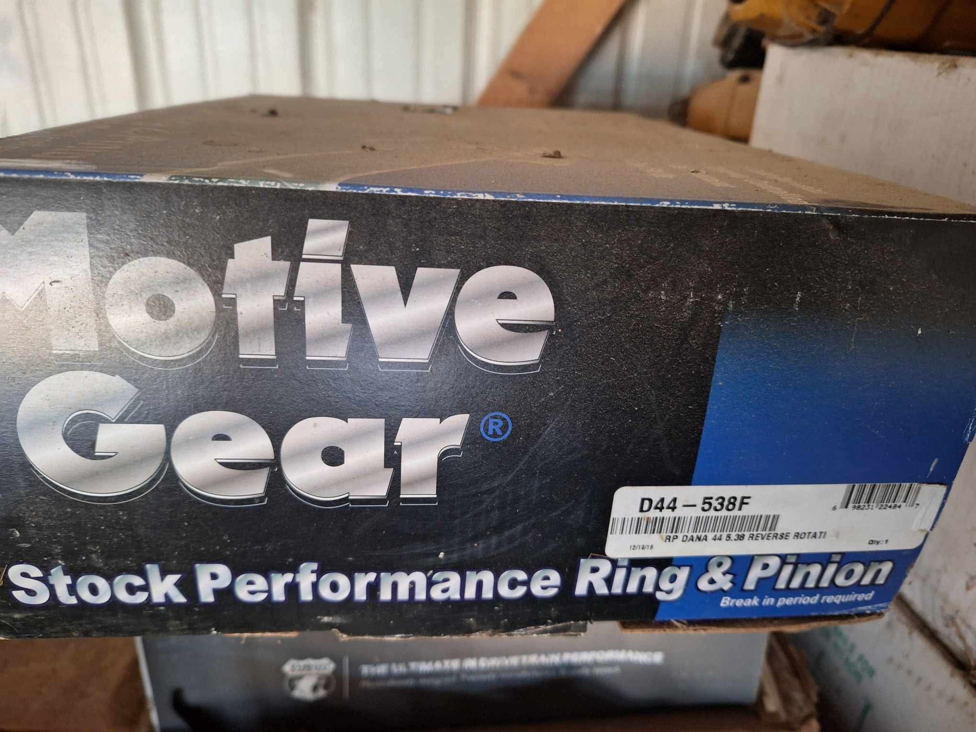

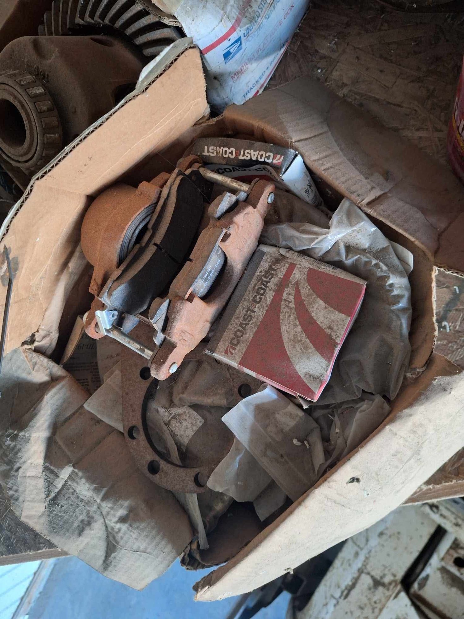

Not a bad deal but they'll need some work. Looks like a new spindle thrown in. Make sure it's got the caliper brackets and ideally the hard to get dust/backing plates. That gearset is too low for most. I'd like it for my Bronco on 37" tires but stick to 4.10/4.09 in the '71 F-250. If the new gears are not installed you could sell that and go with whatever gears you want. There will be a bigger shop cost than acquisition cost if your not doing this work yourself. Your original closed knuckle axle is probably needing a rebuild anyways.
Old Apr 1, 2025 | 09:19 AM
  #71
DHDeichmann's Avatar
DHDeichmann
Joined: Jun 2024
Posts: 176
Likes: 60
From: Indiana
yeah, existing axles would have gotten rebuilt anyway. I probably will go with the 4.10 since I’m leaning towards 35” tires. I’ll sell the old axles and have these sandblasted and rebuilt.

I think that's a great deal. You can sell off the gears and spools as you wont want them and recoup some costs. Then go through both axles and replace the wear items, seals, ball joints and most likely bearings.
That’s a deal I would take.
