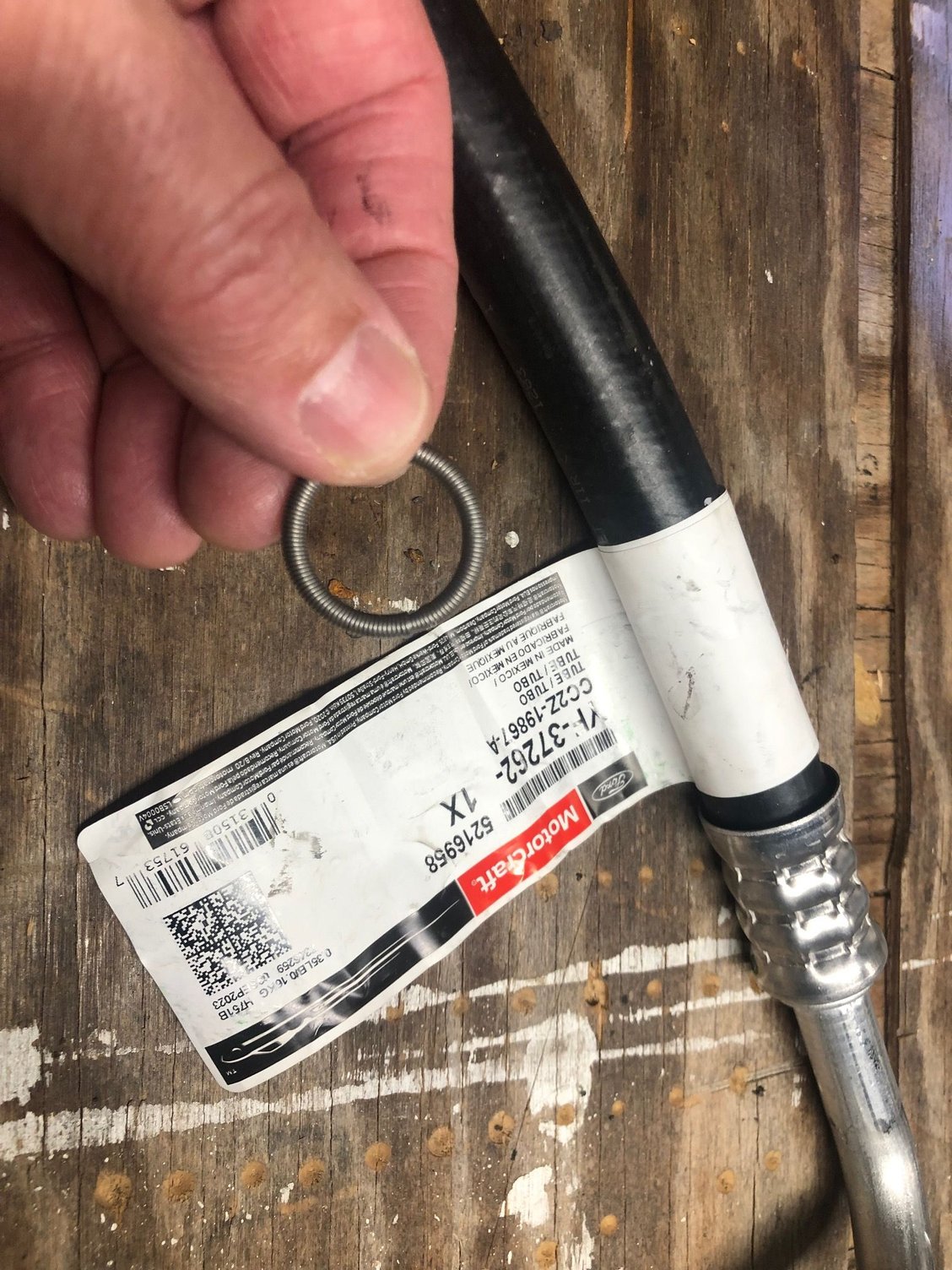

Hi everyone, the low pressure line on our 2000 E-350 is giving up the ghost- the line is fine, the crimp to the line has cracked, but anyway-
Ordered a new line from Rock Auto, all looks good except a small circular spring was in the box, loose. It's not tagged in any way, was not in a baggie of any sort, just in there loose. Can anyone tell me where this goes? I looks like it fits on the bigger end, but I don't want to assume.
Here is a pic of the spring in question, and my thanks as always,
Ben
AC Spring in question, is it needed?

You can just put that "garter" spring back in the fitting, if it fell out
Might just be an extra? That is, if the garter spring is in the fitting
It goes past the o rings in the little metal collar

Thanks and will do. I doubt it fell out, that end of the line has a plastic cover on it. Well, both ends have plastic covers.
Thank you!
