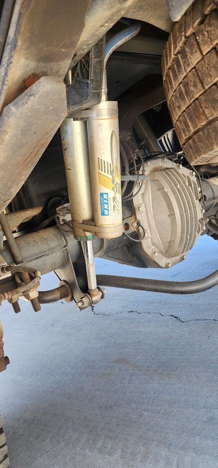

So Anderson ford pointed out to me that my suspension is aftermarket, and they claim it is top of the line. Anyone here know about what i got and if it effects my tow rating?

Remote reservoir shocks, but really doesn't tell exactly what the rest of the suspension setup is, the front springs have definitely been replaced though.
I can tell you though, if you're serious about putting a truck to work, you would be much better off with a stock untouched truck, mods like that are not the hot ticket for towing/hauling.

Carli is the most expensive and highest quality lift/suspension that I know of. Huge upgrade over stock. Big money.
Look at this page yours is probably one of these.https://www.cjcoffroad.com/collectio...ension-systems

Should I get any other pictures to help identify what I have there? All I know is the dealership said Carli is top of the line, but that's all I got.
I was worried about that after they pointed it out. I figure, if anything, I will have a lower towing capacity with this set up, so I may need to have it reverted to stock

I don't think the Carli coil springs change the load capacity, some of their full leaf packs do. It doesn't appear that you have replacement leaf springs though. The shocks look to be their "Pintop" shock, how is the ride? I ask because I've read that their pintop shocks can make the ride firm in daily use, too firm for some owners. They are made to perform well at speed offroad. I guess you could say, their best shock for aggressive offroad driving.
